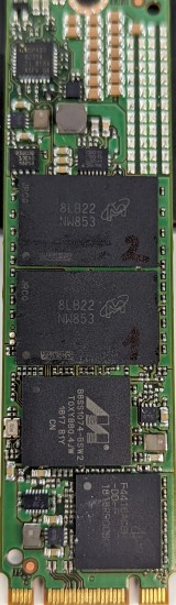

 Post subject: Micron 256GB SSD
PostPosted: July 28th, 2022, 18:53
Posts: 413
Hey guys,
So this SSD came to me with a full ID, giving the smart error on pc3k universal utility. This is a Marvell 88SS1074 but since it's a Micron SSD (not a sandisk or wd) I can't load a new translator to access the data. I had a donor SSD with me so I tried to swap the nands, however (obviously I don't even know why I wasted my time) the result is the same.
I can't identify where the terminal connections are also, but i'll be working on that tomorrow.
Do any of you guys have a custom solution for this model?
PXL_20220728_170047191~2.jpg [ 996.02 KiB | Viewed 11826 times ]
 Post subject: Re: Micron 256GB SSD
PostPosted: July 29th, 2022, 4:14
Posts: 922
If problem is with FW, swaps doesn't make sense.
 Post subject: Re: Micron 256GB SSD
PostPosted: July 29th, 2022, 16:07
Joined: February 18th, 2020, 9:35
Posts: 77
Location: Ukraina
In the processor, the encryption key, nand cannot be transferred.
 Post subject: Re: Micron 256GB SSD
PostPosted: July 30th, 2022, 20:17
Posts: 413
gold6565 wrote:
In the processor, the encryption key, nand cannot be transferred.
Yes it can. Key is not unique.
 Post subject: Re: Micron 256GB SSD
PostPosted: August 1st, 2022, 10:30
Joined: February 18th, 2020, 9:35
Posts: 77
Location: Ukraina
DRUG wrote:
gold6565 wrote:
In the processor, the encryption key, nand cannot be transferred.
Yes it can. Key is not unique.
Connect the terminal and take a look. (the transient resistors from the terminal pads to the processor, replace with jumpers)
 Post subject: Re: Micron 256GB SSD
PostPosted: August 1st, 2022, 15:49
Posts: 413
gold6565 wrote:
DRUG wrote:
gold6565 wrote:
In the processor, the encryption key, nand cannot be transferred.
Yes it can. Key is not unique.
Connect the terminal and take a look. (the transient resistors from the terminal pads to the processor, replace with jumpers)
Can you highlight where both things are? I'm having a but of trouble with the terminal. I think it should those pads near the bottom but no matter wires i switch i see no output.
 Post subject: Re: Micron 256GB SSD
PostPosted: August 4th, 2022, 20:22
Posts: 413
Case solved.
 Post subject: Re: Micron 256GB SSD
PostPosted: August 5th, 2022, 3:24
Posts: 1318
DRUG wrote:
Case solved.
Care to share the solution with the rest of the class ?
 Post subject: Re: Micron 256GB SSD
PostPosted: August 21st, 2022, 5:15
Joined: May 16th, 2022, 20:42
Posts: 5
Location: France
Hi !
I have same M600 Micron.
Mine produce hiss / high hearable noise when connected and cant be seen inside windows disk mgr.
I would be very interested to know how to access to it and try to push a new FW (recover data is not my goal, only to revive it).
Thank to all !
And i will share something if i can revive it :)
Users browsing this forum: No registered users and 133 guests
