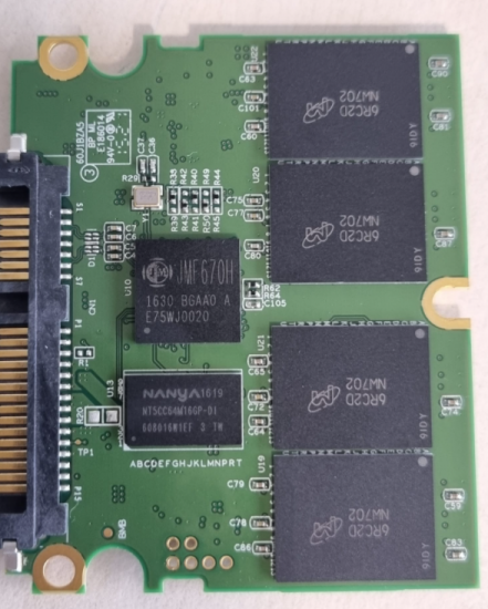

I got this SSD 128 GB. Was in a Mac Pro tower.
It stay BSY. I can get to ROM mode and I get ID but it's not supported by PC-3000.
Has anyone used JMicron utility to fix such issue ?

Please show a photo of controller.

sure, here you go.

If my memory serves me right, this can be done via chip off.

FE appears to confirm http://www.flash-extractor.com/library/JMF/JMF670/

This is one of the select few that can be done via chip-off.
However I feel those nands will be a pain to correct.
What is the terminal output?
Micron chips usually it is not hard to correct.

Chip-off unless there was an encryption. Customer is not sure...
