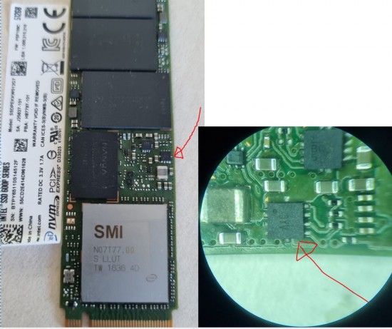

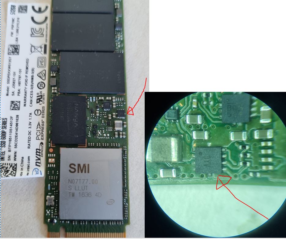

This drive got an electrical shot after customer connected wrong power supply. it's take 1.13 amp and get really hot, I can identify faulty part, is this a Mosfet ?
looking for same part to replace it.

http://www.users.on.net/~fzabkar/ssd_flash_ics.txt
Can you not tilt it and read the markings? What are the voltages on the pins?
 Post subject: Re: Intel 600P short, what's this part.
PostPosted: September 22nd, 2022, 13:58
Posts: 17134
This thread has part IDs and voltages:
https://forum.hddguru.com/viewtopic.php?f=10&t=40472&start=20
RT8086B, Richtek, Synchronous Step-Down Converter, 3.5A, 1.2MHz, 2.8V - 5.5Vin, marking 0Yx, UQFN-12L:
http://chip.tomsk.ru/chip/chipfile0-x.nsf/all/34D15D8C9E31816246257F80005444F2/$File/DS8086B-02.pdf
https://www.richtek.com/assets/product_file/RT8086B/DS8086B-01.pdf
I would test for shorts at the output of each DC-DC converter, ie between each inductor and ground.

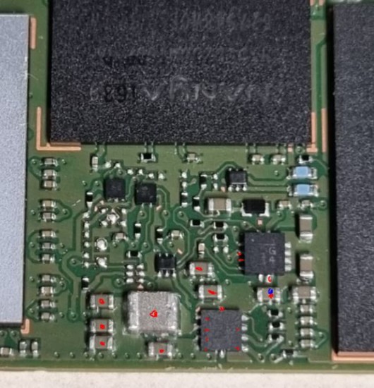

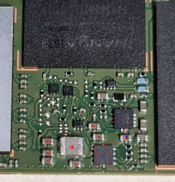

there's several component to gnd here (both pads), all in red. I was thinking the Cap in blue could be the root but DC-DC is clearly heating quickly.

It's easy enough to pull the ic and see if the shorts disappear.
