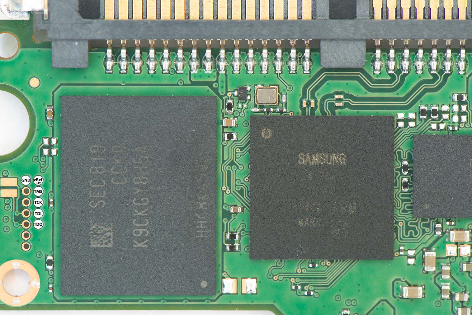

Hello, I’m trying to get my hands dirty debugging ARM based SSD’s through the JTAG port for some reverse engineering & data recovery fun. I’ve read a few articles showing its possible.
https://wrongbaud.github.io/posts/jtag-hdd/
https://github.com/derco0n/SSDdiag
http://www2.futureware.at/~philipp/ssd/ ... Manual.pdf <-- Good Info on Samsung 840 EVO
https://www.fmad.io/blog/ssd-bricked-restore
I’ve managed some success with PS3112’s via SWD, downloading the contents of memory and disassembling it using IDA Pro and modifying IP's but right now I’m focusing on a Samsung 860 EVO trying to do the same.
There's an old Samsung 840 EVO OpenOCD config file here although it uses the old format and doesn't appear to be applicable to the 860
This is my OpenOCD file

I suspect my configuration file is incorrect as I can't halt the CPU due to examination failing. Any suggestions? I'm hoping one of the UBER geniuses here can help. Any ideas, I'm stuck. Any help is appreciated.
File comment: JTAG Information seems the same as
http://www2.futureware.at/~philipp/ssd/TheMissingManual.pdf

I would say the issue is that you are assuming that the CPU has X cores active instead of Y.
Usually if CPU has some kind of issue or being debugged it uses 1 core only, instead of 4.
You can try to manipulate the cpu using something like a chipwhisperer.

Unless I'm misunderstanding my OpenOCD config, it only accounts for the one device/CPU showing up on tap discovery.
thesourcerer8's EVO 840 script accounts for 3 CPU's.
I'm not sure what you mean, I'm already using a debugging adapter that works with OpenOCD

May be worth trying a lower interface speed for your JTAG connection even down to 8mhz.
I also noticed that "Target voltage: 1.79 V"
I'm ignorant about the working parameters of these controllers but very often RE and debug other MCUs, typical nominal working voltage is 3.3 and Core is 1.8.
How are you powering the controller as you are trying to connect via JTAG? Might be worth double checking those conmections.
