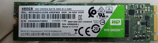

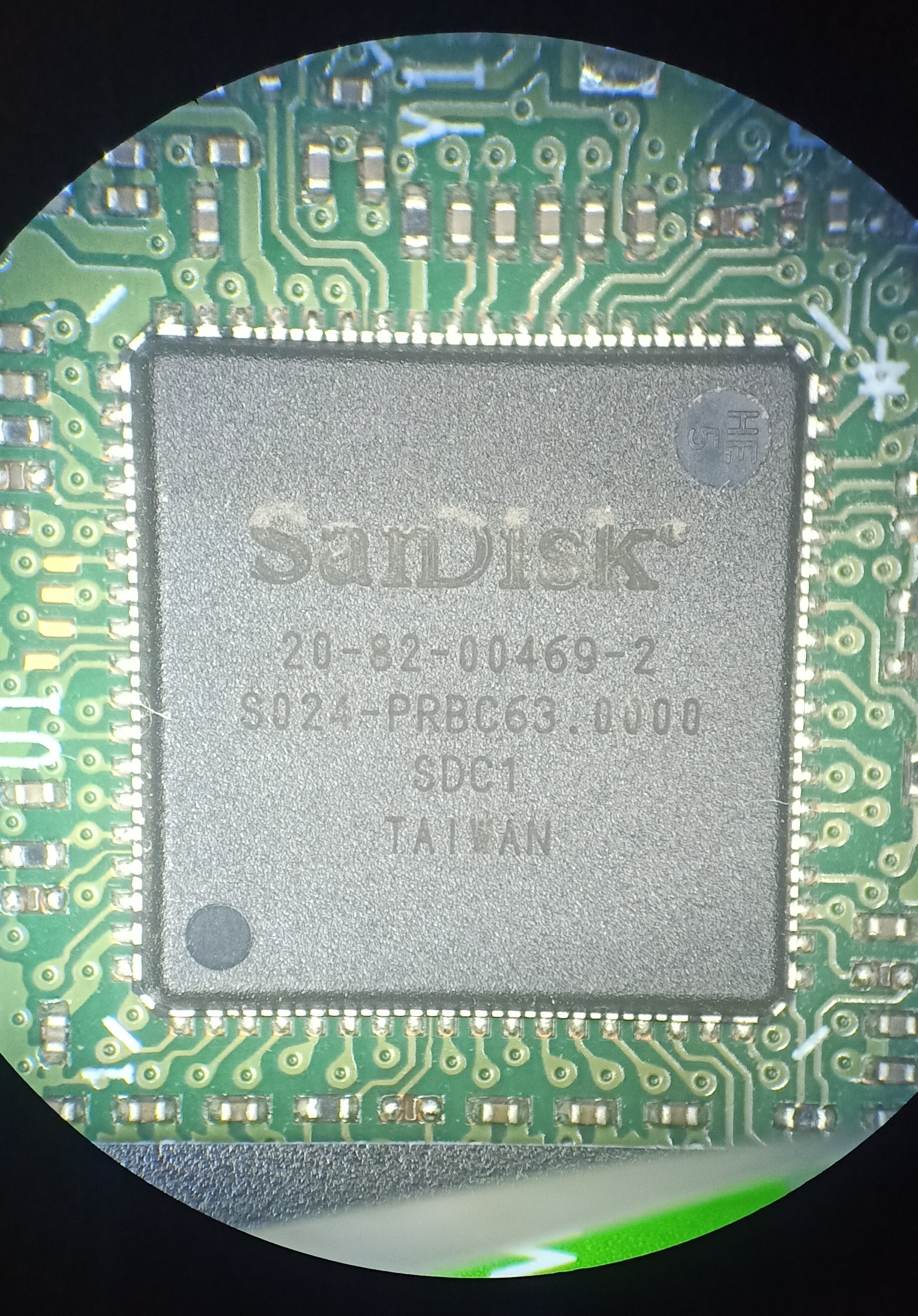

I Have a case with WD 480GB SSD Green M.2 Interface With Sandisk 20-82-00469-2 Controller .My Google Search Tells me this controller does not encrypt the Data in NAND and a chipoff should be supported in My Tools PC3K Flash and VNR " .I also see that its supported in Softcenter FE which i do not have .Does PC3K SSD Tool Support this SSD and Its Controller .I am attaching some images for everyone reference .
PS : I still have to check the behavior of this SSD ,Just received It yesterday

FE and VNR support it. PC3K probably not at current day.

No support under pc3k SSD not sure about pc3k flash though.
There's a list of currently supported devices on Aces website https://blog.acelab.eu.com/pc-3000-ssd- ... dated.html
