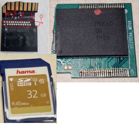

Customer broke SD Card.
Anyone knows if it's possible to solder on round pad instead of soldering 48 pads ?
Or chip-off but I am not sure which package it this

Are these of any use?
http://flash-extractor.com/library/SM/STC2703/STC2703AA__2c_a4_e5_3c__1x4
https://m.facebook.com/arvikadatarecovery/photos/a.865655453480457/3772952279417412/?type=3
http://pc3000flash.com/solbase/solution.php?task_id=7935&lang=eng

Thank you. I did Chip-off, for my case it's BGA152
