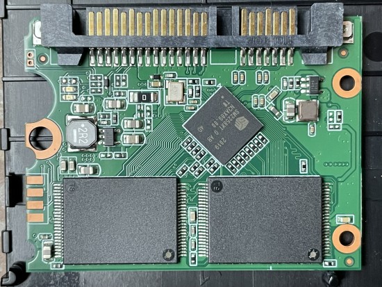

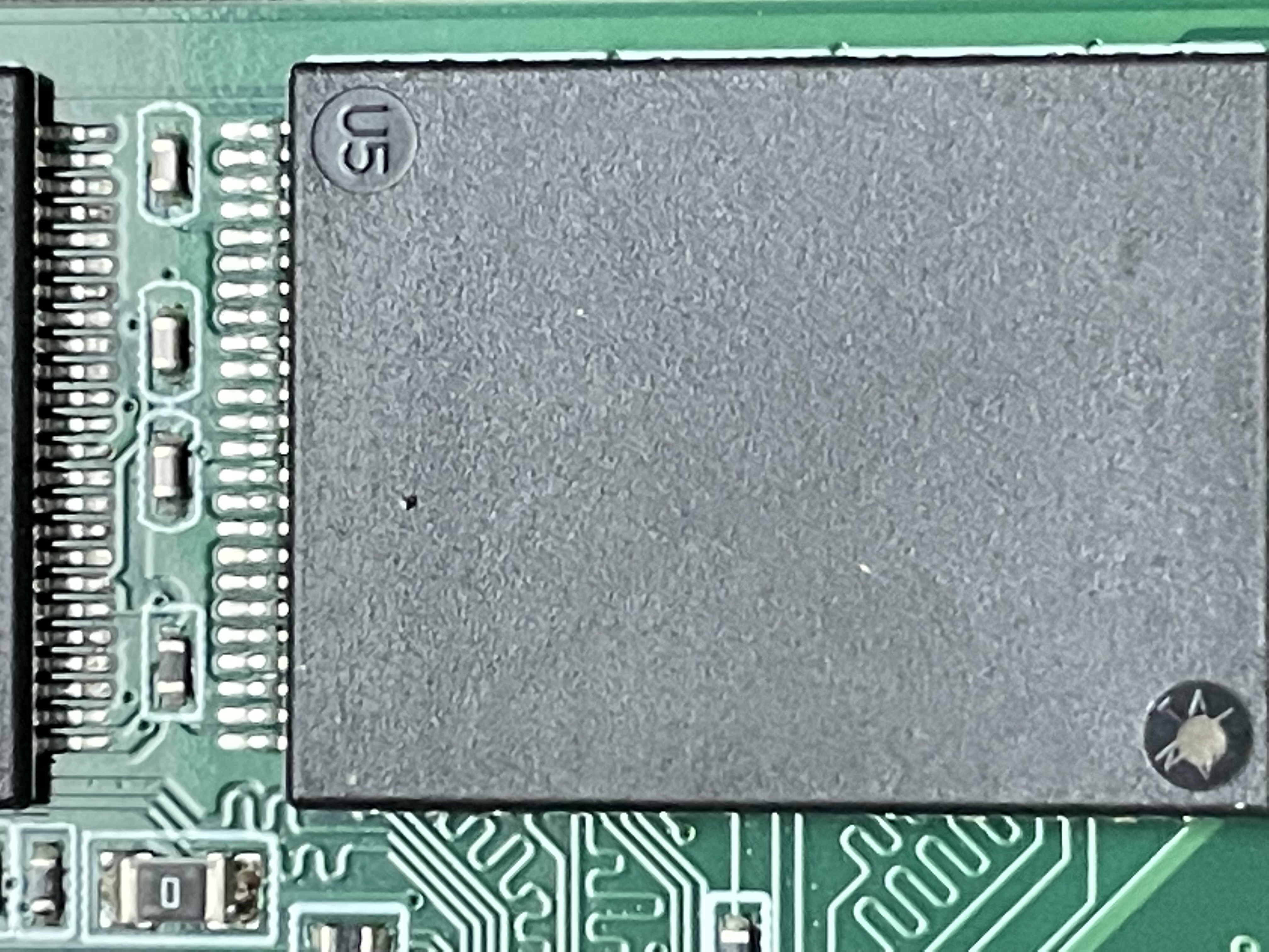

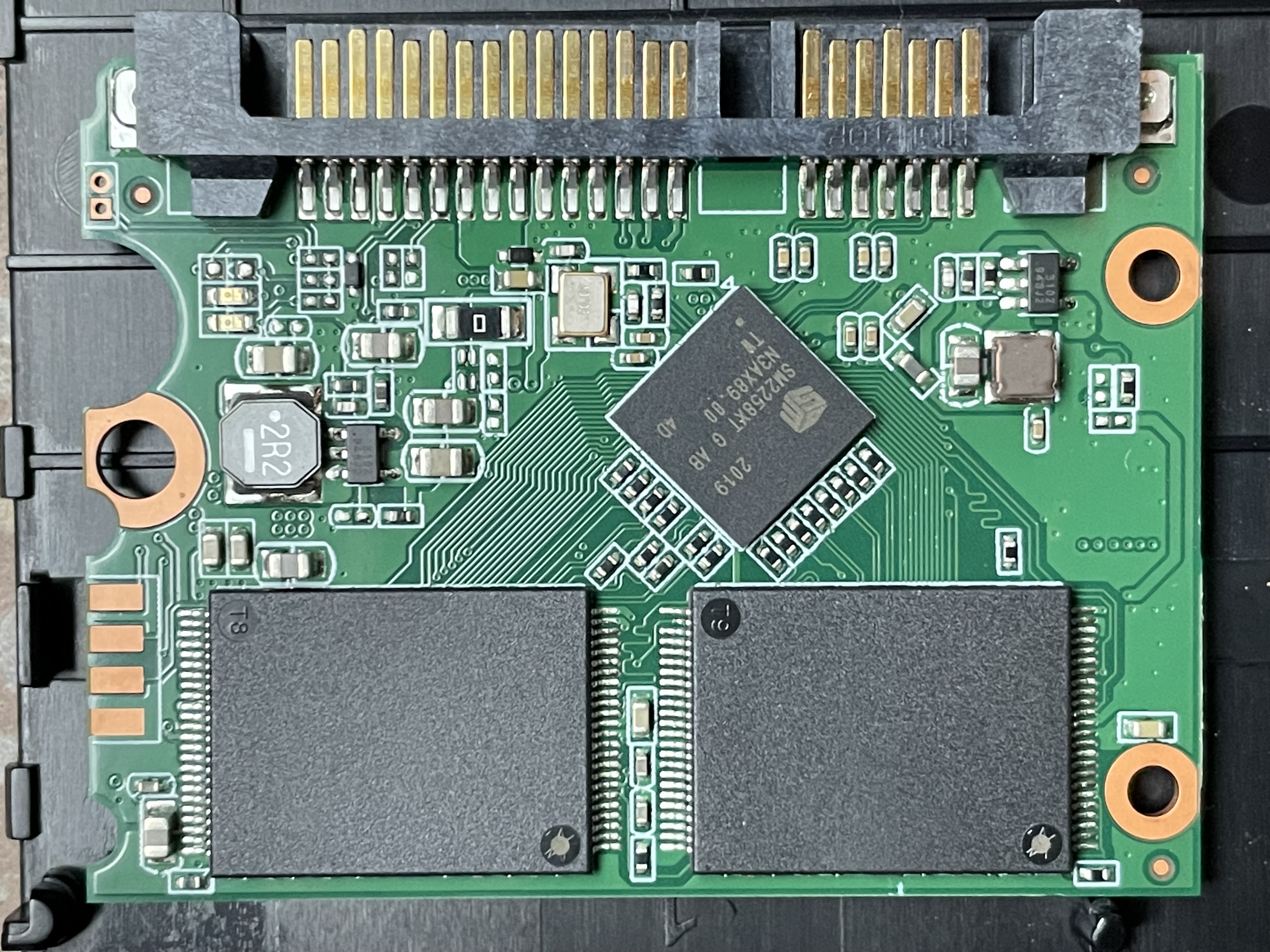

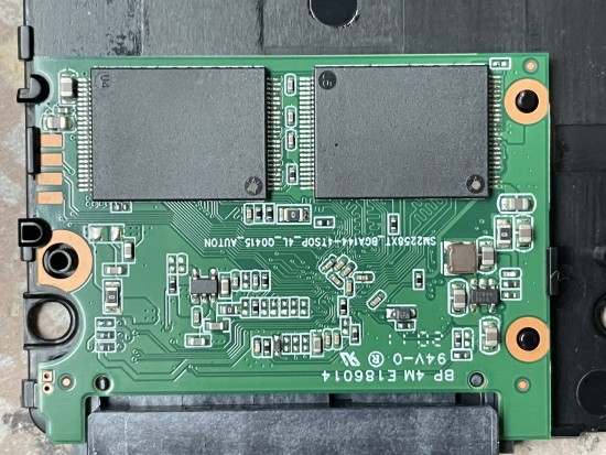

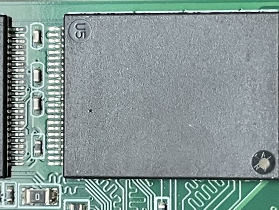

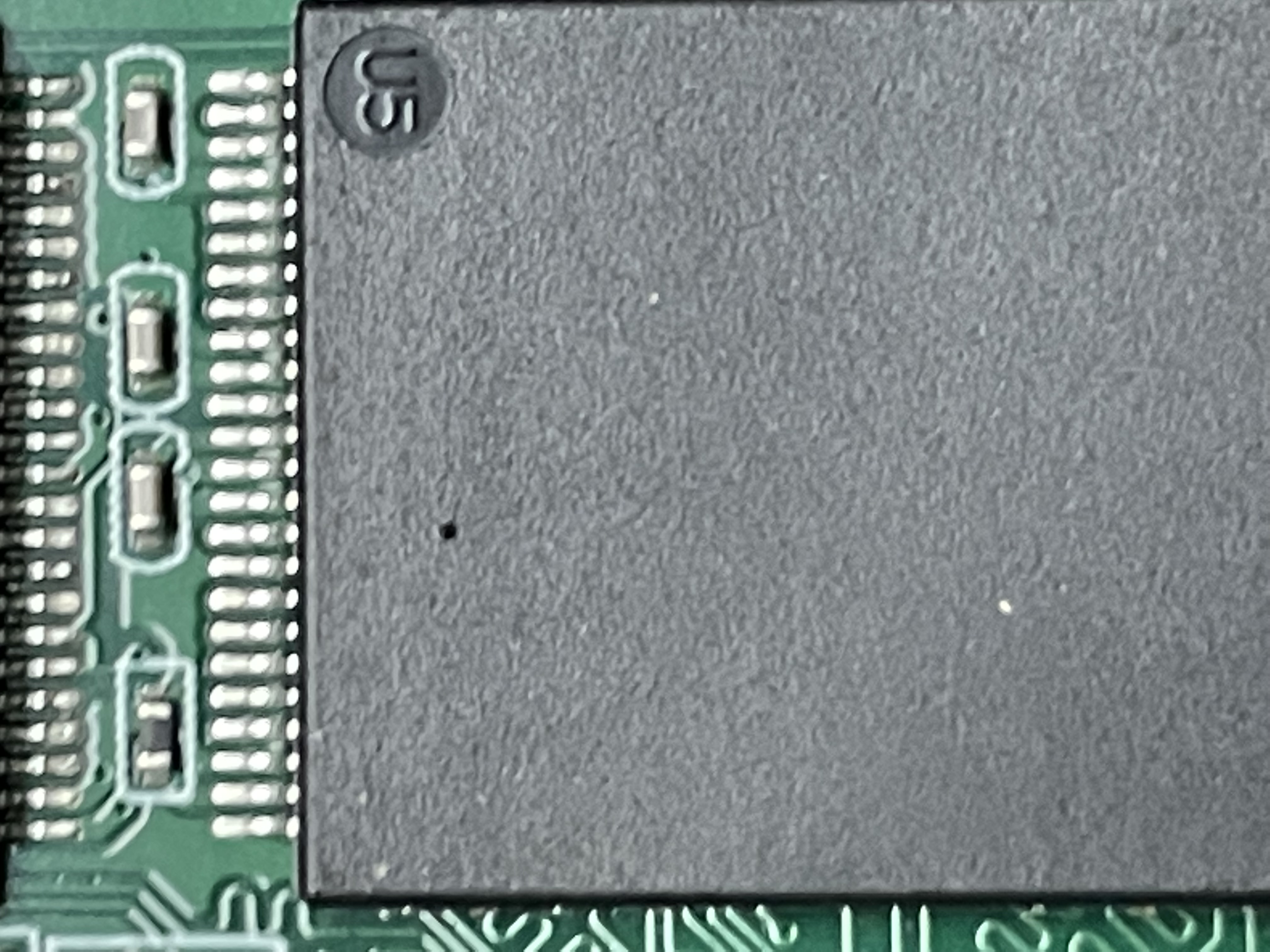

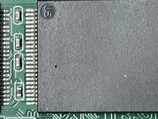

Hi everyone!
Can someone help me find power schematics of this SSD TeamGroup CX2 SM2259XT2G
The SSD powering with PC3000 Shows 0A on 5V
Shorting pins Controller cannot go to ROM mode
Many thanks!

Absolutely flat lined at 0 from power on? break it down from the sata power in, if youre getting nothing something very easy is blown open.
I did measured the resistors around in resistance mode. None of them are broken. The only thing that gets slightly hot. Like 30 degrees C is the controller
Yes. Flat lined

What is the voltage across each of the coils?
If the controller heats up, then the 5V input fuse is fine. Some voltage is missing.
I think the controller is dead

 Post subject: Re: Help me find power scheme SSD TeamGroup CX2 SM2259XT2G
PostPosted: July 19th, 2026, 15:37
Posts: 1323
Doesnt exactly fit with a 0 flat line but check the cap near pin 1.
Im sure Erkin just posted a video of a swap on one of these with a dead controller, Its not the first play Id jump on and I think his was an obvious short.
PostPosted: July 19th, 2026, 16:36
Posts: 17335
Check the crystal.
Measure the voltages at pins 1 and 5 of the SOT23-5 IC (618 + 00022). I think that may be an LDO regulator.
PostPosted: July 20th, 2026, 13:00
Posts: 17335
Sorry, my question was unclear. I only needed the 5.1V/3.3V readings. That IC is a 3.3V LDO regulator and is OK.
It's a long shot, but if you shake the PCB against your ear, can you hear any rattling? If so, then that could be a shattered crystal.
PostPosted: July 20th, 2026, 13:18
Posts: 267
Location: Vietnam
Nothing is rattling
PostPosted: July 20th, 2026, 13:20
Posts: 166
You most likely have a damaged controller.
PostPosted: July 20th, 2026, 13:38
Posts: 17335
Nothing is rattling
If you don't have an oscilloscope, you could try replacing the crystal, but a controller failure seems more likely.
One other possibility is a shorted capacitor on the reset pin, but that's unlikely.

I still have some kind of problem with the SSD
So i have swapped the Donor controller
Now the SSD can enter the ROM mode, and can ID nand fine
However if not in rom mode. The SSD still only have 0.2A The LED on the left doesnt light up? I still think there is some problem with power

I think mine still have something with the power.
The LED on the left doesn't turn on when i turn on the SSD. I tested the LED it is still functional
Any other things that i can test?

Do you know if that's a power or activity LED - If you have a working donor why no just swap the nand over and get the recovery completed for the client you can work on the why this one does work after.
