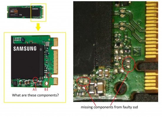

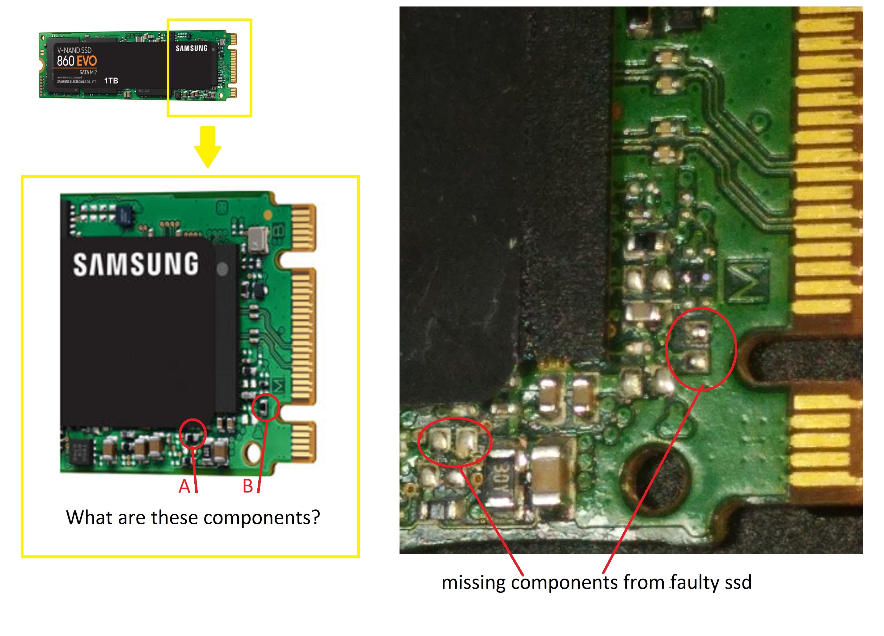

I am trying to recover data from a faulty 1tb Samsung 860 EVO M.2 which appears to be missing the two components which I have circled in red on the attached image (downloaded from samsung alongside a close-up of the faulty SSD). Can anyone tell me what they are?
The SSD (which has Win 10 installed) is not detected either on boot up or when plugged in as an external drive. However, when warmed up with a hair dryer it boots normally and gets past the login page then freezes before I can access/copy files from it.

Those components are not populated:
https://images.anandtech.com/doci/12408/imgp0268.jpg
https://www.anandtech.com/show/12408/the-samsung-860-evo-m2-2tb-ssd-review
