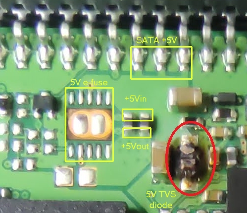

Hi all,
I got a dead Samsung PM871 256GB (p/n:MZYLN256HCHP-000L2), that seems to have a toasted "something"(?), as seen in the photo:
i have unsoldered the component (drive is still dead) and here is a closer look:
any ideas?
Thank you in advance!

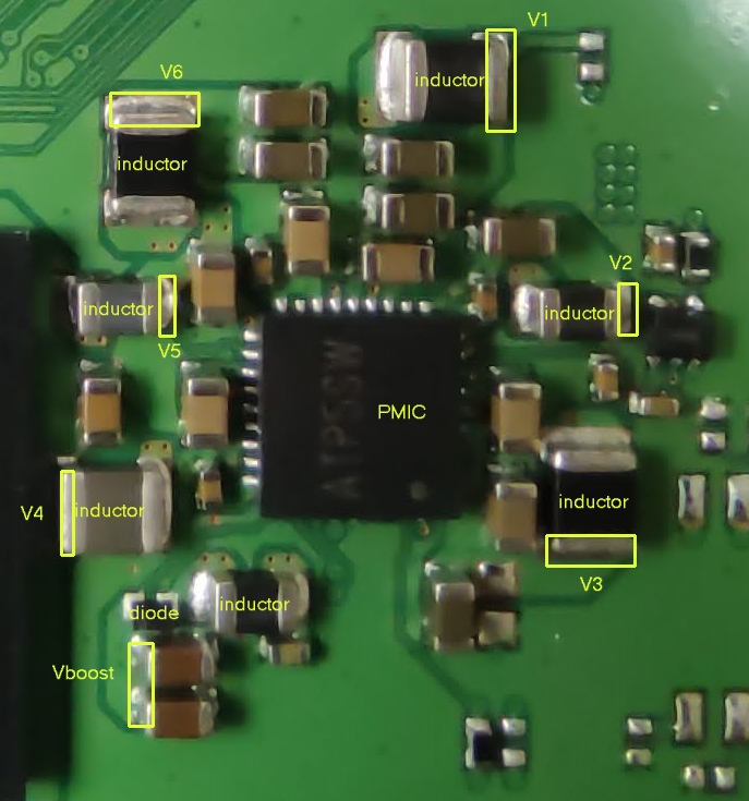

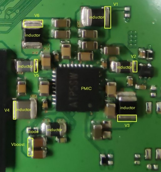

Here are my voltage measurements (with the burned component desoldered):
pic #1:
V1: 1.27V
V2: 1.12V
V3: 0V
V4: 0.01V
V5: 1.82V
V6: 1.88V
Vboost: 12.10V
pic #2:
SATA +5V: 4.95V (all three highlighted points)
+5Vin: 4.95V (both top points)
+5Vout: 4.95V (both bottom points)
5V e-fuse:
top row points: 0V, 4.95V, 4.95V, 4.95V, 4.95V
middle row points: 0V, 0V
bottom row points: 0V, 4.95V, 4.95V, 4.95V, 4.95V
5V TVS diode:
top point: 4.95V
bottom point: 0V

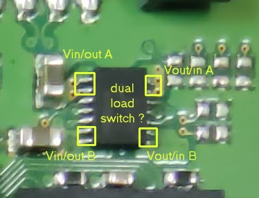

pic #3:
Vin/outA: 1.82V (both highlighted points)
Vout/inA: 1.82V (both highlighted points)
Vin/outB: 1.27V (both highlighted points)
Vout/inB: 1.27V (both highlighted points)

Measure the resistance between ground and each of V3 and V4. If you find a short, then measure the resistances of the tiny bypass capacitors around the major ICs. That will tell you which chips are being powered from these missing rails.

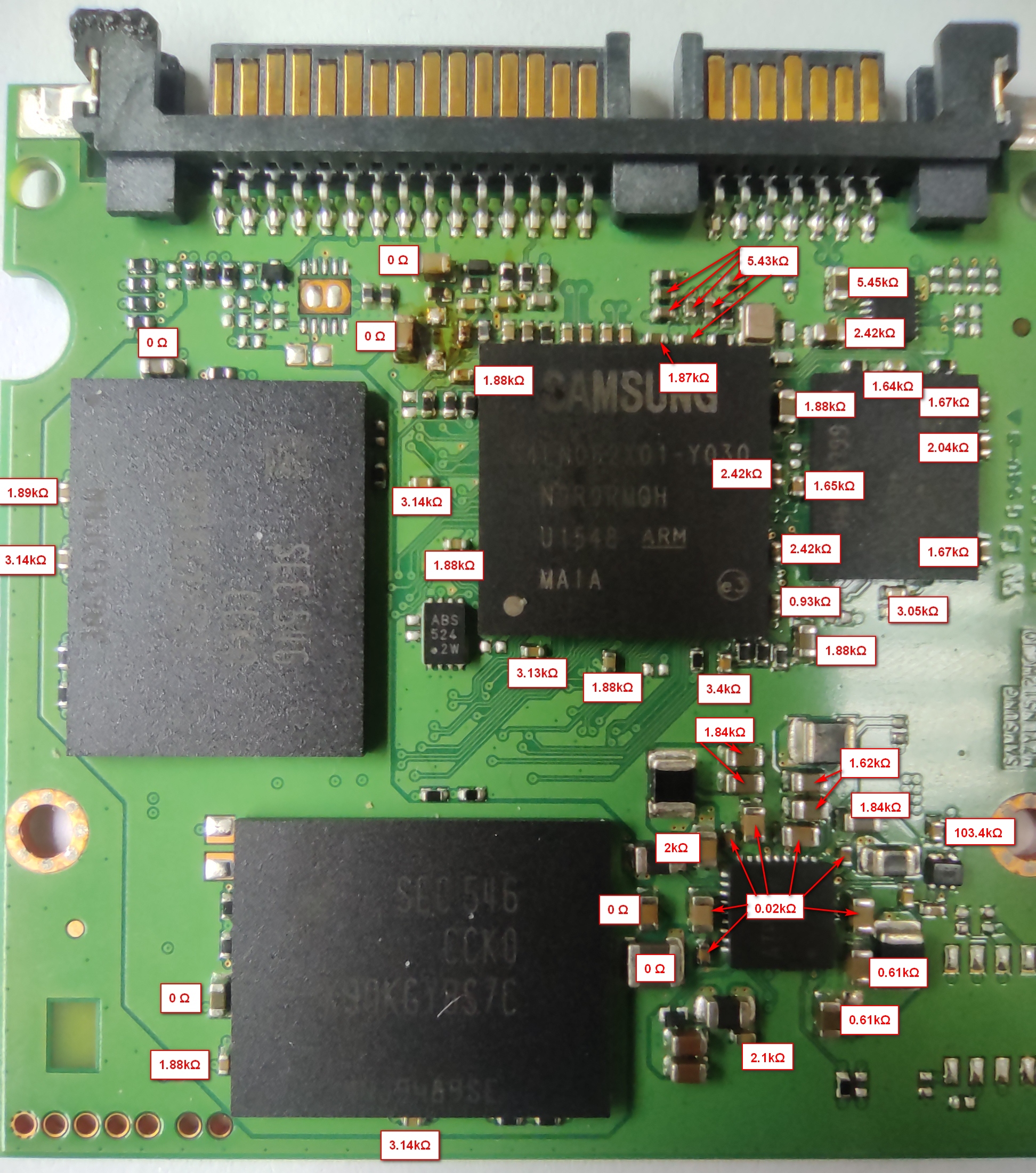

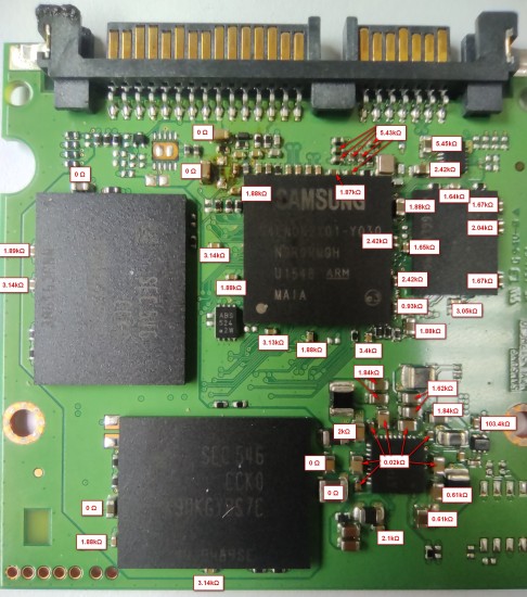

I measure resistance between:
Ground and V3: 1.09kΩ
Ground and V4: 0Ω (shorted)
and in the attached photo you can see the measured resistances of the capacitors.

Your results are confusing. You are showing 0 ohms for the resistance across the SATA +5V supply, which is a dead short, yet your voltage measurements show that the +5V supply is present. Also, those capacitors which measure 0.02 kOhm (= 20 ohms) are the 5V bypass capacitors for the PMIC. Therefore, something is loading the 5V supply, but not enough to shut down the external PSU.
The output from V4 is shorted, so V4 = 0V. The missing output from V3 may not be an actual fault, although it's hard to know for certain. These PMICs are designed to power up each voltage rail in a preprogrammed sequence, in which case it could be that V3 is down because it is waiting for V4 to come up.
Anyway, your problem is one of the V4 capacitors, or the PMIC, or one of the NANDs. These MLCC caps do sometimes fail shorted, but in this case it would be an unlikely scenario given that the SSD was hit with an overvoltage. It's more likely that one of the semis failed, probably the PMIC.

    5V into 20 ohms = 1.25W
    5V into zero ohms > 1 gigawatt
That said, the OP's voltage measurements would suggest that there is no dead short. :-?
I'm inclined to suspect the PMIC. It would be a chore to desolder it, but I can't see any other way to narrow down the culprit(s).
