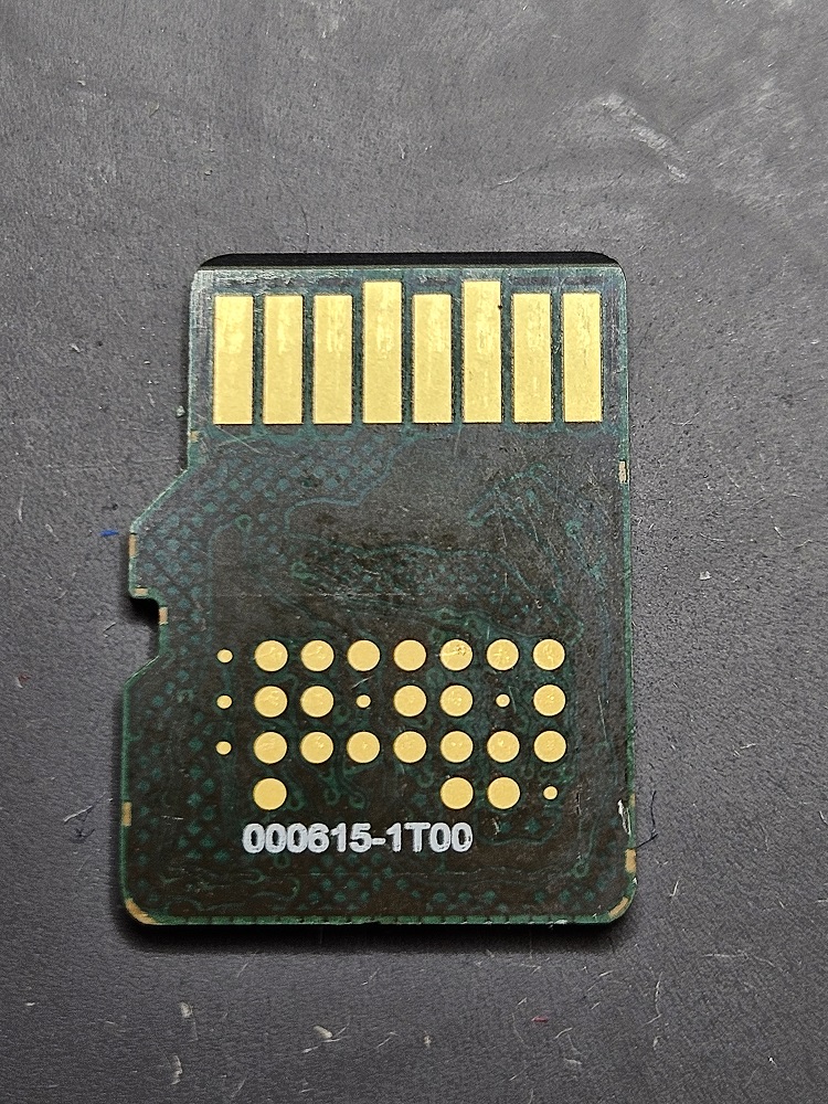

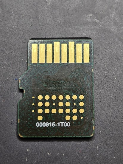

Anyone know if this is LDPC?
Interested to know before we work on a pinout.

Yes, it is LDPC. MicroSD v163 from our database: https://odzyskiwanie-danych.com.pl/monolith-database/

Many thanks for confirming Michal.
