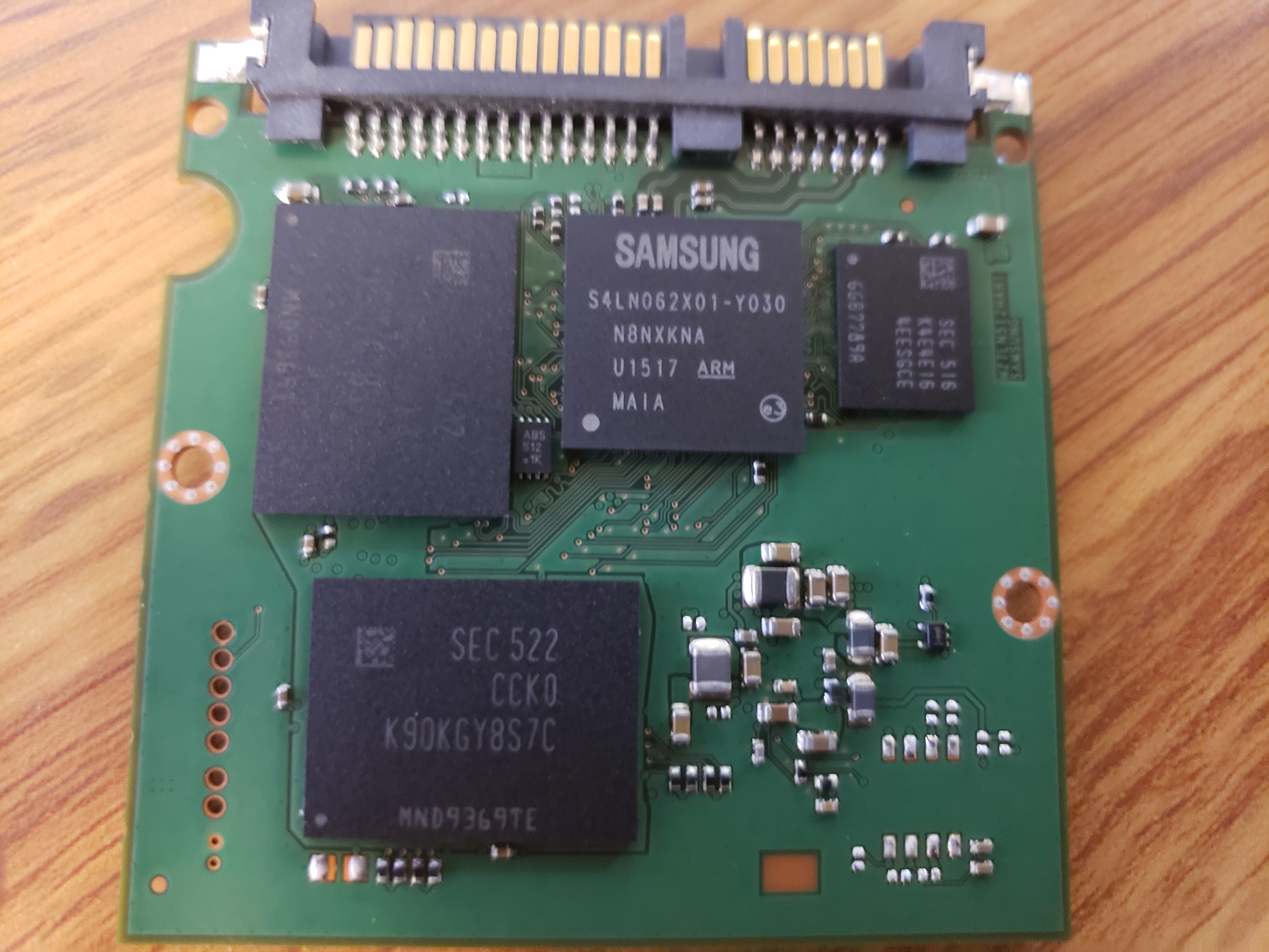

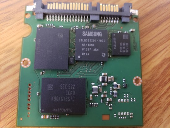

All of a sudden this SSD won't work. Something happened last night and HP Z workstation got rebooted. It won't boot of the drive anymore. I get error "Non-system disk". Not sure if some electronics inside is dead or not. I opened the case. The board doesn't show any sign of damage that I can see.
Can someone please advise on the troubleshooting steps I should take?
Hopefully data is intact and can be retrieved.

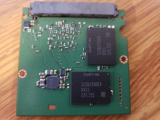

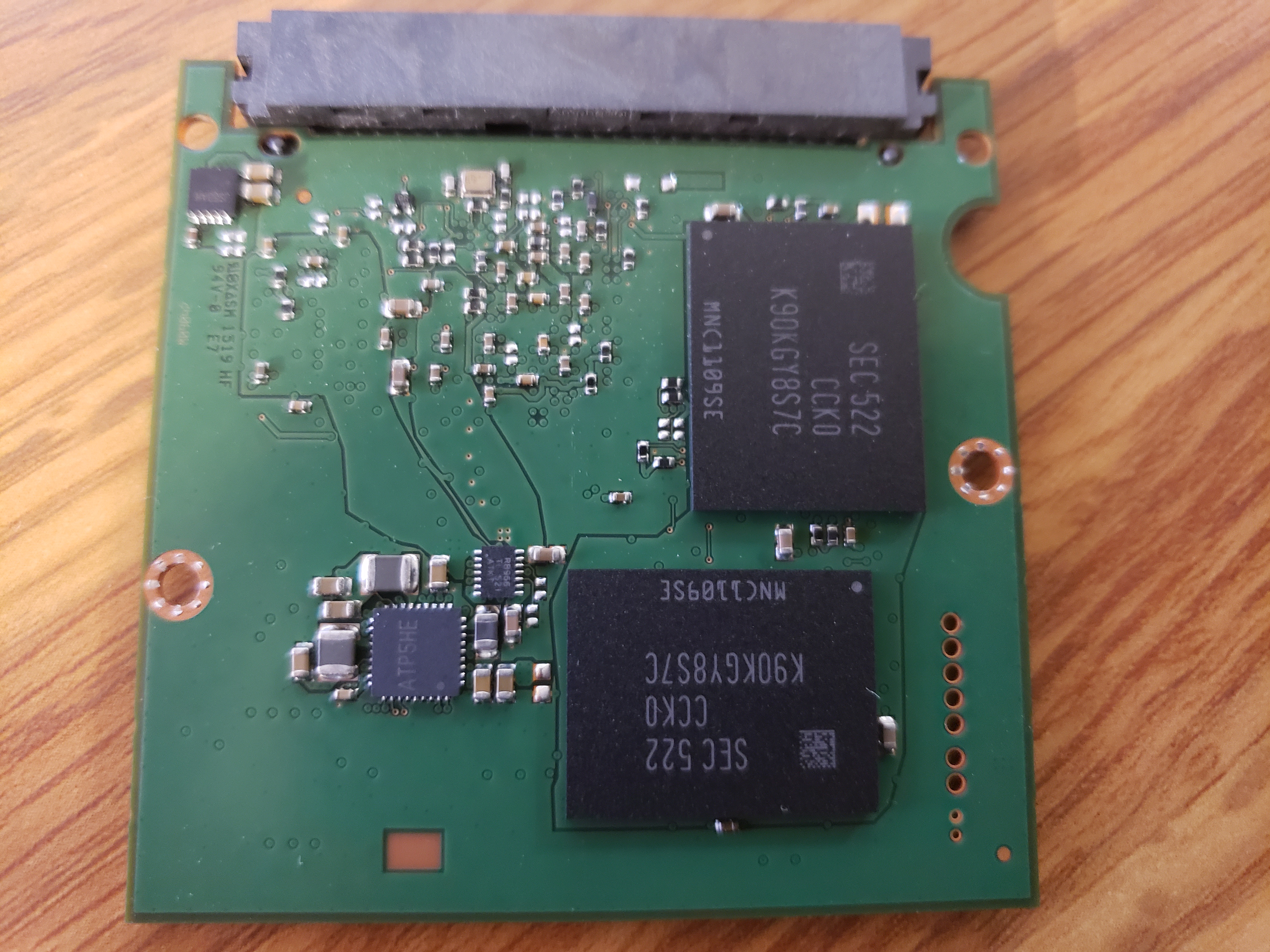

It's 500GB SSD mode # MZ-75E500
Here are the pics of the board.

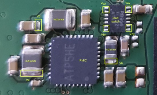

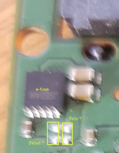

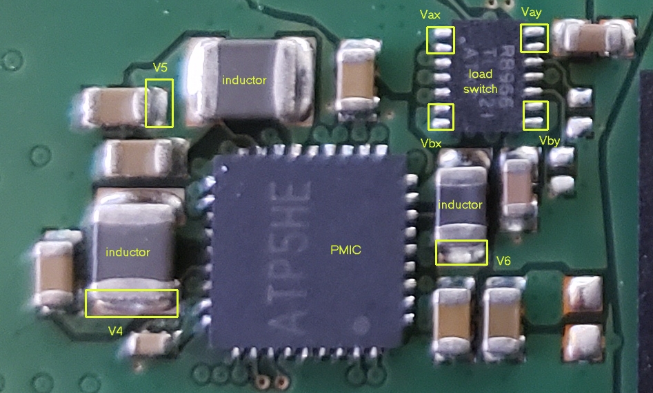

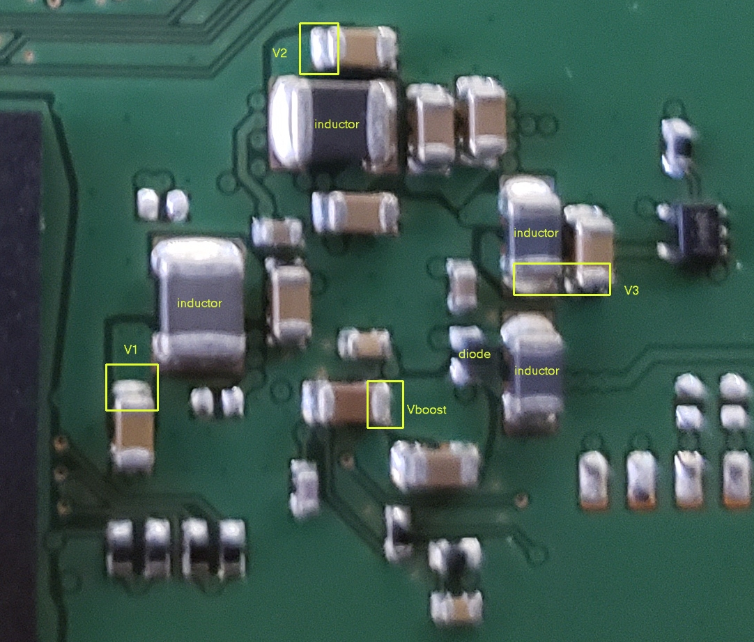

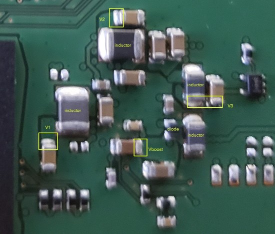

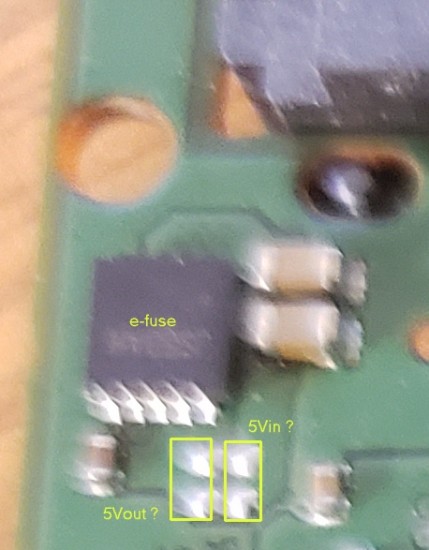

Measure the voltages at the indicated test points. Use any screw hole as your ground.

Thanks for help response. I'm waiting to receive SMD probes. My DIMM probes are too big for the task.

Usually these drives fail when the firmware "panics", which in turn is usually due to bad NAND. You can determine whether the flash controller has basic sanity by shorting the "safe mode" test points at power-on. The drive should then identify itself with its default factory ID, albeit without data access.

Just to confirm the "safe mode" test points are the next 2 holes left of the 5 holes right?
There are 2 smaller holes at the very left of these 7 holes.

Connecting the drive to a Linux box didn't reveal anything in the "dmesg" so I think it was not detected at all.
I tried the "safe mode" but it didn't help either.
The chips don't feel like warmed after been powered up for a while. Somehow I feel like a component failure, suspect fuse.
I will check the voltages once I've the probes.
