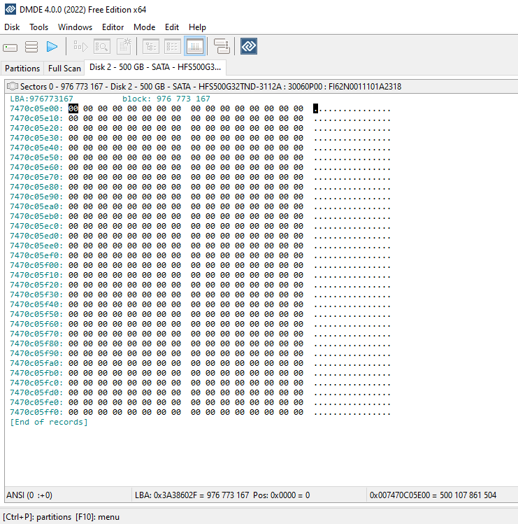

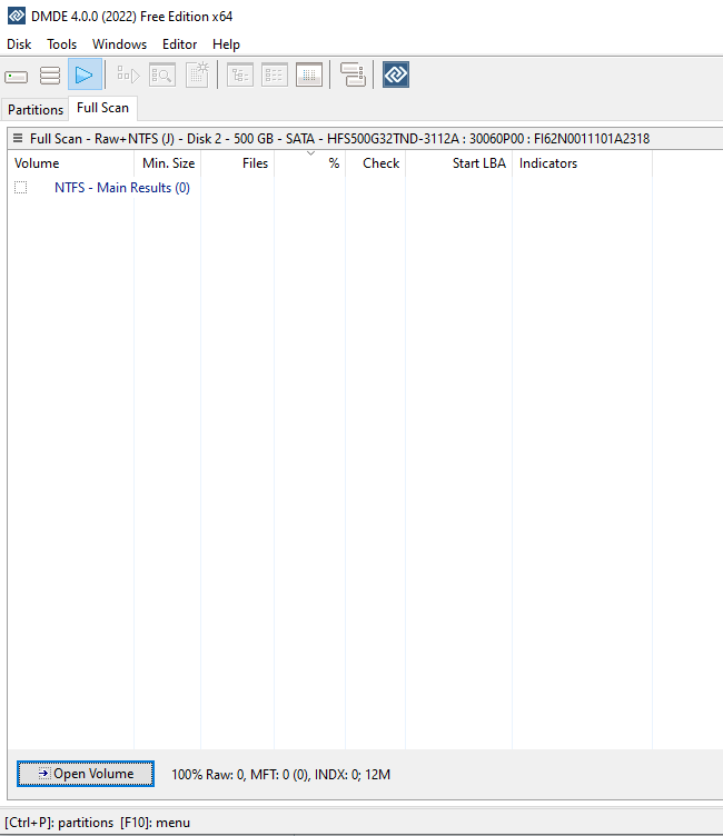

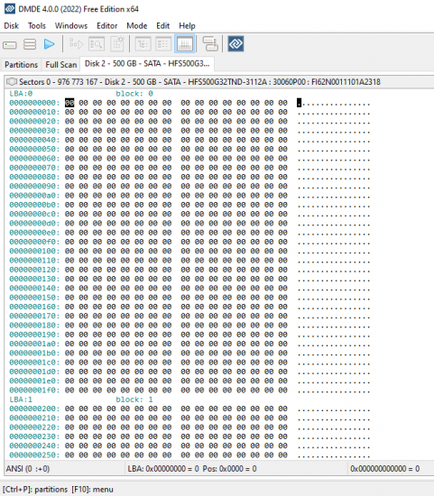

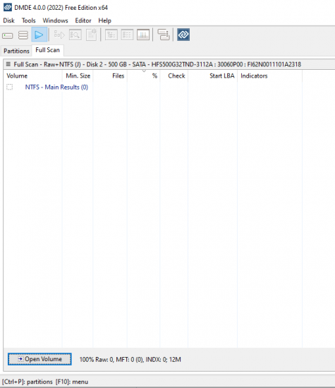

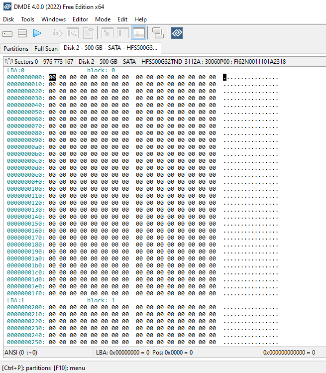

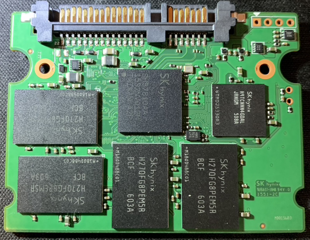

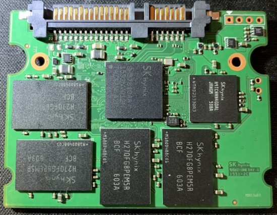

Is there a way to get to recover the data?
Via UART? Safe Mode or similar?
Thank you!

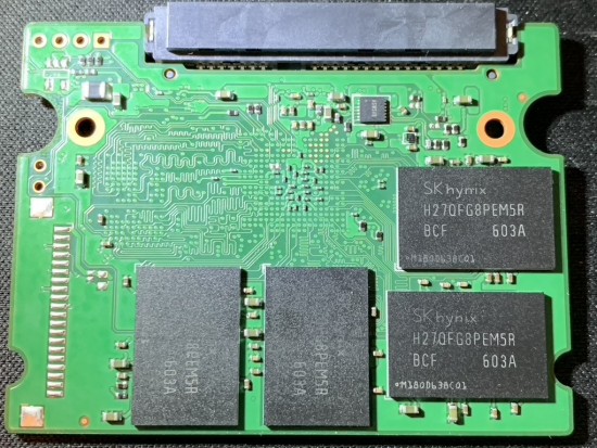

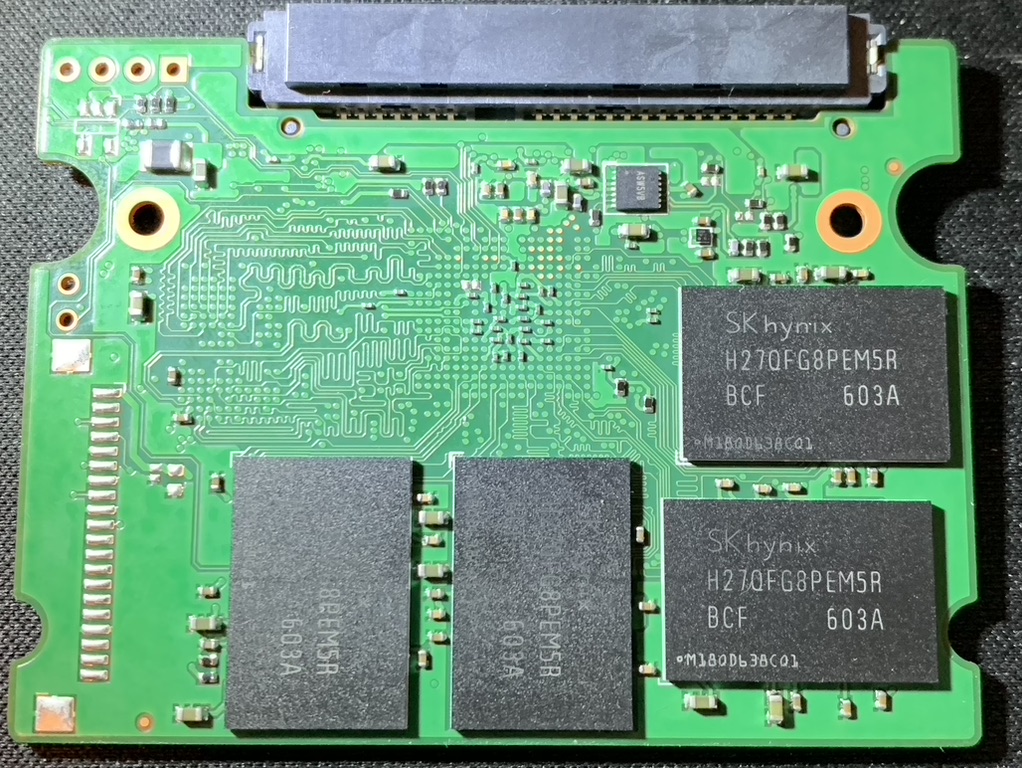

i was able to gain serial access (UART) and JTAG by shorting the two pins during power up:
I think the SSD is now in SAFE Mode (Size of 8GB) ?

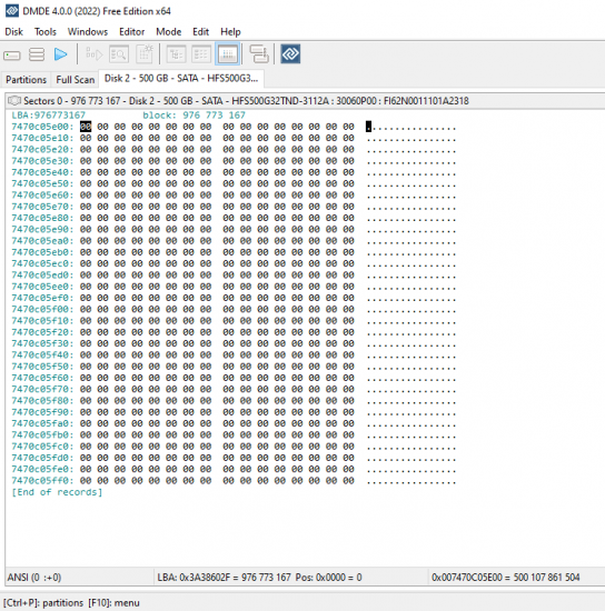

Hello fzabkar
If I understand correctly, your drive IDs correctly and reports valid SMART data, but you cannot access the user area. Is that it?
Correct. According to the customer, the hard drive was suddenly no longer recognized by Windows.
Does DMDE show anything in the Partitions window?
Reading the SSD via R-Studio, PC3000 Disk Analyzer or DMDE did not reveal any partitions or data... as if the SSD was suddenly brand new.
Also the HEX Viewer only displays zeros.
