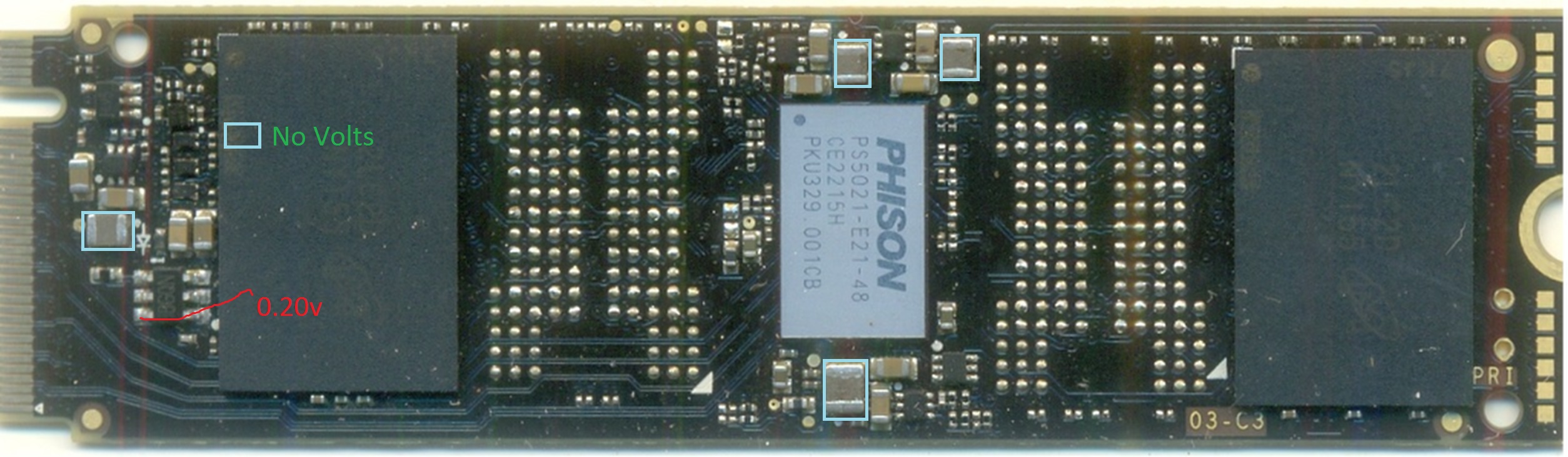

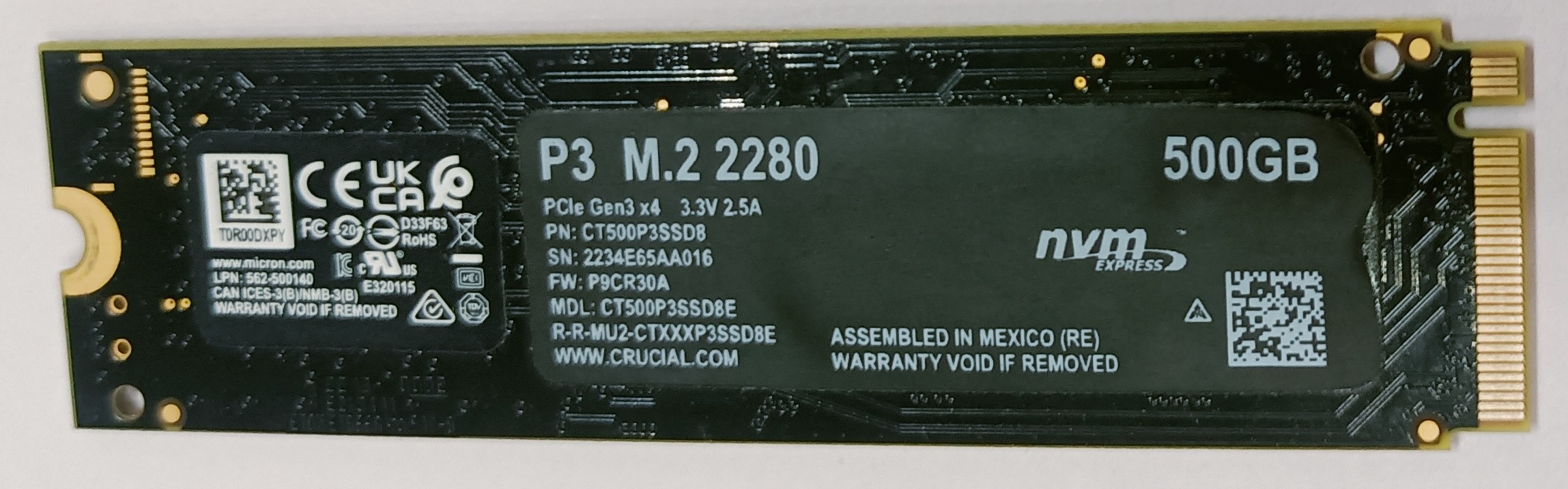

Crucial P3 M.2 2280 500GB is not detected.
I can't get any voltage. can someone point me to start test and voltage ref.

Measure Vin and Vout at the current limit switch (BGQx).
Measure the voltages at each of the inductors.

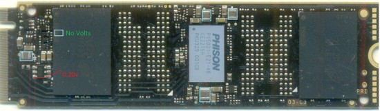

No Volts in any Inductors
only i get volt 0.20V in the marked leg of BGQx

Pin 2 is Vout, pin 5 is Vin, pin 3 is Ground.
Pin 1 should be high to enable the switch.
ISTM that there is no power getting to the IC. Are you sure your power supply is OK? I can't see the markings on the small ICs, so I can't tell whether there is something else between Vin and the +3.3V external supply.

What are you using as your ground reference?
Is there a short between Vin and Ground?

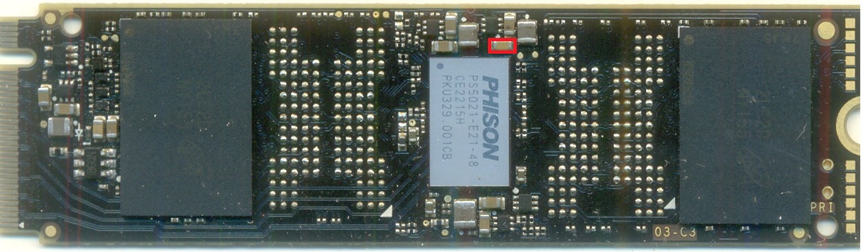

The RED Marked Caps shows short
 Post subject: Re: Crucial P3 M.2 2280 500GB
PostPosted: February 7th, 2023, 3:52
Posts: 17332
I don't get it. Why is there no +3.3V input at BGQN?
Do you mean "The RED Marked Caps show short" or "The RED Marked Cap shows short". I only see one ...
Is the shorted cap above the Phison controller connected to the inductor?

Sorry Cap only not Caps
Yes it is connected with inductor
PostPosted: February 7th, 2023, 4:18
Posts: 17332
Remove the capacitor and retest for shorts. If all clear, then you must replace the capacitor because this is the main filter capacitor for that buck converter.
Of course, you will then still need to determine why there is no +3.3V input at BGQN ...
