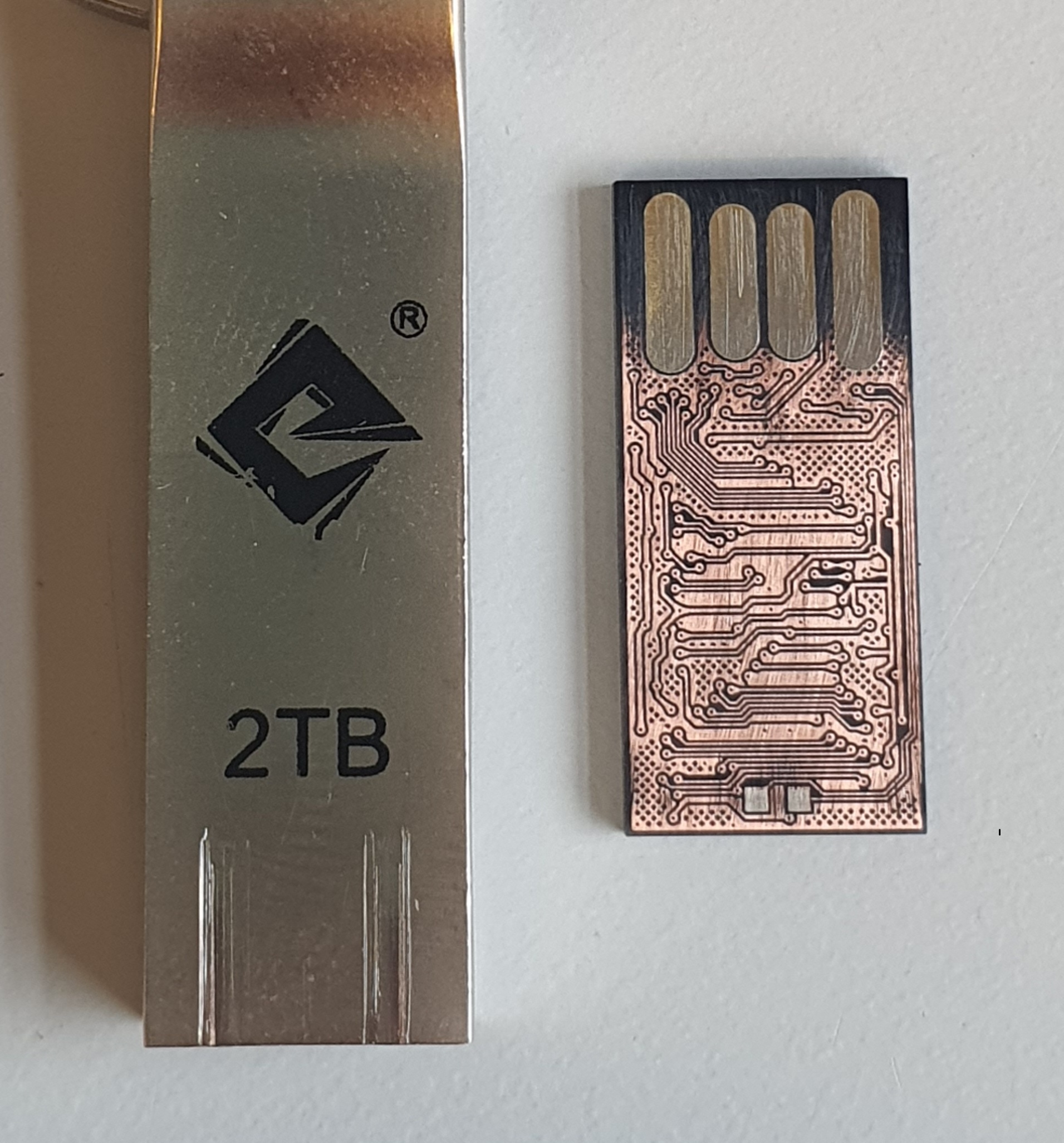

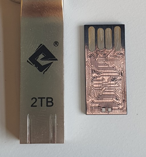

Hello guys!
I have this USB flash whats marced with 2TB (i dont think its actually 2TB) and it just recognize the controller.
So i wanted to work on it with the PC3k Flash but i dont have the PIN layout..
Maybe someone of you guys would sell it to me and/or can give me some advices about this USB flash?
I am new at working with the flash so i would appreciate any advice!
Thank you!
Greets, Ihab.

Let me quess... is it FC controller? Usually it use 32/64GB memory chip. Looks like common refurbished device. Pinout is the simplest part.

arvika, thx for reply. I am not sure to be honest.. first time working on this fake stuff...
But i guess when i solder the pins on the multiboard.. it coukd be possible to read the information like size and Chip ID.

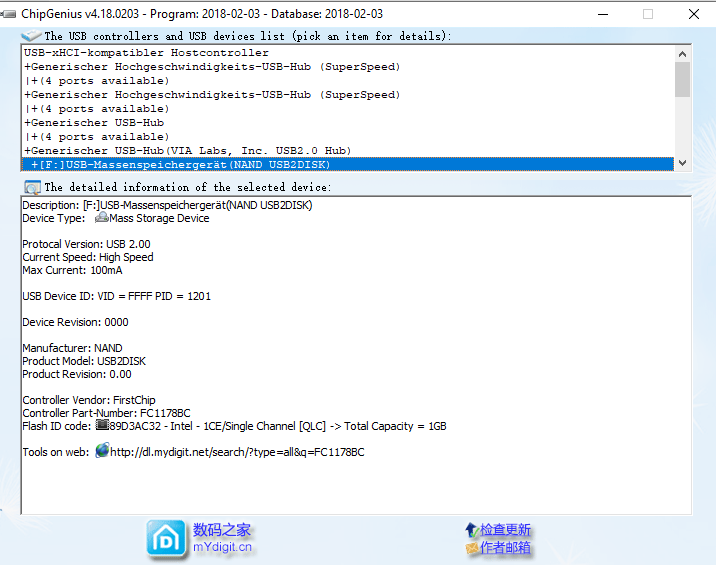

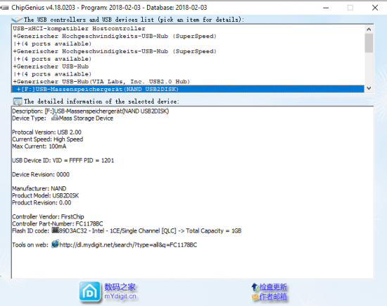

arvika, This is what i got:
 Post subject: Re: 2TB USB Flash
PostPosted: February 14th, 2024, 13:27
Posts: 922
As I excpect controller is FC - Firstchip. So far I have one case with this chip - it was solved. Memory was 128GB, 6th byte addressing.
