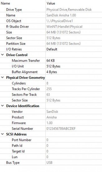

 Post subject: Sandisk 128GB shown as Sandisk Anisha 1.00 - 64 MB
PostPosted: January 8th, 2022, 12:06
Joined: December 14th, 2020, 11:51
Posts: 57
Location: France
I got this Sandisk 128GB USB Monlith.
when connecting to W10, it ask to format. R-Studio show 64 MB. Firmware corruption ?
Looks like a common bug.

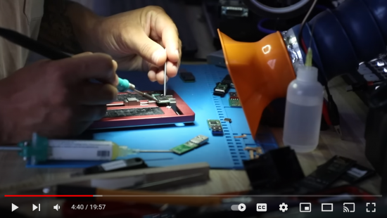

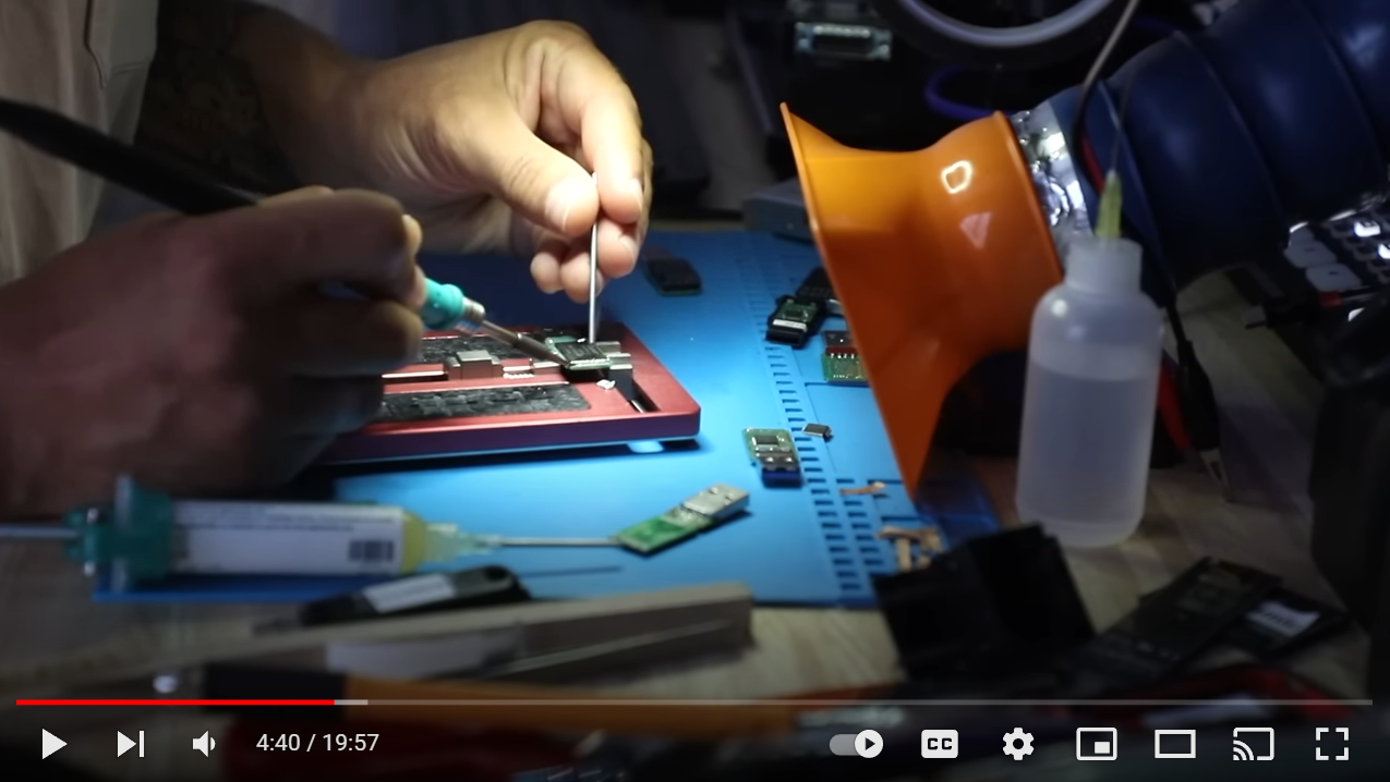

if your Sandisk is recognized as Anisha 64mb - the NAND is disconnected from controller
AKA safe mode, ROM mode solution is here

Swap is always risky. If possible (no encryption), always try chip-off method first.
