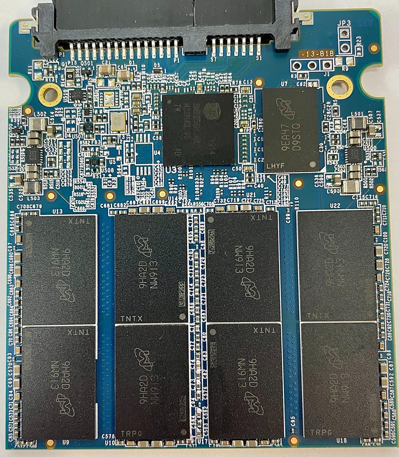

Hello guys,
I wonder if anyone can shed some light on this, please. That would be greatly appreciated.
I have a shorted MX500 (the client connected the wrong PSU cable to the SSD and shorted it.
I checked for C674, C675, C676, C500 and C673 and found no issues. C500 was the only one on the board actually. C673, 4, 5, 6 were not on the board at all.
I wonder if you could please point me in the right direction.
Thank you so much in advance.
File comment: ct2000mx500ssd1

Check the zero ohm resistor for a start, then the efuses, then on to the voltage checks at the inductors. What's the current draw?
 Post subject: Re: Cricial MX500 (ct2000mx500ssd1)
PostPosted: February 16th, 2023, 16:27
Posts: 17335
MP5016H, Monolithic Power, 2.7V - 22V, 0.7 - 5A, Current Limit Switch with Over-Voltage Clamp and Reverse Block, marking FG, QFN10:
https://www.monolithicpower.com/media/document/MP5016H_r1.0.pdf
https://images.anandtech.com/doci/12263/imgp0157.jpg

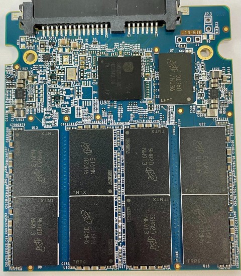

did you found the short because last week I had the same problem with the same SSD and found the short next to one of the NAND units and just removed the shorted cap c88 and c91 they warmed up alot and managed to get access to all data. Will send picture later
