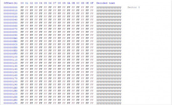

Hello all, hope you're doing well, would really appreciate your help. I have an SD card on my android phone that corrupted(images became black and won't load). I quickly took it out from my phone and backed it up with ddrescue, I now have a .dd file. After examining the sd card through test disk and r-studio no partitions show up. I've also tried to scan the .dd file and also no partitions show up. I do not know what else to try at this point. Hope you could point me to the right course of action to take.

Is the card encrypted?
Can you show us the contents of the first sector with a hex editor such as HxD (freeware)?

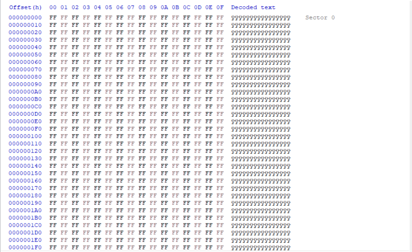

File comment: Output of HxD, for both the actual card and the backup image
Hello here's the output of HxD both from the actual card and the .dd image.

That's what you would expect if the card had been erased. If you drag the vertical scrollbar from top to bottom, do you see anything that looks like data?
If you select Analysis -> Statistics, do you see anything other than a large spike at the RHS (FFh)?
If you compress the dd image with 7Zip, what size is the compressed image?

Hello again sorry for the late reply.
1. Nope, all I see is FF FF FF and so on...
2. It's still analyzing. Will follow up on the result.
3. I compressed the dd image with 7zip to sbd.7z format and the compressed size is just 4,618 kb.

Your card appears to have been totally erased, or is in a state where there is no data access.
