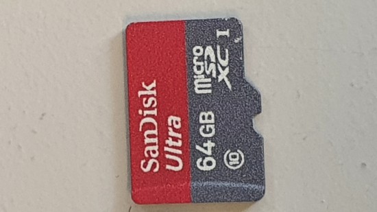

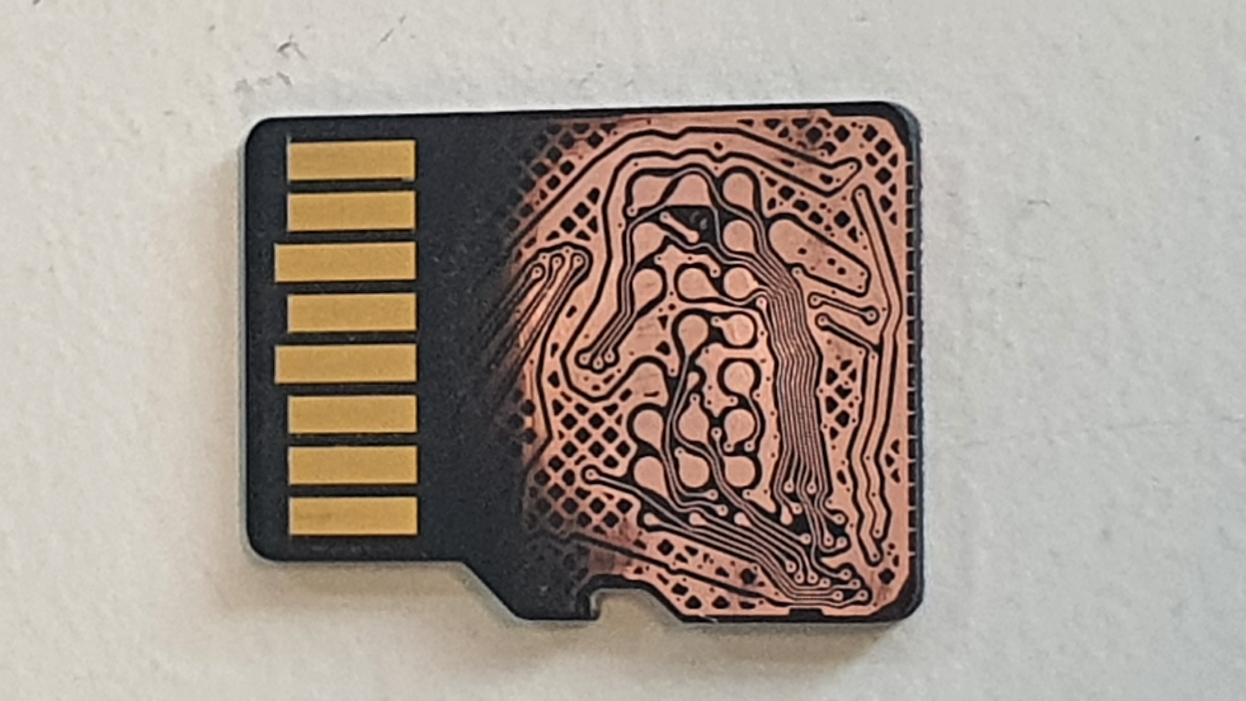

Hello guys!
I have this SD Card and it wont be recognized.. it doesnt have a short.
I wanted to work with the PC3K Flash. But the PC3K Flash forum Database dont have the PinLayout for this SD kart... maybe someone have it or can tell me where i can find it? I am rady to buy it.
Or does have someone other Ideas i could try?
Thank you!

That's a standard 7x3 and must be in PC3000 database.

melvin, Thanks for your reply! So every 7x3 like this example are the same? I also have another SanDisk 64GB SD with 7x3 but the PINways are a biit different.. i also found one ont the database but also with other PINways. (sorry, i am new at the monolyth)

Sandisks 7x3 are all the same. Check VCC/ GND position with multimeter/ tracks. Compare it with pictures in the database.

melvin, Thats a very good information. Thank you very much!
