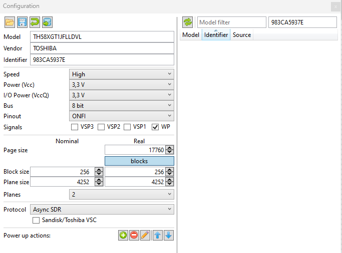

With that, I am currently attempting data recovery from an A1534 Macbook with two LGA60 TH58XGT1JFLLDVL NAND ICs (CE ID 983CA5937E).
I have successfully dumped the entire contents of both NAND ICs. I know that these machines most likely had file vault enabled by default. I care less about that than I do identifying the page allocation for the NAND. For that ID, page size is 16K, plane is 4276, and block size is 256.
Does anyone have any info on ECC and SA for this NAND from this, or any other apple device?

arvika wrote:
What page size you use? Did you cut blocks from the beggining of block? What reader do you use to read dump?
Using VNR. Got config from looking up ID and double checked with JEDEC config in VNR.
 Post subject: Re: Macbook Retina A1534 NAND
PostPosted: March 13th, 2023, 17:37
Posts: 925
Sector 4440 -> 4096_18_326. Such big sector usually means LDPC, or here it could be also Apple propetiary correction. Another challange will be encryption by controller + encryption by filesystem.
