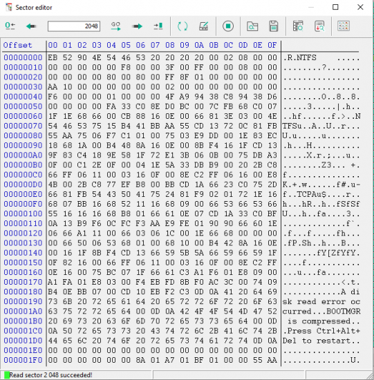

i have this SSD M.2 and it shows like this with R-Studio
and when i do scan it seems that there is no data

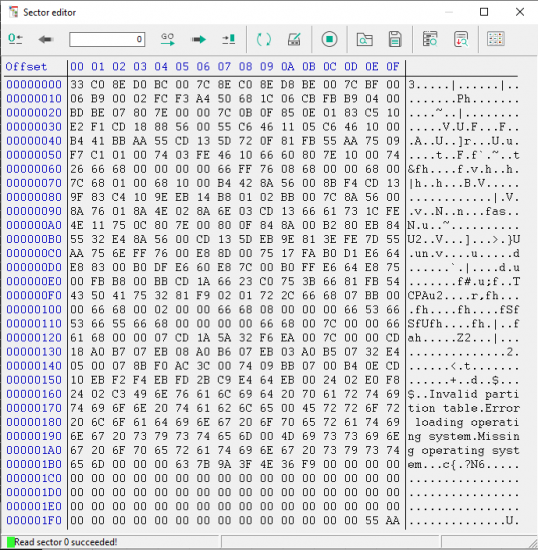

Can you show us the boot sectors?

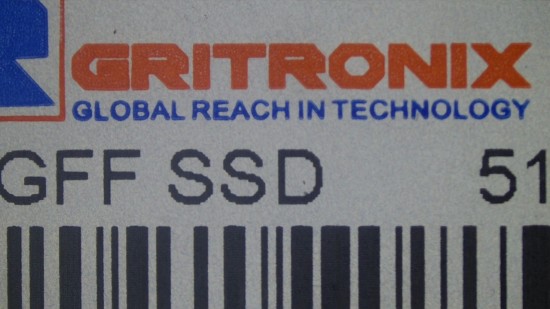

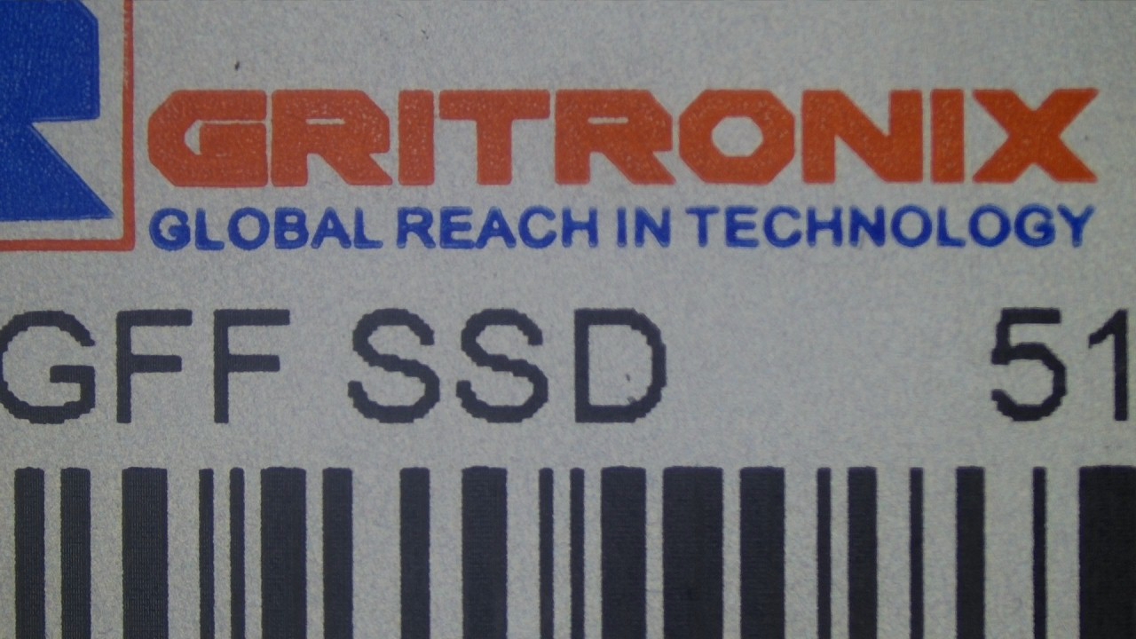

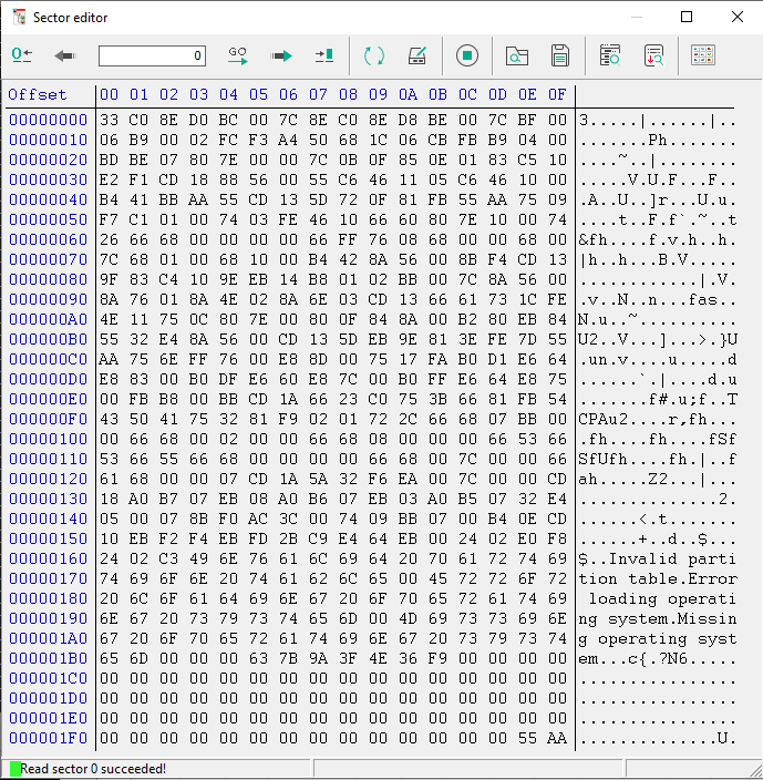

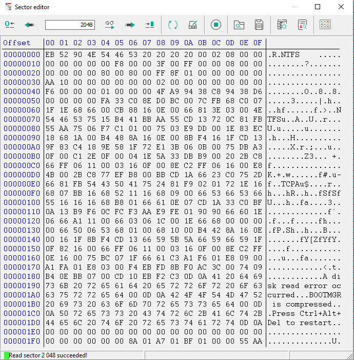

File comment: i did not complete the imaging

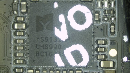

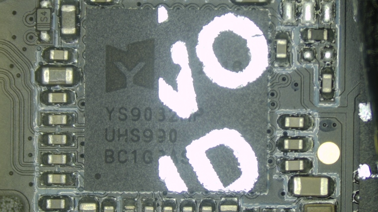

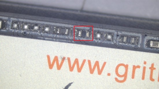

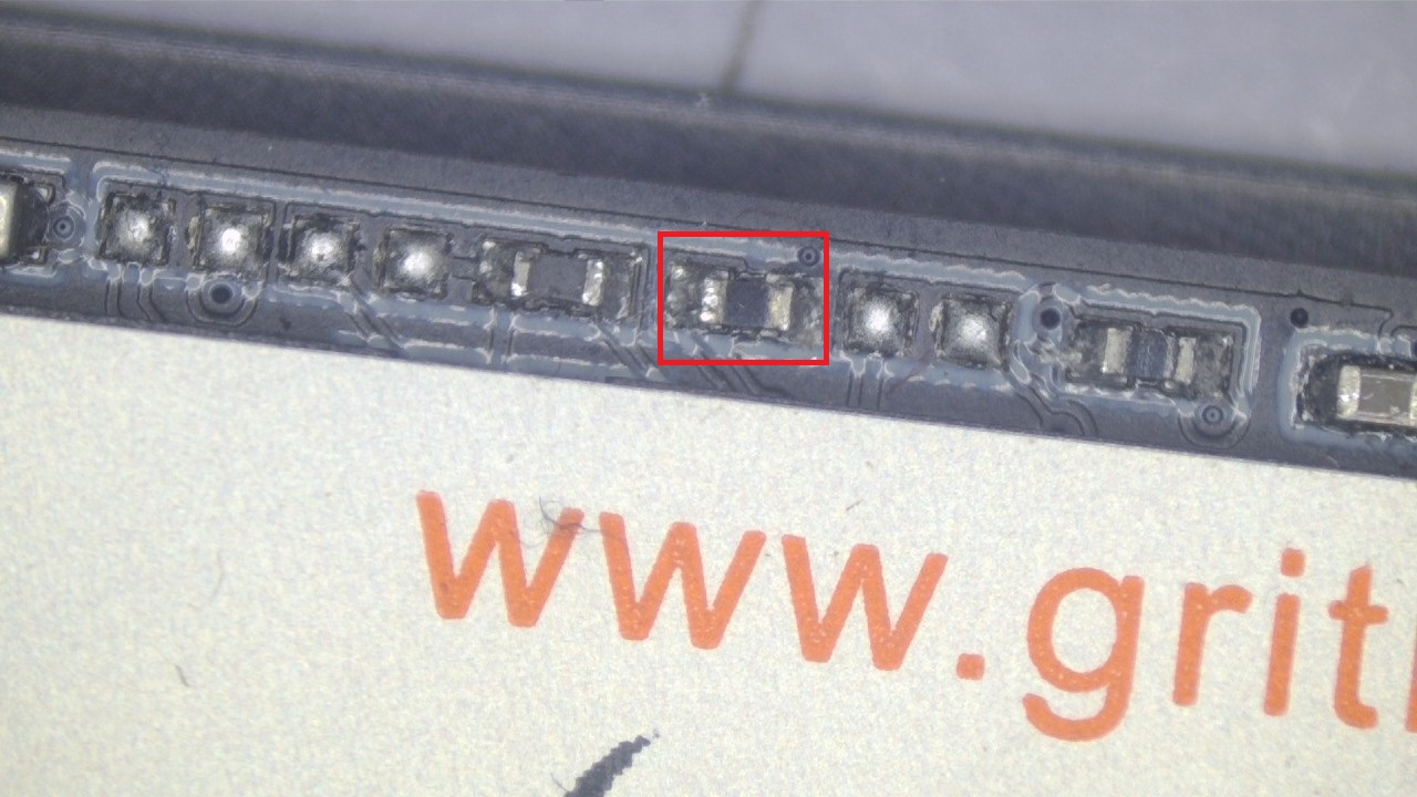

what kind of component is this please ?

I suspect that the "shorted" component may be an inductor. It is probably filtering a supply rail, so no problem there.
Did your customer reformat the data partition? If so, then the data would have been subject to TRIM.
The partition table in sector 0 is empty ...
no he did not format it. the ssd never showed with him
