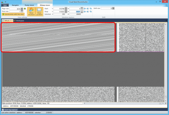

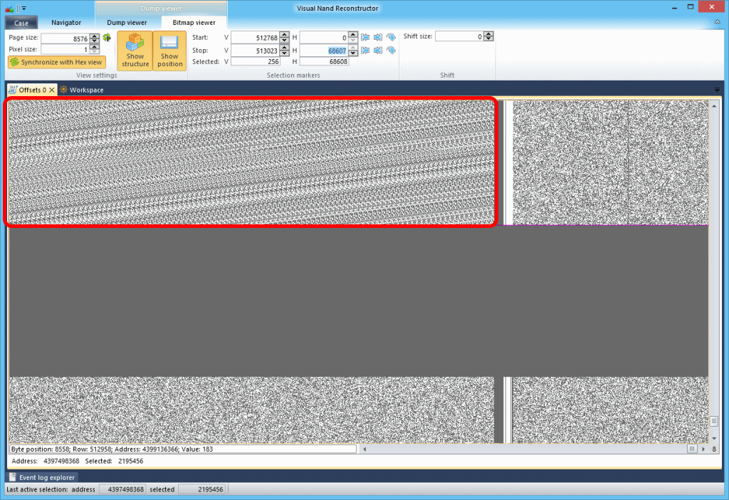

Maybe I should have avoided that word, but if we XOR block of zeros with XOR key or block, do we not increase entropy? AIUI storing very similar data close is more prone to corruption and to avoid this XOR is applied to introduce noise and avoid worst case patterns. I assumed this increase in noise leve translates to high Shannon entropy. But I am no expert on the matter, it's what I read everywhere (NAND Flash Data Recovery Cook Book and other places / documents). If we look at typical XOR-ed block of repeating bytes in VNR we see
Which seems to me higher entropy data than a repeating pattern. If the same is already accomplished by some form of encryption XOR scrambling seems like an un-needed extra step. So maybe reasoning is, encryption gives us required noise AND we can position/market encryption as a feature. I do not know, I am simply guessing, thinking out loud.

Based on the pictures shown I guess that you are doing the XOR operation with a varying source and not with any byte value.

The pictures to the right look like noise to my eye. It looks as if the content of all bytes are equally distributed. I assume that compression would no be able to reduce the size of the underlying files.
Now look at my two sentences above in ASCII-code. XORing each byte with a fixed value from the range [0:255] will certainly modify the appearance but will not affect the form of the distribution. The most frequent letter will be represented by a different value but will represented as often as before performing the XOR operation.
