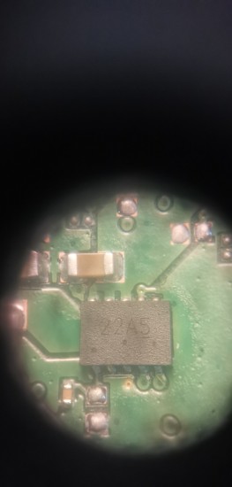

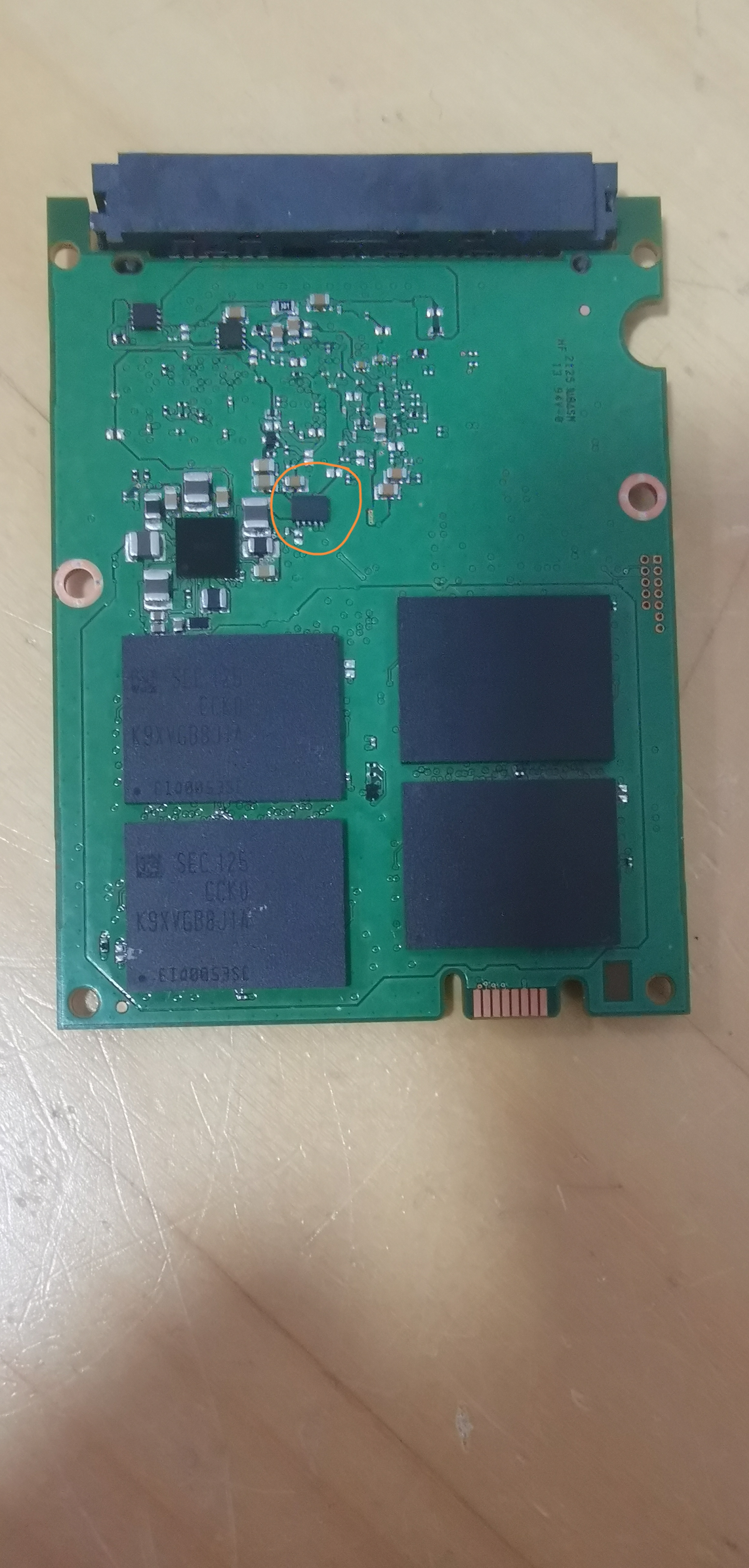

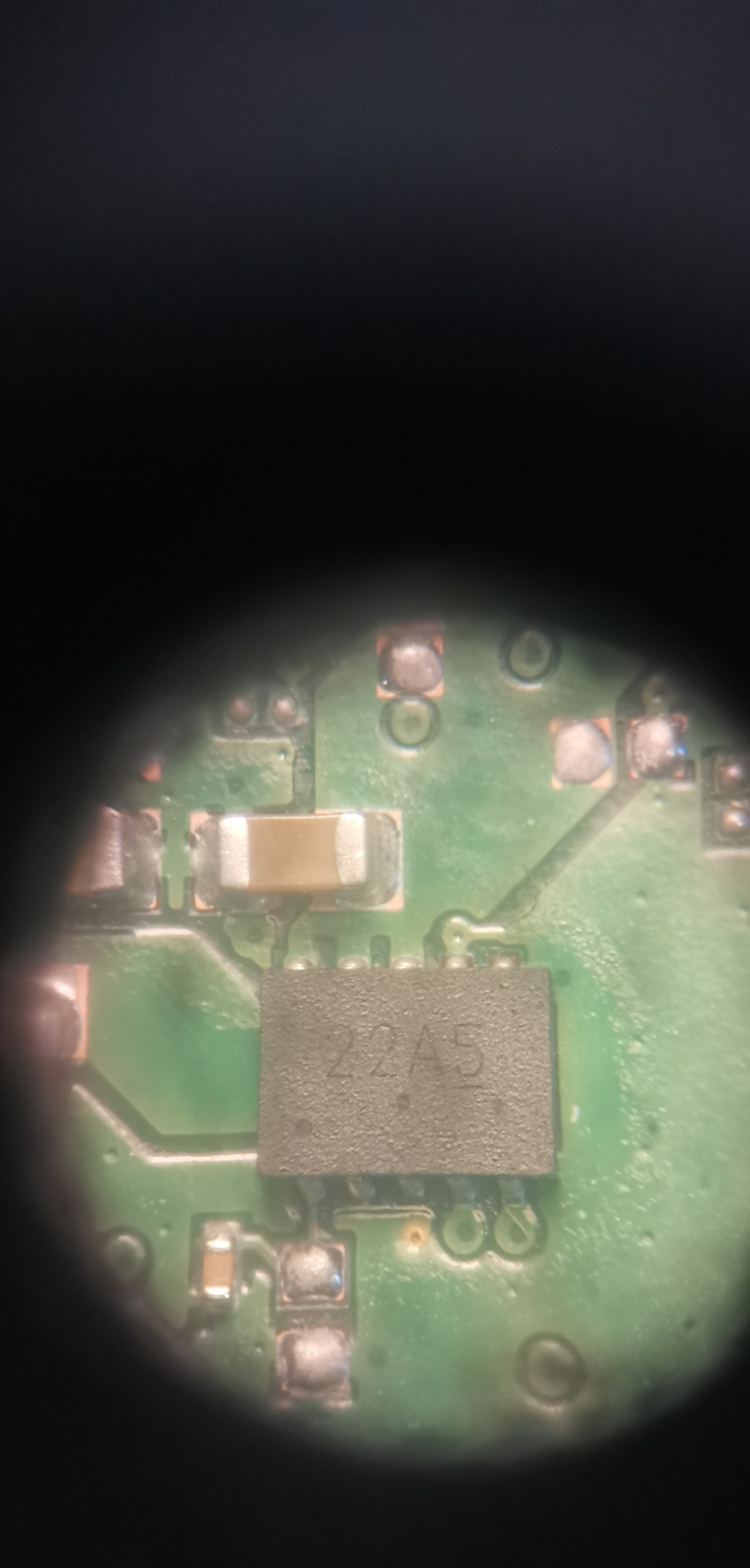

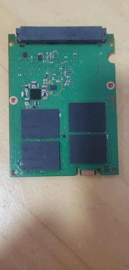

Hello. I was wondering if anybody could help me identify the component on the photo's please. It's from a Samsung 870 QVO SSD (8TB). Initially it just needed a new SATA connector soldering on but I've since noticed a small hole in the component on the photo (I'm presuming this blew after the previous user tried to plug it in with all the mangled pins). I can't find any information about it anywhere. Thank you

I believe it is equivalent to TPS22990.
TPS22990DMLR, Texas Instruments, 0.6V - 5.5V, 10A, 3.9mOhm Load Switch, marking RB990, WSON-10:
http://www.ti.com/lit/ds/symlink/tps22990.pdf
I would check for shorts to ground at its Vin and Vout pins.
