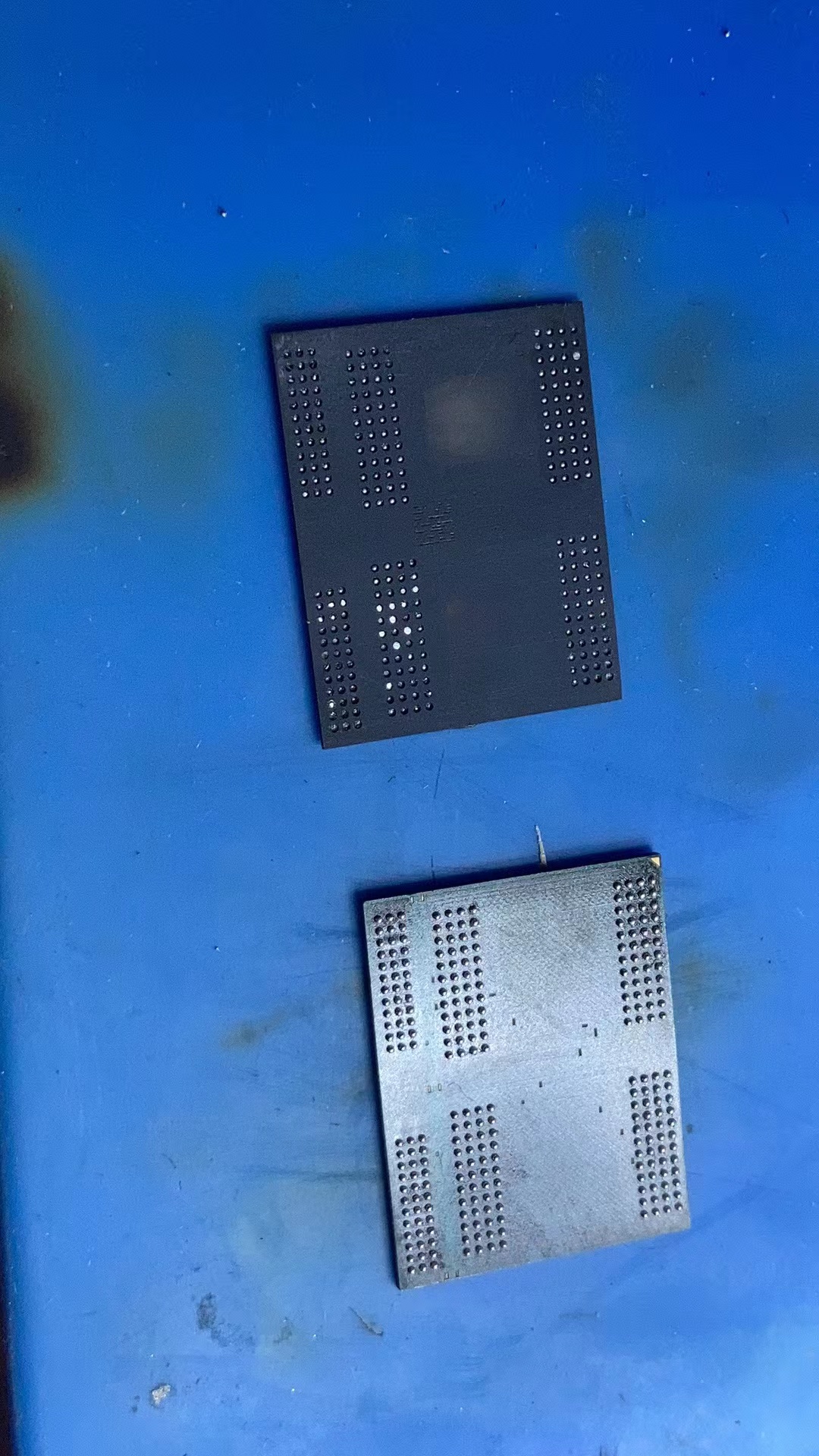

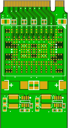

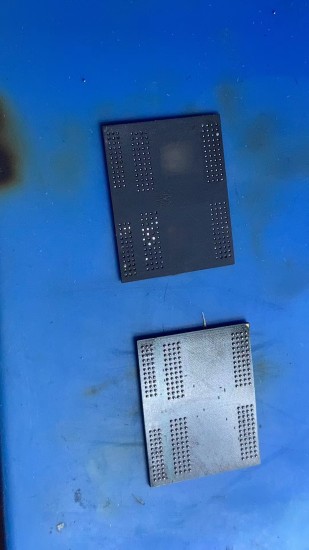

Make your own board, which has been tested and works fine. PCB thickness is 0.8MM! Gerber and BOM list are in the compressed package. Supported SSD manufacturers are: Toshiba and Intel.
If you have a Samsung or SK Hynix chip, please don't use it. It is recommended to buy a finished SSD to remove the chip and leave the circuit board for use.
pay attention! Samsung's chip package has a double-layer structure, and it is almost impossible to disassemble it perfectly with a heat gun. Please use an infrared heating table to assist in heating the bottom surface and adjust the correct temperature curve before implementing it. Once the chip is delaminated, it will be a tricky thing, I think 99% of the maintenance personnel will not be able to restore
