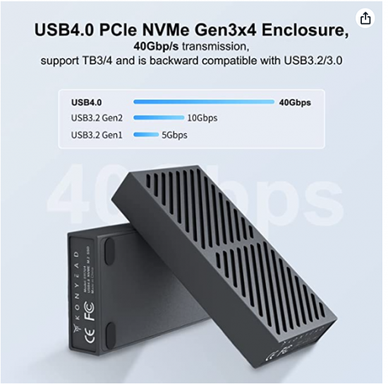

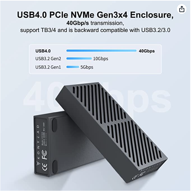

nvme SSD's are getting popular day by day.
While for proper diagnostic of SSD through electronic checking is needed, often for logical recovery & basic initial diagnostics USB casing is a must.
There are few threads in this regard which were helpful .I want to know whether there is any new chipset for nvme SSD's USB casings ?
Some casings available are for USB 4.0 but there are exorbitantly prices and little information is available for there practical use.
Can anyone suggest best chipsets & casings from Data recovery perspective. (both type C and USB)
