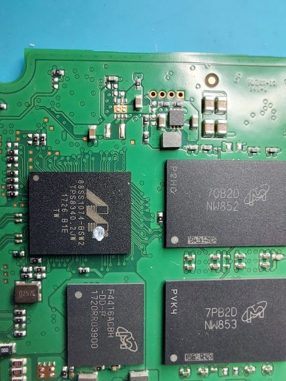

Check your model - is it SDSSDHII-960G ? If yes, there is Marvell 88SS1074-BSW2 - not supported yet by any hardware/software solution. Extracting data from this chip could be problem (I do not know anyone who did it). Probably you must wait for solution.

Maybe your drive has other controller, case which I had works on Marvell 88SS1074-BSW2.

I have a SDSSDHII-960G also with controller 88SS1074-BSW2 stays BSY in PC3K.
Also have a SDSSDHII-480G also with controller 88S1074-BSW2 with same issue.

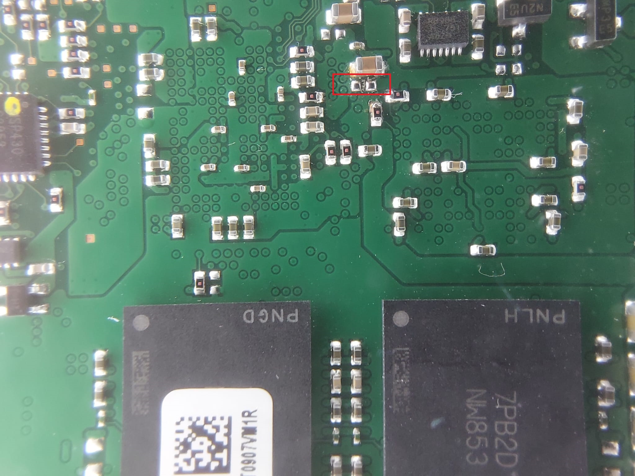

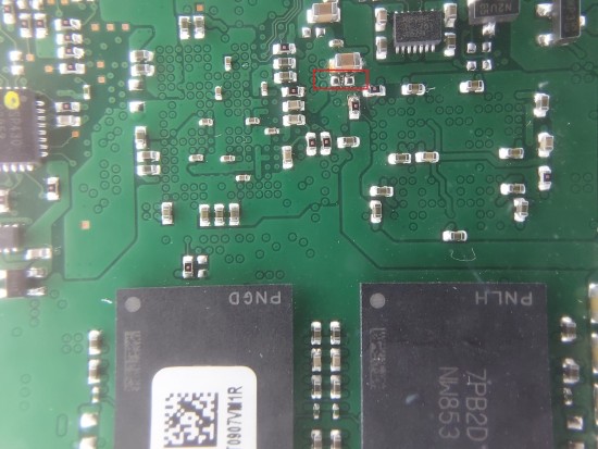

Carefully check all the capacitors, I found one in short circuit.
Greetings.
