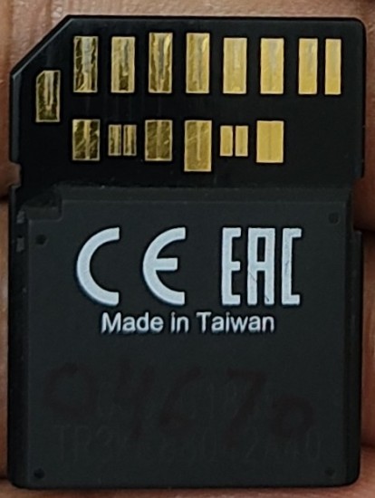

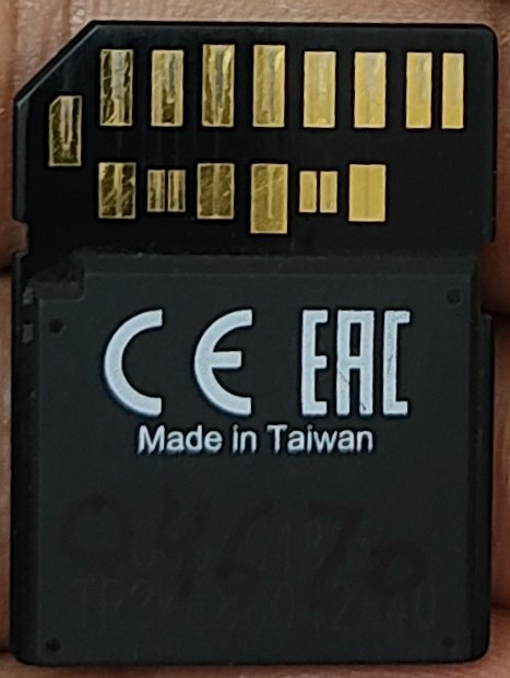

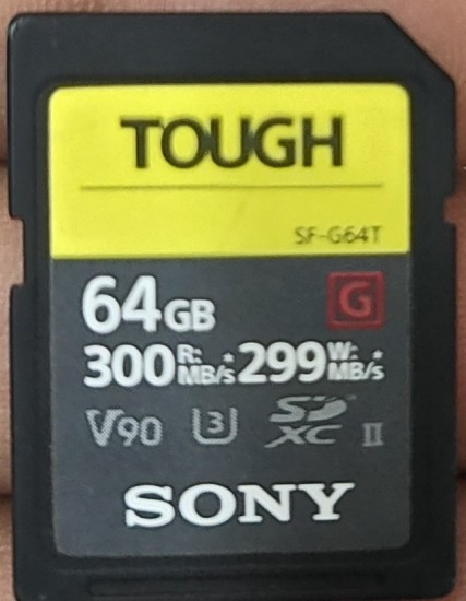

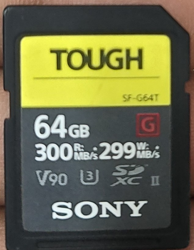

I have this Sony SD Card 64GB that the customer gave in for recovery .The sectors are all ZERO and i would like to preform a NAND recovery to see if i can recover data or not ,Problem is how to get access to NAND protocol in this card ,What to remove and were to probe .
Top Photo
CDRLabs - Case No 04670 Top [Sony 64GB Tough SD Card Data Recovery].jpg [ 165.39 KiB | Viewed 3440 times ]
Bottom Photo
CDRLabs - Case No 04670 Bottom [Sony 64GB Tough SD Card Data Recovery].jpg [ 129.64 KiB | Viewed 3440 times ]

http://www.flash-extractor.com/library/ ... 98_b3__1x4
Very hard to access to NAND protocol, this plastic housing is glued to SD PCB.
Probably 2K LDPC - good luck!

Hi ,
If Its LDPC no point in trying too ,I wonder when these vendors will have a solution for LDPC
