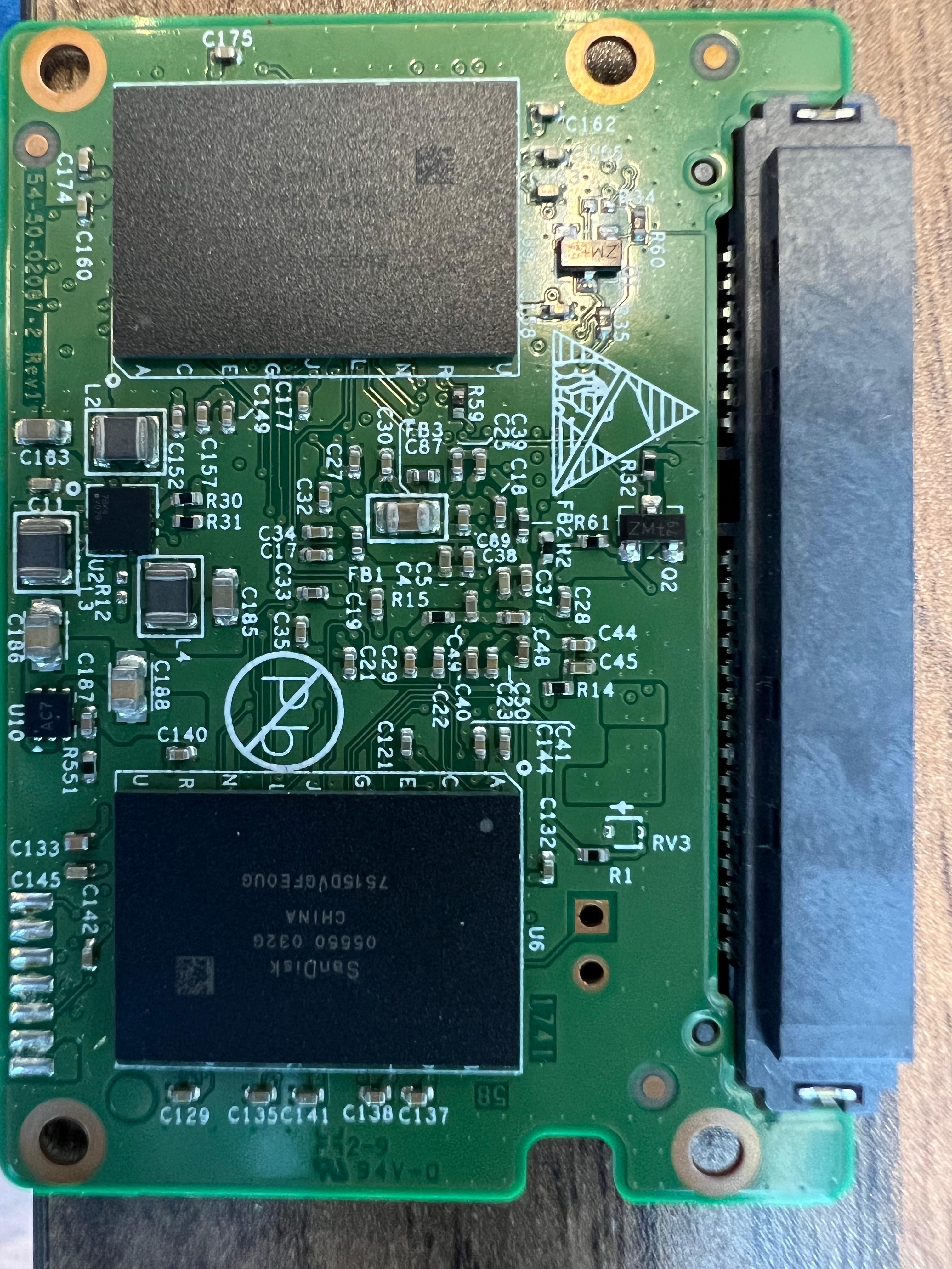

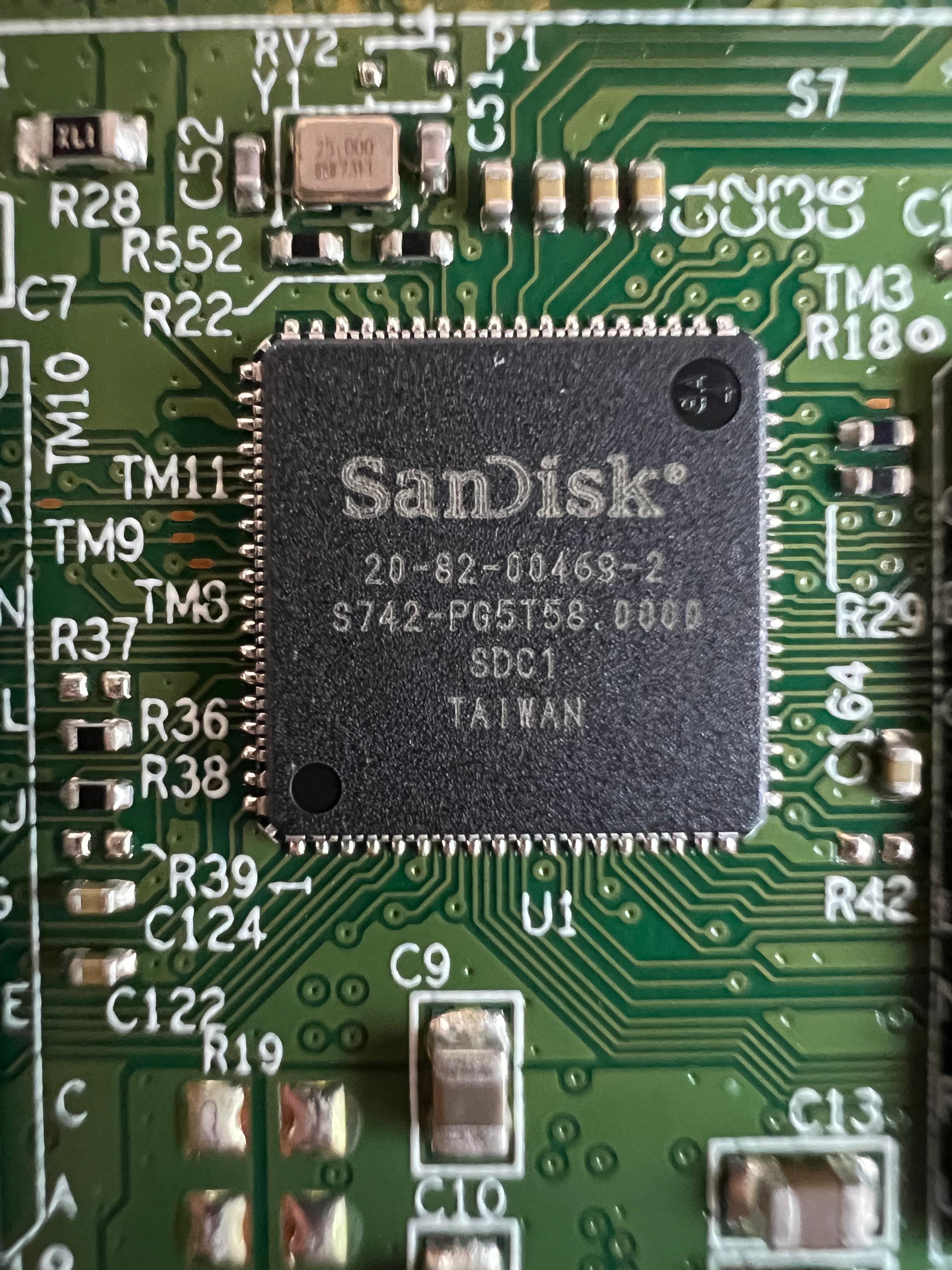

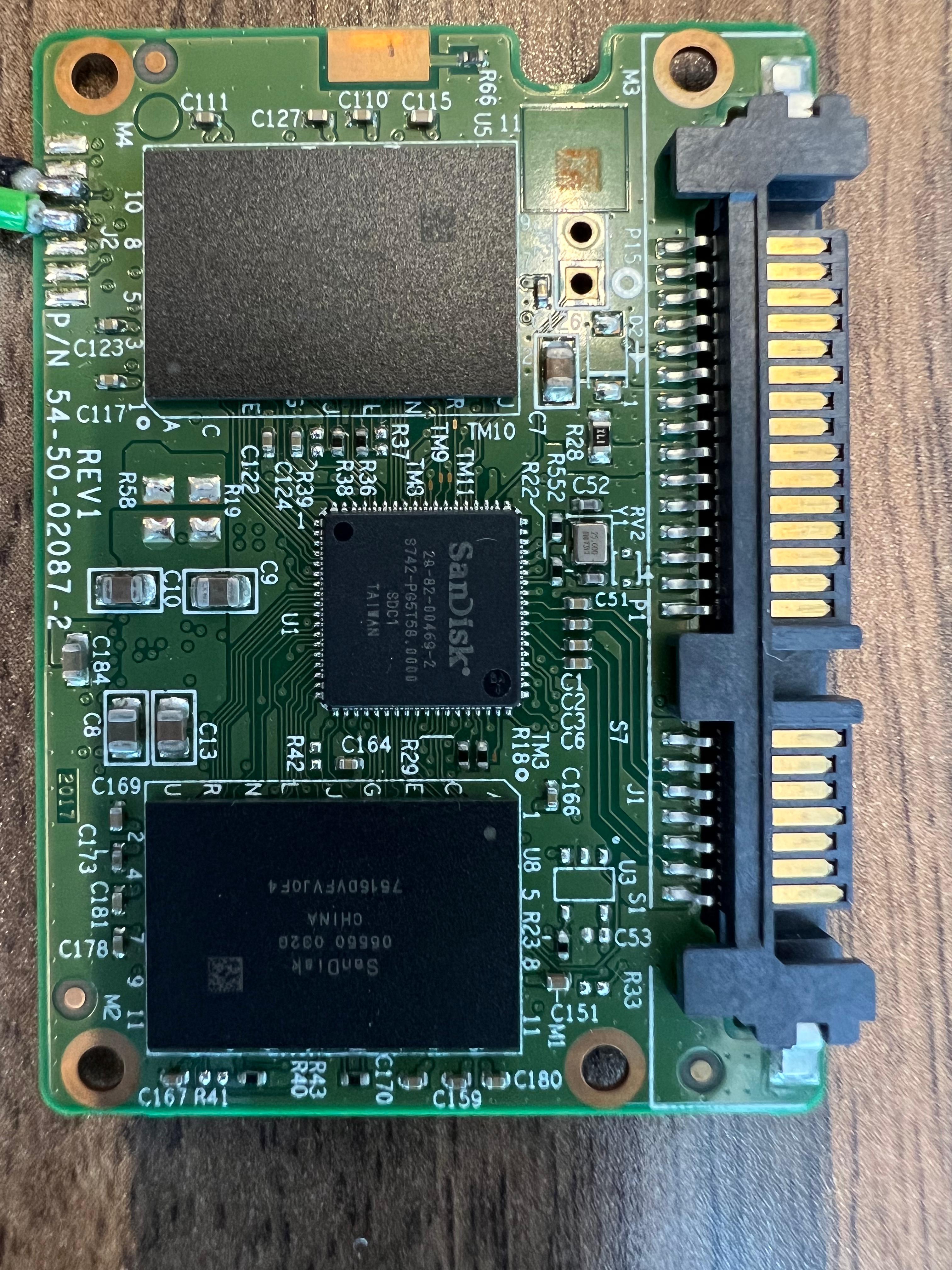

Hi Everyone,
I got the following drive:
Sandisk SSD PLUS 120GB
Model: SDSSDA-120G
Based on Sandisk controller please see the attached pictures.
Is this drive supported by PC3000 SSD?
 Post subject: Re: Is Supported? Sandisk plus 120GB based on Sandisk contro
PostPosted: June 15th, 2023, 10:09
Posts: 356
It is not supported. Only chip-off in FE or VNR.
odzyskiwanie danych
PostPosted: June 15th, 2023, 14:21
I Am Now Working On Several of these With older NAND ID's And New Too ,You can check my post in Rusolut Section .I do not know were you are based at but these SSD's need that those BGA 132 chips are removed and then read to recover data ,I can do this if you can send to india please .
