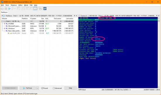

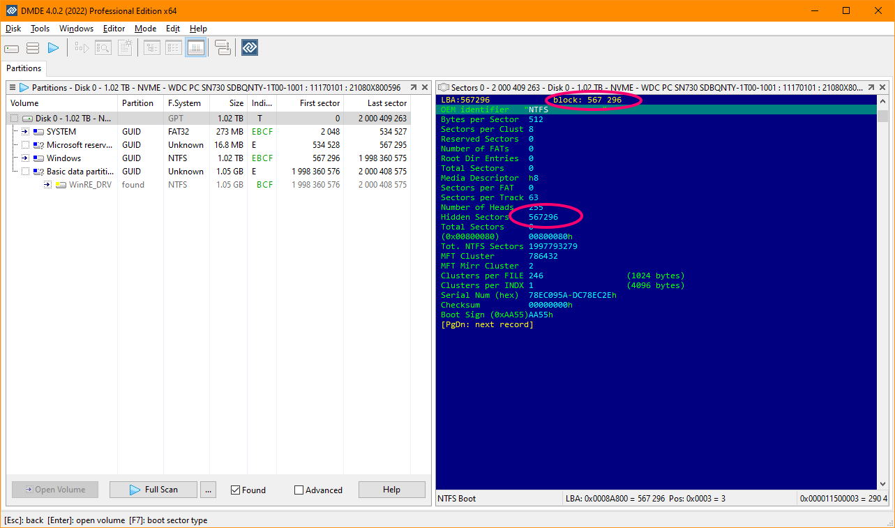

I'd look for boot records and check if they are where they 'pretend to be'. For example, here I use DMDE Special Sector Search ad ticked exFAT and NTFS boot sectors.
https://youtu.be/5RClVfg-uOk
Usually (but not always) hidden sector field will correspond with the LBA address at which the sector is detected. If they don't it may be a bogus find, to check you could double click in the editor field (blue in my example), accept values from boot sector and try open the volume. If it resolves to a valid volume the bootsector may be right.
Anyway, if a boot sector claims to be in sector nnnn, go back nnnn sectors and you should find yourself in the MBR.
If you can't find a single boot sector with hidden sectors that corresponds with the LBA address, translator issue perhaps?
