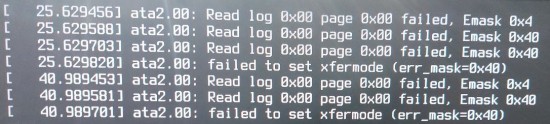

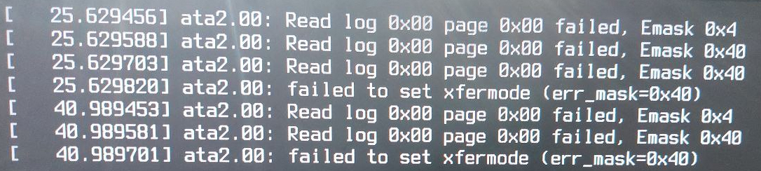

If you start Kali Linux, then immediately (without waiting for the system to boot) connect SATA, you get this error:

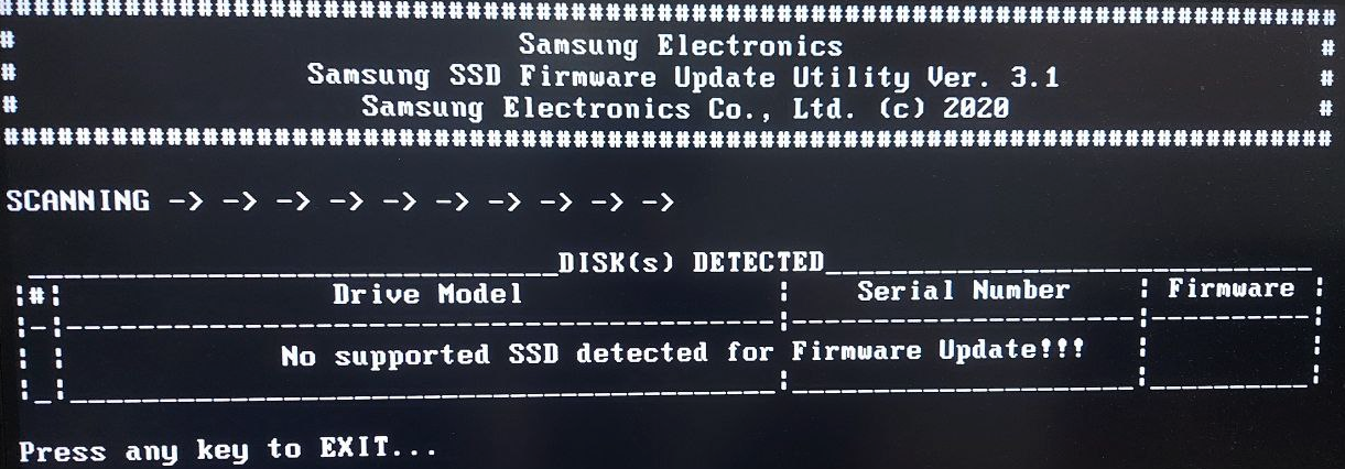

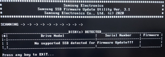

trying to reflash the disk gives me this:

It's failed. There's no support for these in pc3000 either so if it's already at the stage where access to the user area has been lost data recovery even professionally is very unlikely.
 Post subject: Re: How do you start a disk that won't start?
PostPosted: August 3rd, 2023, 19:53
Posts: 413
We can deal with some fw versions of that model but the drive must be sent to us.
If DR is not possible you will also loose warranty on it.
