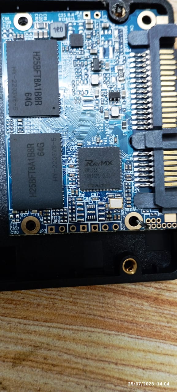

Hi
I have got a 256GB chinese SSD having RayMx MCU. Its not supported in portable. Is there any other solution available ?
Data is important and customer wants to recover it urgently

Wow,
This is another chinese CPU damn ,we just got support for 1 and i was of the opinion only one more is pending this is another one ,So now i see we have 2 unsupported once

The controller is a Realtek RTS5735.

Amarbir[CDR-Labs] wrote:
Wow,
Amarbir this controller is from EVM branded SSD's which are most popular here in india besides other cheap brands like Nextron for which support was not there (Maxio controller don't know current status).
These 2 are examples of older SATA platform. Don't know how many countless will be there for NVMe

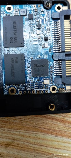

Wow fzabkar
You have identified right controller , you are great :good: :-D

If its What frank said then my counting reverts back to 1 not supported
