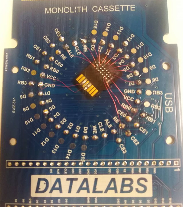

Forgive me for asking, consider me a noob in this area, but what is the difference between this tool (https://flash-matrix.com/) and just some database with pinouts and soldering the monolith like this?
Please explain what problem it solves other than the pinout. I think the better people understand your tool, the better the chance you sell some ;)
