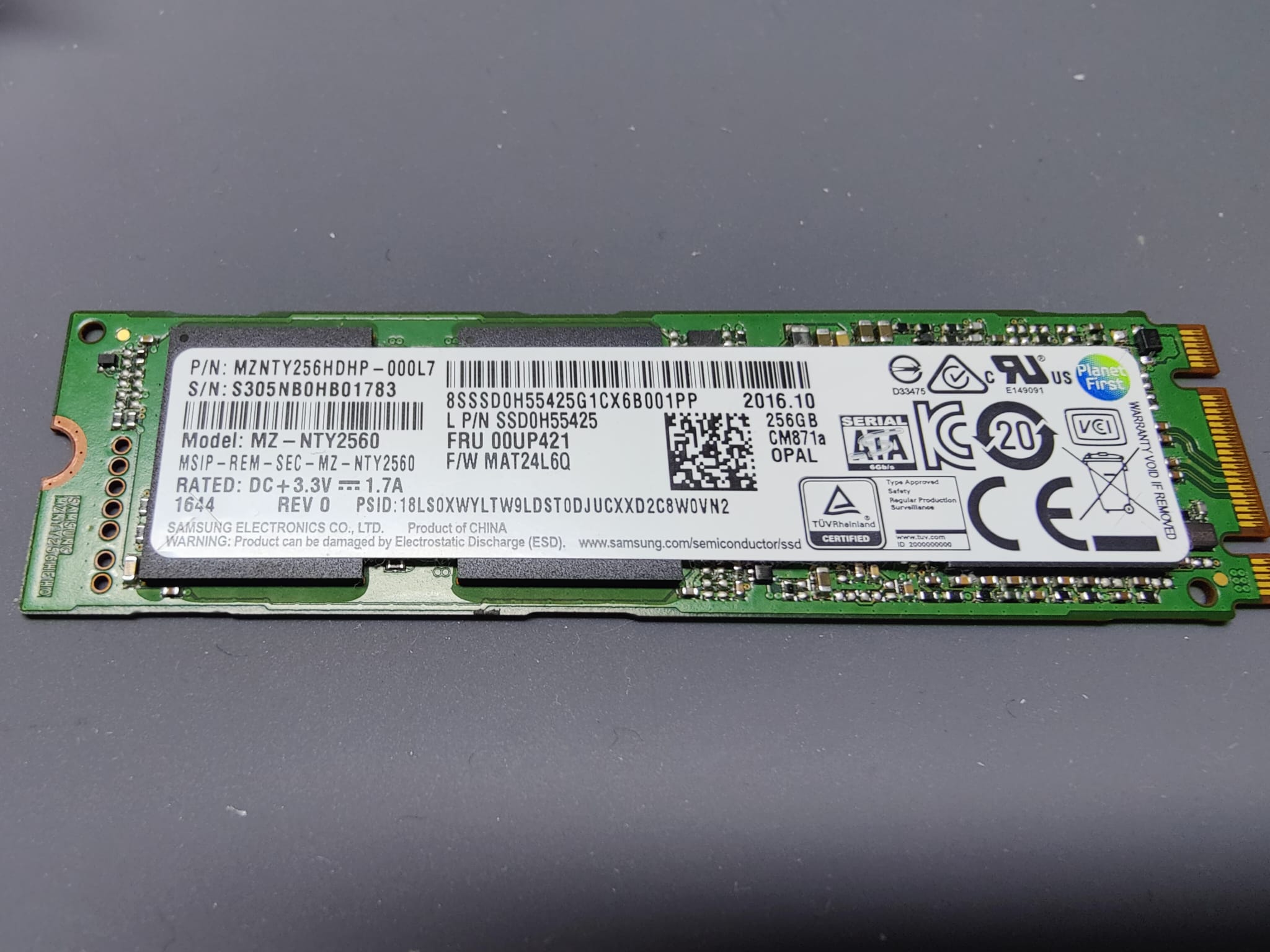

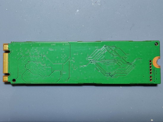

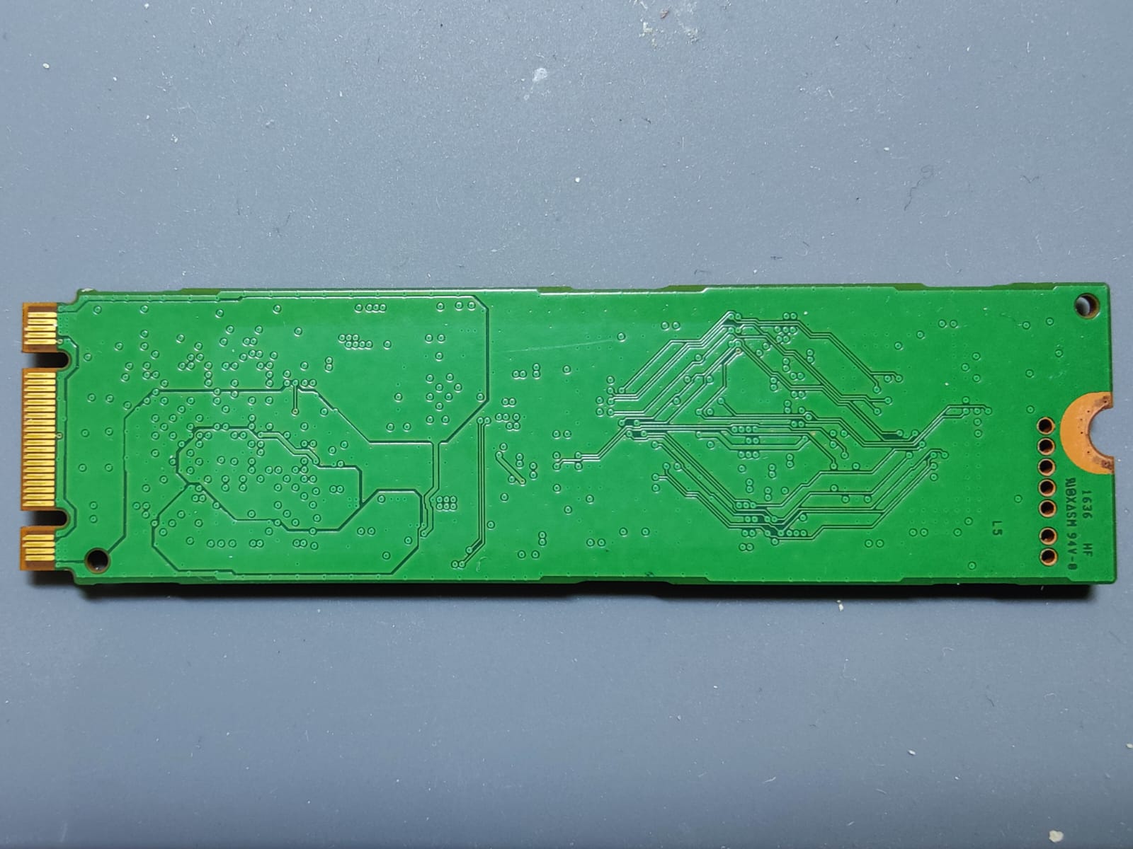

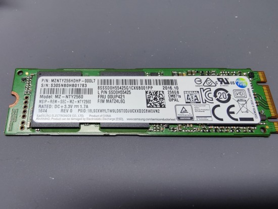

Hi all, I have this Samsung in. It looks to be BSY. I can see that it's supported by PC3K v 7.1 and above I think.
Can someone help please with confirming short points. I thought it would be lower2 on bottom left but that didn't work.
Many thanks
Louis

Actually, I just measured and the bulk of those pins are approx 1.3v, the closest to top is zero, so it may be at the other end. I'll guess I 'll try it later unless someone knows for sure.

i would vote for the bottom two.

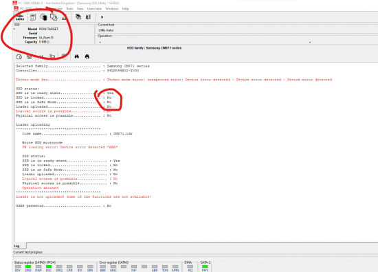

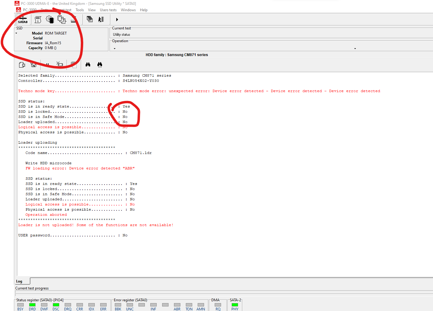

Multimeter was wrong or i need glasses.
from top
1) GND
2) NVALUE
3) 1.8v
4) 1.8V
5) 1.8V
6) 1.8V
7) 1.8v
can get drd dsc but not into safe mode when i short pin 7 to GND

yes, right, those pins are not for ROM mode, one of them is Vref on the bottom.
then idk where ROM mode pins are on this one, perhaps post a pic without label and the other side as well

Yes it does, but I think this model must be an outlier as the pins indicated do not work.
Beginning to think this is a non supported after all. CM871a, might not be the same CM871

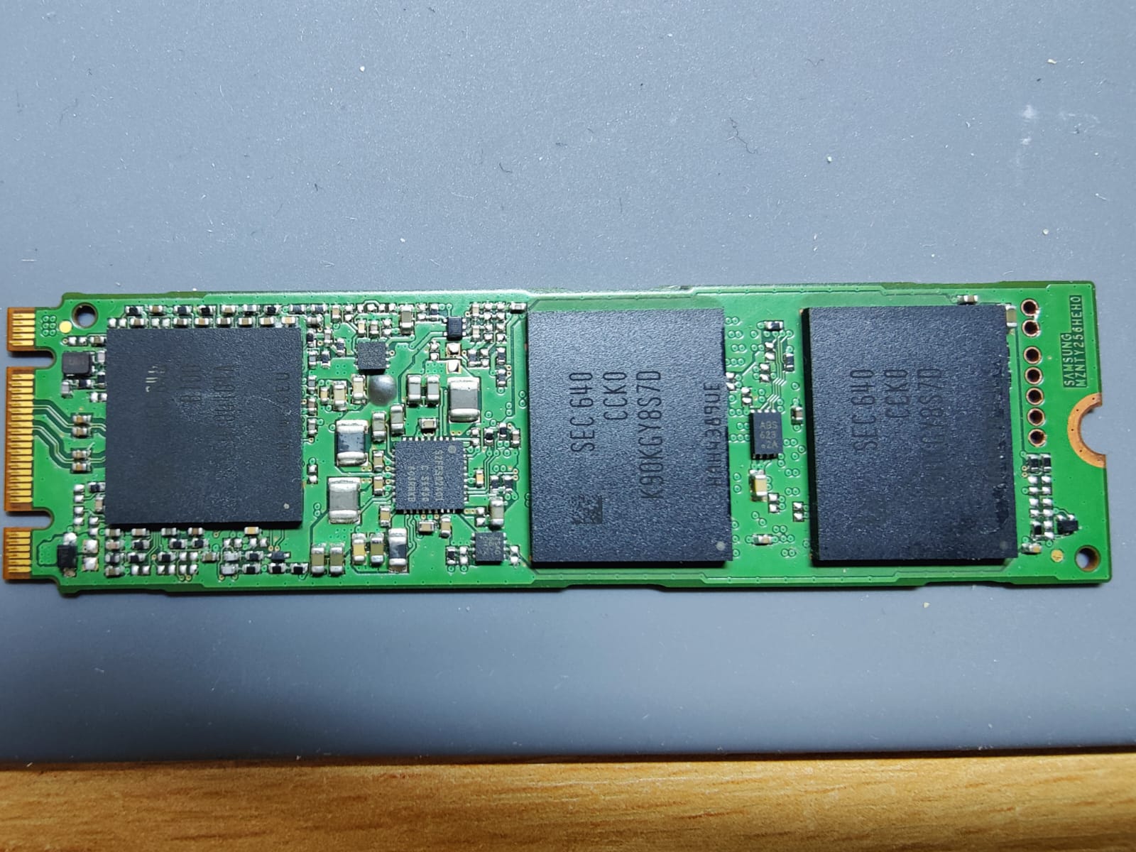

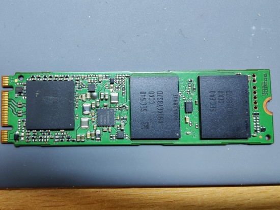

I was trying to find a spec for the Flash chip, but it looks like a Samsung proprietary. I was reading on Ace manual about finding Data pins to short but it's BGA and it's not going to be easy without a proper pin out.
Thanks for taking a look, but likely going to return this to customer as they are leaving for Germany shortly.

-000L7 is Lenovo, maybe they have behind their service/paywall specs. Unlikely, but who knows?
I dumped several datasheets https://files.hddguru.com/download/Datasheets/Samsung/ and maybe they contain the info you're searching on a similar model for this CM/PM871
