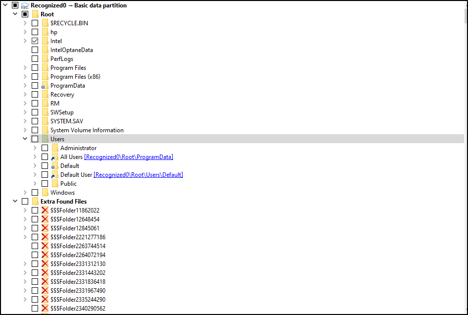

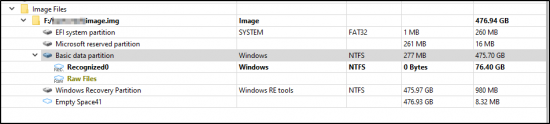

I created an image of a 512 GB NVME SSD using HDDsuperclone. When I scan the image using DMDE i can see files but it looks as if the drive was from a new windows install. All the dates are from 2019 when the computer was purchased. My family member stated the computer was working fine then was doing some update and when it rebooted it crashed. I asked if they did a restore or reimage and they stated no.
Is there a setting in DMDE that will find the missing files? Any suggestions greatly appreciated.

Are you looking at the recovery partition rather than the data partition

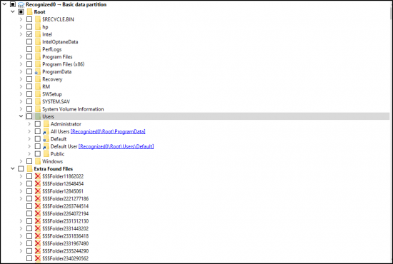

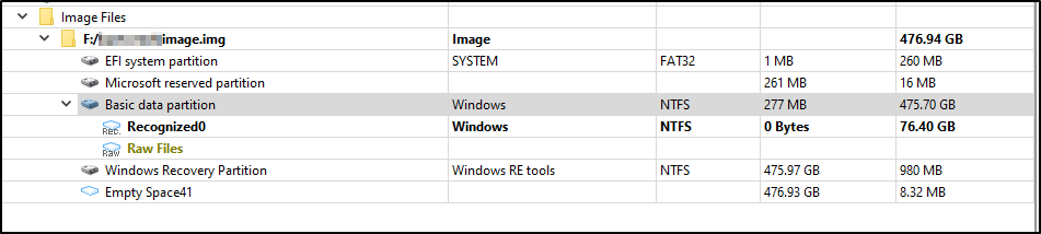

attached are Rstudio images of what i see. There are users profiles missing that i am trying to find.

From my experience this is a drive that has an Optane cache on it as well typically 32gb Optane cache/ 512gb SSD.
Either the Optane cache is bad/empty, or your computer cannot recognize Optane devices.
You can try and image it from the computer it came from and see if it recognizes the Optane cache.
You will need that Optane cache for recovery
