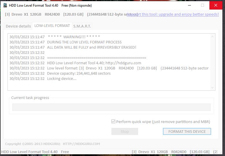

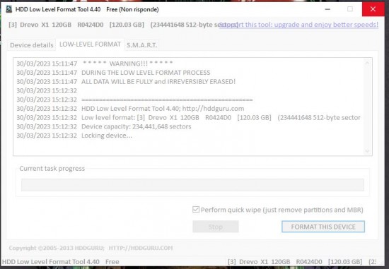

Hi guys!
I have some doubts before buying the software.
I'm trying to format my brother's 120GB Drevo X1 SSD that had the OS installed, and which appears to have bad sectors.
Basically the disk is detected in the bios, but by connecting it to the PC, the latter does not start, crashes etc.
I have now installed it in my pc to try and format it, of course my pc won't boot either.
By connecting the SSD once windows is started it is not detected in the windows disk management (indeed it freezes, or the service is not initialized at all), I also tried to use "diskpart" from a command prompt, but once diskpart was started the latter it won't let me type anything into the prompt, so I can't continue.
Now I downloaded the free version of HDD LLF, I connected SSD after windows start and apart from some problem that it causes, I managed to get it detected by HDD LLF.
Now, starting the formatting process however the program stops responding, so my question is;
Is this behavior normal? is the program still working?
I've read that the free version supports speeds of 50mbs, and a maximum of 180GB per hour.
I was considering purchasing the program, but I wouldn't want this SSD to be unrecoverable, and consequently send the program to block, so not even the paid version could be able to format it.
Thanks in advance,
Greetings

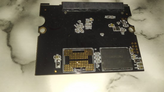

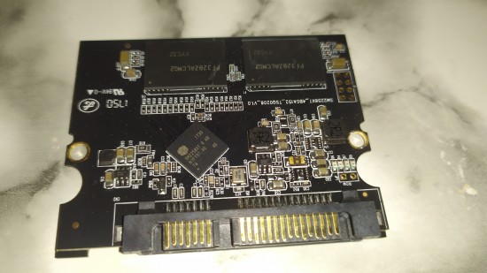

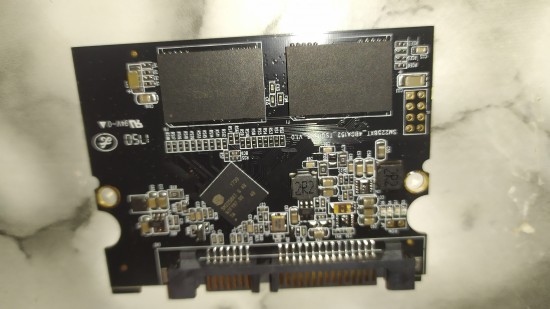

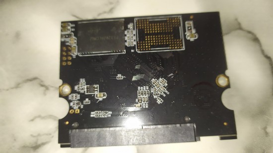

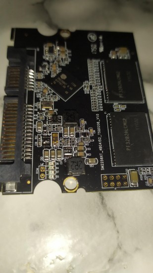

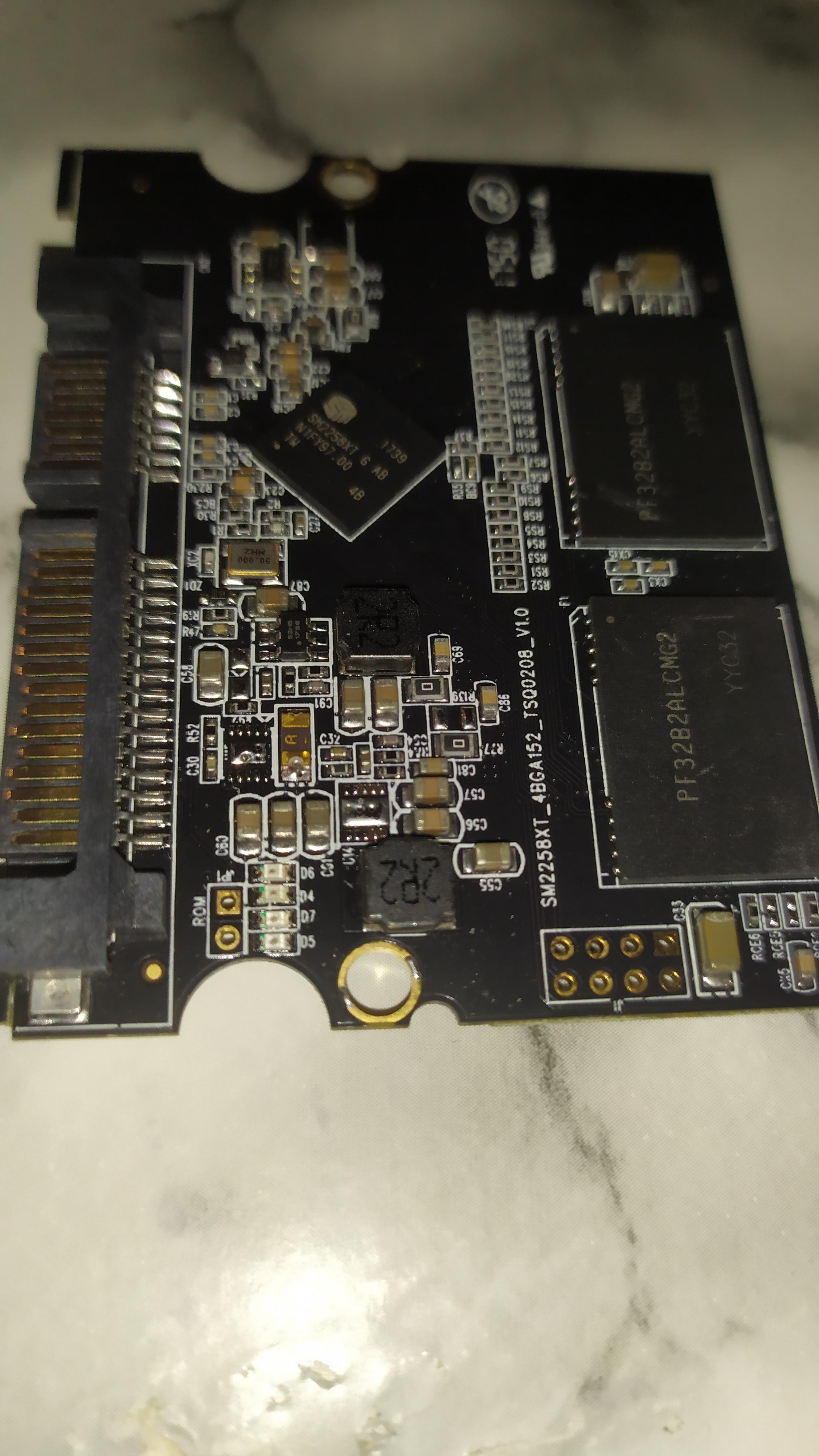

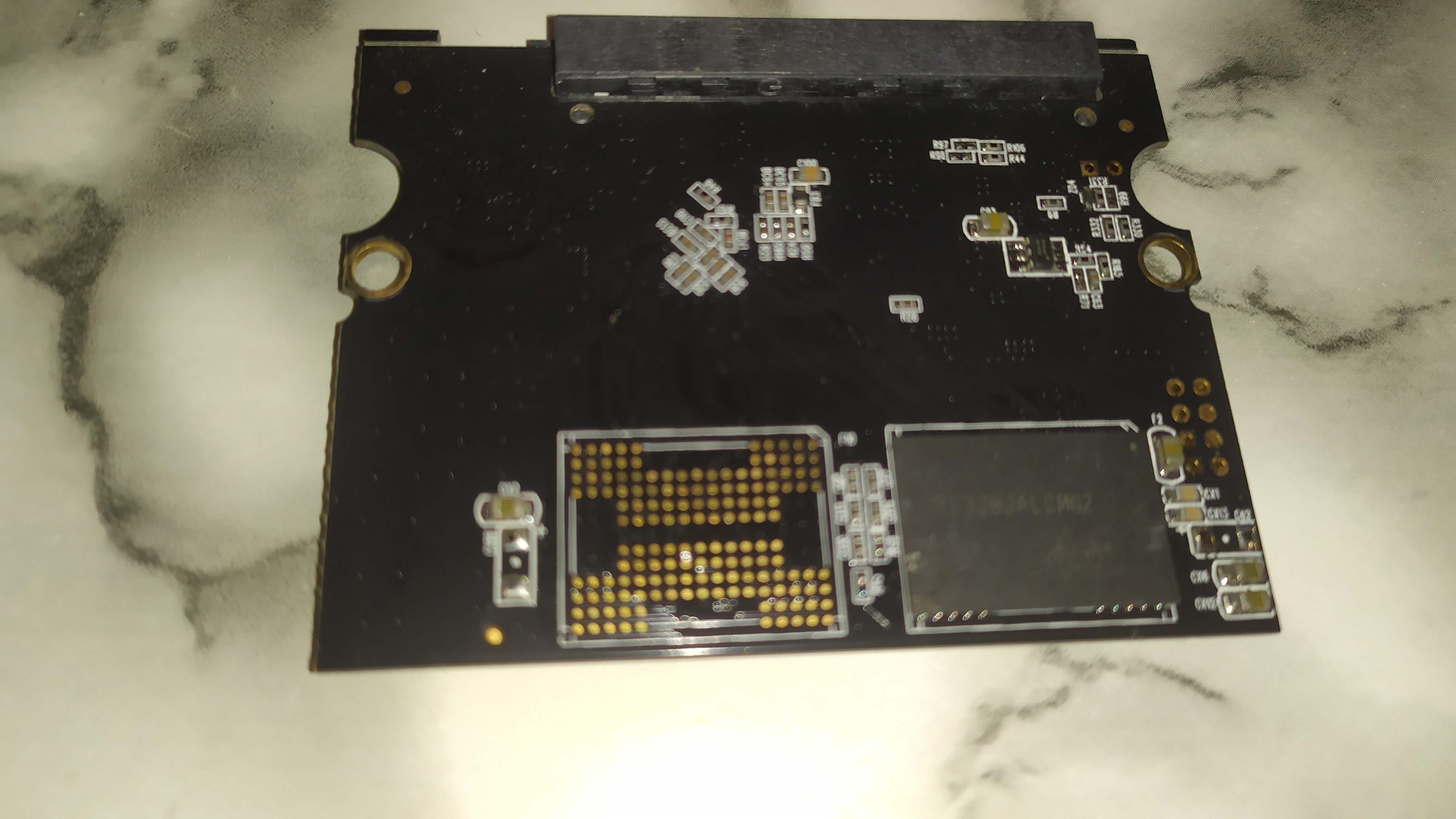

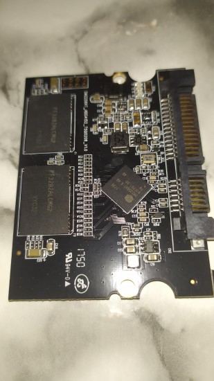

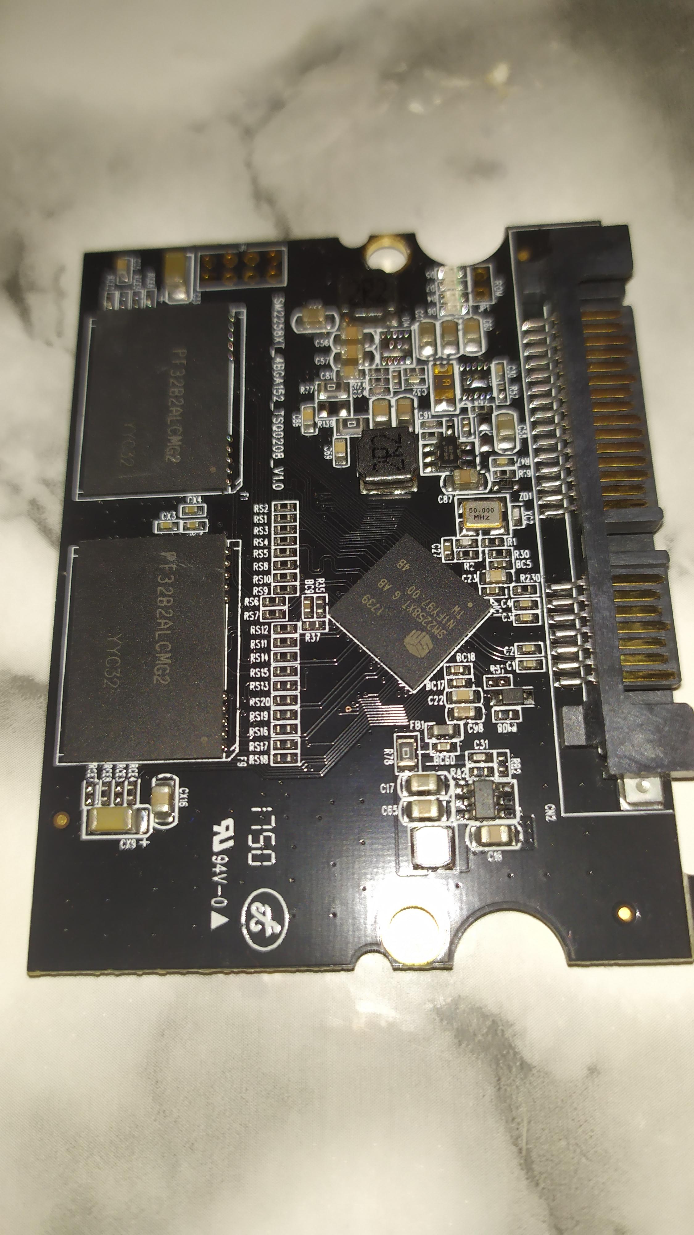

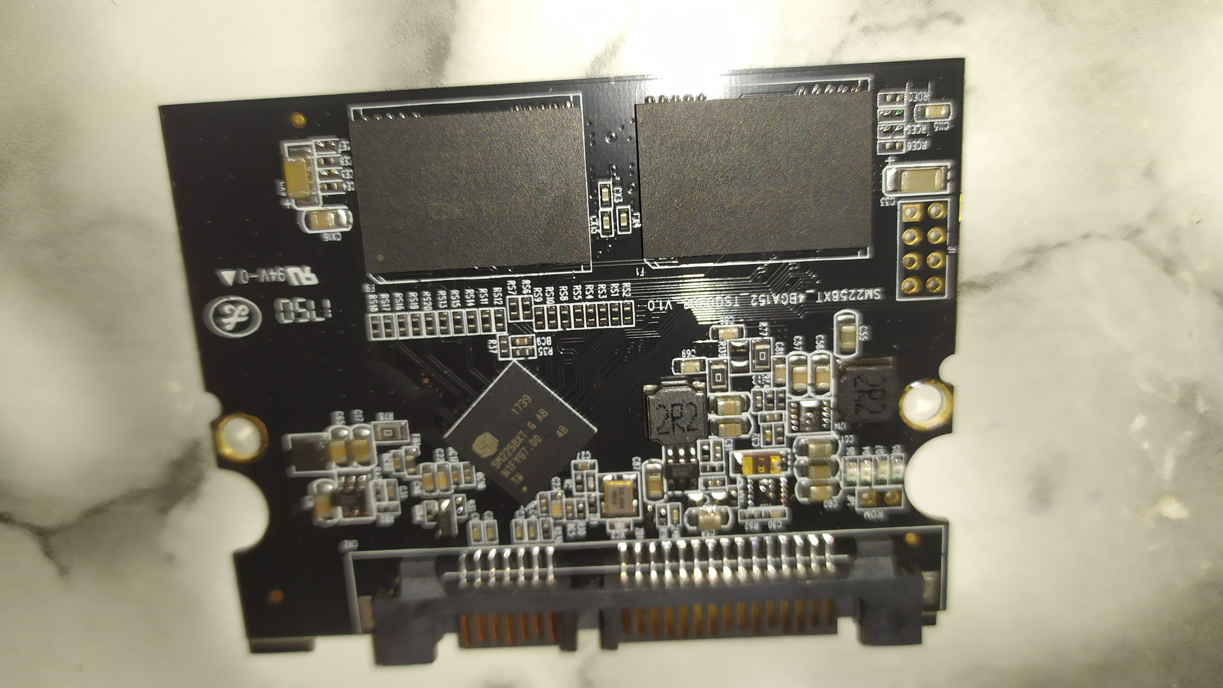

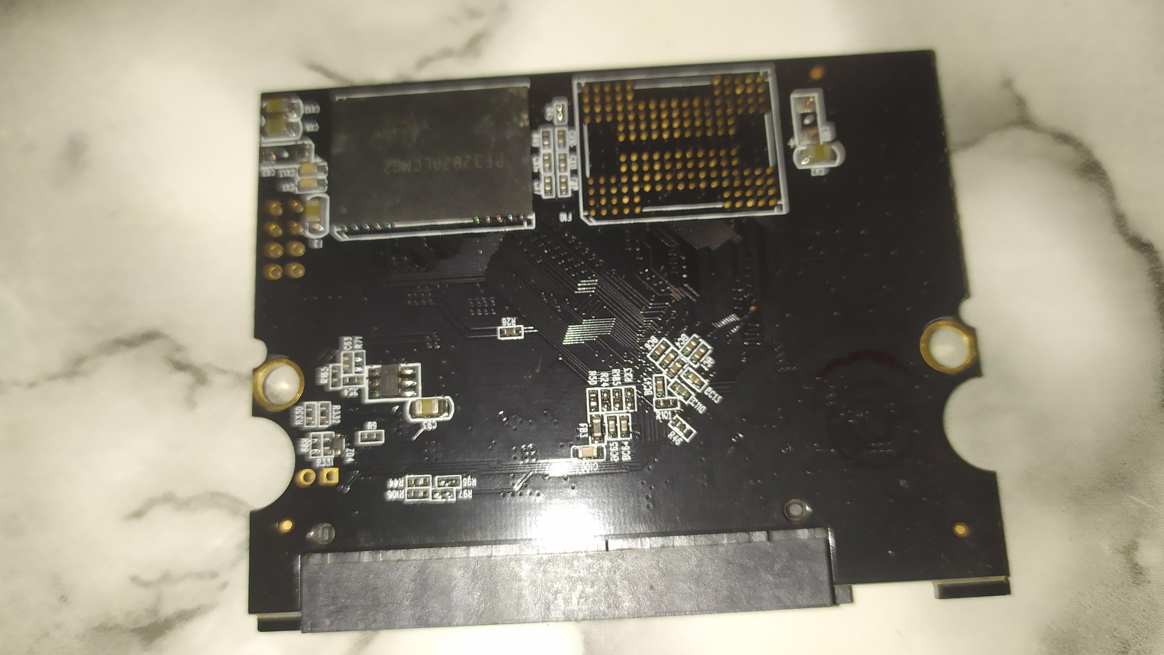

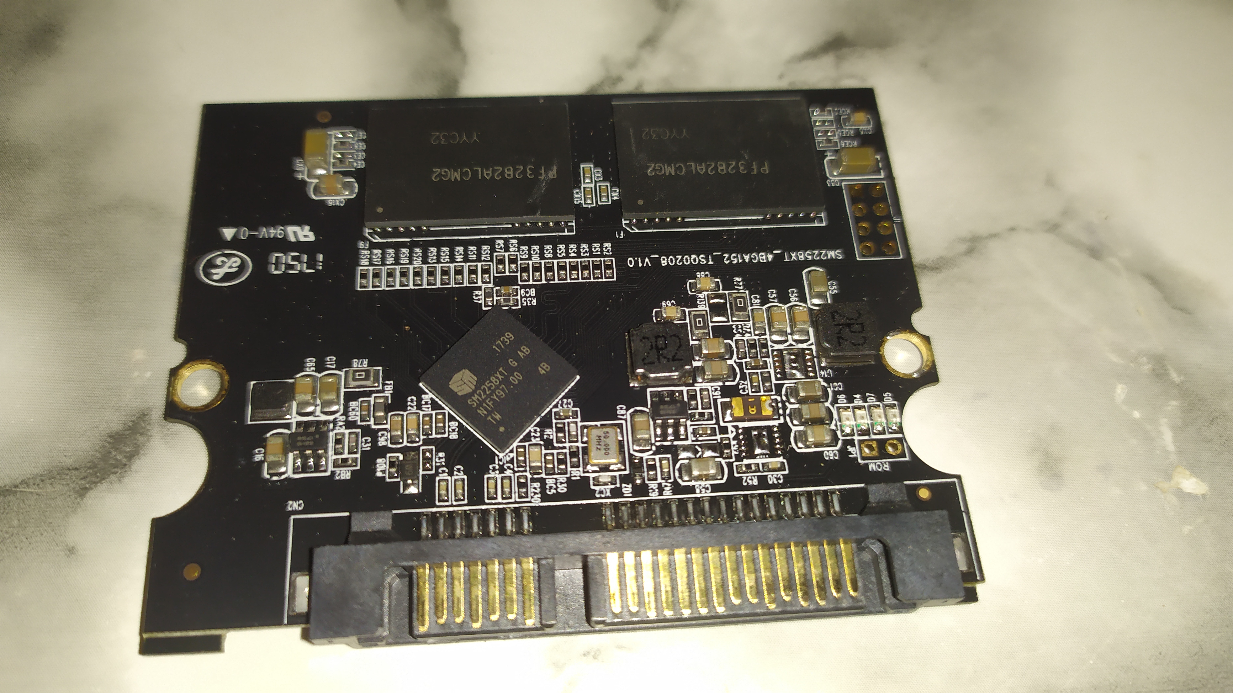

Before you throw it away, would you mind posting some hi-res photos of both sides of the PCB?
 Post subject: Re: Drevo X1 120GB - HDD LLF Question
PostPosted: March 31st, 2023, 14:41
Joined: March 30th, 2023, 9:38
Posts: 17
Location: Italia
Ok, here are the pics of both sides.
It was one of the first things I did initially, but I didn't seem to notice anything strange, but then again I'm not very experienced.
Thanks again mate!

"PF32B2ALCMG2" doesn't generate many hits in the search engines. I suspect that it's bottom-of-the-barrel junk NAND.
You could try to identify the actual NAND maker using the "SMI flash id" tool:
http://www.hddoracle.com/viewtopic.php?f=106&t=2819

In fact your NAND's part number, PF32B2ALCMG2, seems to be obscurely related to PF29F32B2ALCMG2 or 29F32B2ALCMG2 (PF = Pb Free = Lead Free). I'm wondering whether it's been scavenged from factory seconds. Those other part numbers are genuine Intel NAND.
https://electronics.stackexchange.com/questions/654384/help-identifying-flash-memory-chip

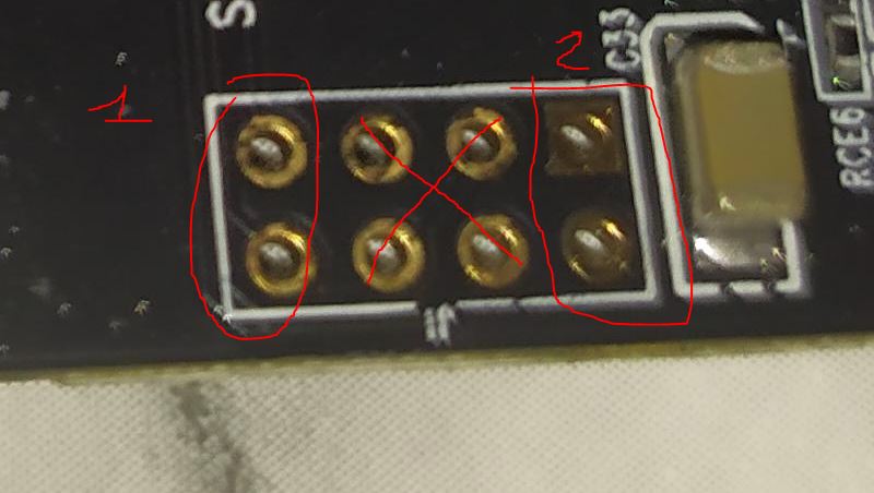

I tried to do the procedure to write the firmware but, there is no tool for NAND PF32B2ALCMG2.
As you said it seems closely related to "PF29XXXXXXX"
I tried to use "SMI MPTool SM2258XT Intel_B0KB P1116A", and it recognizes the ssd, but the firmware writing fails indicating errors; - Not MPISP Mode(1B)
- It is not ISP mode!!
The procedure is simple, put a jumper in the ROM holes on the card, connect it, open the tool edit config parameters choosing the flash, indicating the capacity in Gb etc, then save, remove the jumper and start the process.
As soon as I click on start after a couple of seconds the error "Not MPISP Mode(1B)" comes out
Actually there can be something as being different NAND models, even if as mentioned they would seem closely related to each other.
Also I noticed that the controller is 2258XT AB, while the tool is for 2258XT AD controllers, this could be the problem too I guess?!
Well honestly I can't figure it out!
It also seems strange to me that after doing the "secure erase" the situation didn't improve, and as if despite having been successful, the procedure still failed?!
However I am aware that the blocks will continue to worsen even if I manage to solve it, but temporarily it would be good to be able to bring it back to life!
Anyway sorry if I'm wasting your time, thanks for your patience and extreme availability, I really appreciate it my friend!

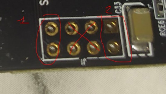

"ROM mode" and "ISP mode" are two different things.
http://www.hddoracle.com/viewtopic.php?f=46&t=3175
ISP = In-System Programming function for firmware upgrade
PostPosted: April 2nd, 2023, 16:28
Posts: 17
Location: Italia
I understand, but they say to jumper in the holes of the rom.
And in the videos I've seen they do this and it works.
I tried to locate the ISP holes as suggested by you, in reality I tried putting the jumper in all 8 (obviously not closing all 8 holes together, but trying 2 at a time) those that are on the card, but nothing.
on 1 and 2 as marked in the picture, the program not recognizes ssd when I scan drive, while where I marked the "X" the ssd is recognized normally from pc, and in any case by scanning drive in the program it stops responding.
I don't know, I think I'll give up at this point.
If you have any other suggestions fine, otherwise don't worry mate, you've done even more than you should have and I'm very grateful.
Greetings

Well, continuing to sift through the intricacies, and as far as I understand, this error "Not MPISP Mode (1B)
(0x1B): FW is not parked in MPISP mode after download MPISP code" I get from SMI MpTool is that the controller does not accept the unsigned service part of the firmware.
Some recommend trying a SATA to USB 3.0 adapter, but I doubt this will solve the problem, if I happen to find one I will definitely try.
But I think we can close the matter here.
Thank you so much fzabkar for your invaluable help, I appreciated it very much and I also got a little general knowledge on some aspects I didn't know, let's say you "acculturated" me ;)
I hope this thread can help someone who has a similar problem and can't figure it out.
