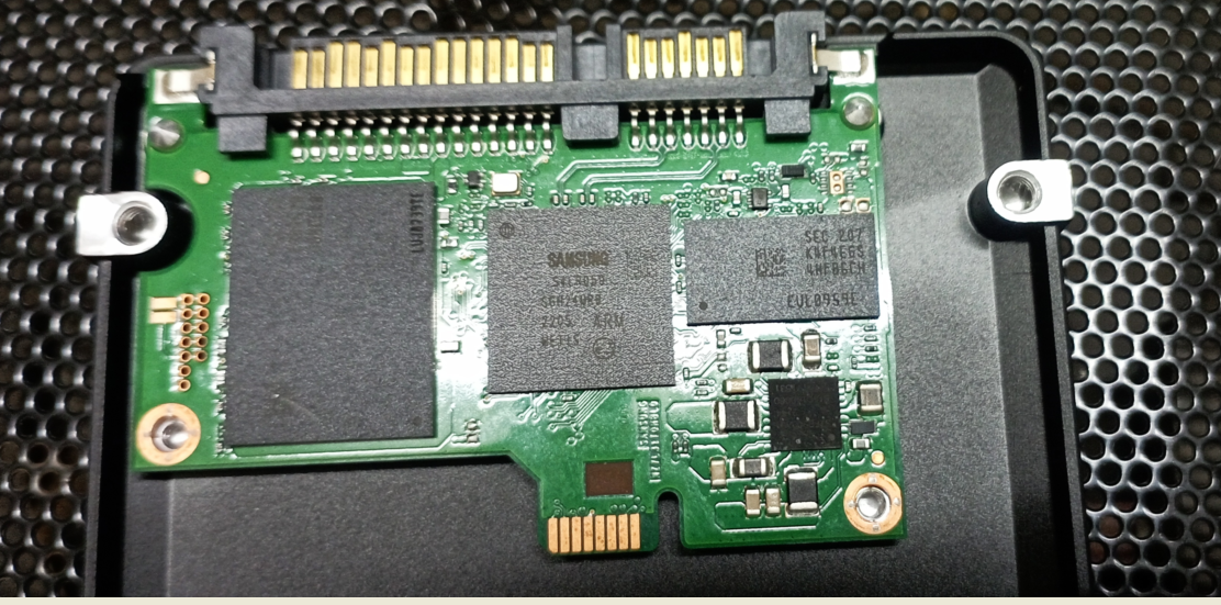

I have got a query for recovery from a dead samsung 870 EVO SATA SSD.
Customer has sent snap of MCU. I want to know whether its supported by pc3000 portable or not.
Thank you
Samsung 870 EVO SATA 500GB
samsung S4LR059
SGH24MR8
2205 ARM

 Post subject: Re: Samsung 870 EVO MCU support
PostPosted: April 24th, 2024, 6:37
Posts: 1319
https://blog.acelab.eu.com/pc-3000-ssd- ... dated.html

Lardman wrote:
https://blog.acelab.eu.com/pc-3000-ssd-list-of-supported-ssd-drives-regularly-updated.html
Thanks . Its not in the list but anyone has luck using portable ?

I have got SSD & I have checked it on pc3000 udma (I don't have portable & I outsource my work )
SSD stays busy but does not show up typical shorted registers when there is clear electronic issue like short.
But I would like to trace various voltages to confirm the same.
Can someone pls. guide how I can begin using a multimeter ? ( Here I am referring to our own living electronics wikipidia fzabkar who is been immense help when it comes to electronics , I am amazed by his knowledge of the subject & his helping nature. Appreciate it. :-D :good: )
Once its confirmed that all electronics is fine then issue could be in firmware MCU or Nand itself , I can update customer accordingly.
Thank you
PostPosted: April 25th, 2024, 13:16
Posts: 17323
Zero Alpha walks you through some Samsung SSD videos on his Youtube channel.
PostPosted: May 3rd, 2024, 2:38
Joined: May 30th, 2014, 0:54
Posts: 153
Location: Universe
If MCU is not supported by Ace then possibly no one in the world except samsung can recover data unfortunately
