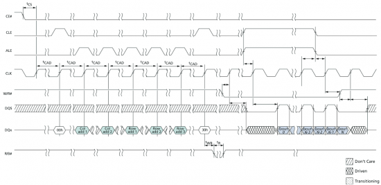

Has anyone ever tried to read the NAND memory which works in Source Synchronous mode by default? I have a pendrive that has an additional CLK clock that is used for synchronous communication, but the controller seems to work asynchronously. In the onfi 2.0 specification, page 42, there is a procedure that allows reading synchronous memory using an asynchronous controller. VNR, PC3K do not support this, can it be read with something else?

To read NAND ofcourse. I assume this is happening because on the logic analyzer I can see that the communication is asynchronous, but VNR, PC3000 and FE cannot even read the ID. Controller is classic PS2251-7-V but with crystal oscillator connected to NAND that generate CLK signal.
There is option to change interface using "Timing Mode" but available NAND readers can't do it.
Need extra CLK and DQS to do this.

I do not see such a need. CLK signal is generated independently using any square wave source. I have one simple idea: WE/RE = HIGH during command and address latch enable for Set Features Timing mode from sync to async (we no need WE for write all this is drive by CLK) and after that back WE/RE to default states (async interface) - DQS also no needed.

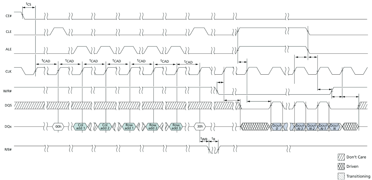

To get square wave form OSC I think some like this:
