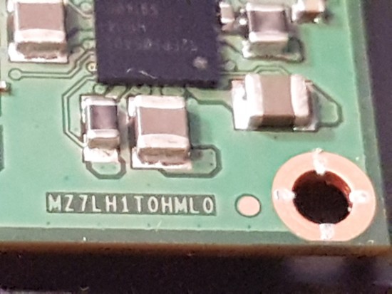

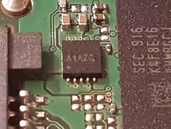

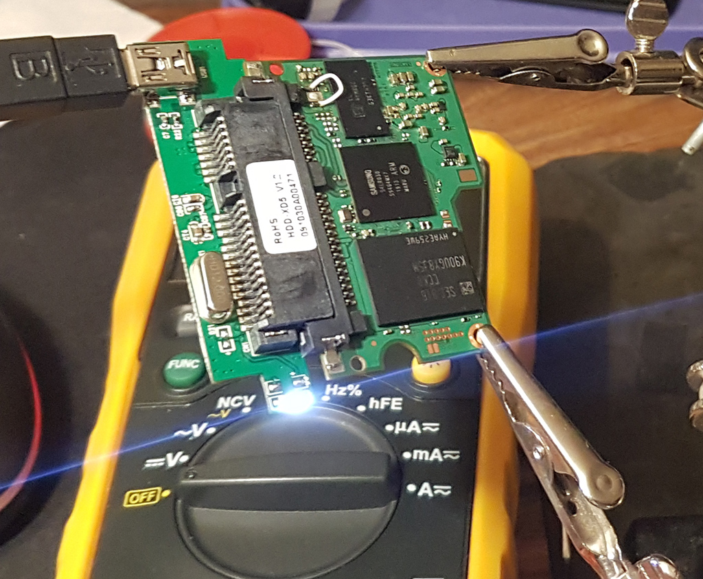

I have a Samsung 860 Evo 1TB SATA drive (model MZ7LH1T0HMLU) which is not seen by the BIOS. I was hot plugging some test HDDs to an eSata connector, and while doing a read test on another drive, the Samsung went offline. No damage was done to the other drive, but the 860 Evo does not appear now at all. The usual diagnosis steps (try different cable, try different PC, etc) did not help. Drive is not recognized in anything.

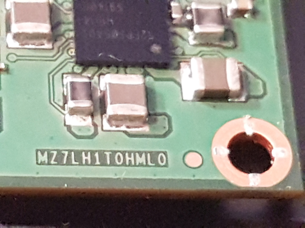

Upon disassembling, I saw a board marked as MZ7LH1T0HML0. The layout is very close if not the same as every other teardown you can see online - for ex. https://tpucdn.com/ssd-specs/images/d/12-pcb-front.jpg. Visual inspection of the components did not show any damage.
With the power off, I measured all the SMD capacitors and none of them looked shorted (none had continuity between the two ends, all measured to have some resistance).
With power on (using a usb2.0 to SATA external connector I had at hand), I was reluctant to do much measurements due to how small the components are. One important thing that stood out was two components getting hot: one was the DRAM chip, which got very warm to the touch, but I suppose this is normal. The other was the e-fuse right next to the DRAM (small rectangular 10-pin chip) which was BURNING hot and I could not touch it for more than a second. Due to the extreme heat given off by the e-fuse, I'm thinking that it is the culprit.
I read in another thread that it is possible to just bridge the voltage input and output pins of the e-fuse to get the drive working "with some caveats", if this works the first thing I'd do is a full backup, so if it can give 2-3 more hours of life to the drive, that would be all I need.
So, my questions are:
- what else can and should I do to get a more accurate diagnosis?
- could there be something else broken, or is it most likely the e-fuse? I did not measure any shorts on any of the caps.
- if it is the e-fuse, should I remove it before bridging the Vin and Vout pins, or can I leave it in place and bridge it that way? Obviously I'd route the bridge cable so it goes around the chip, to avoid the heat.
My last backup of this drive is over a year old (yes, I'm stupid), so I'd really like it if it was possible to restore the data. It's not terribly important data, but restoring it would be very annoying and take a while.
Attached pics of the board serial and the e-fuse, they are crappy phone pics, I'll make some proper pics soon.

Without power to the drive, check the power rails for a short to ground. Both the main vcc to pre and post the fuse, then check the individual rails from the pmic to see if any of those are shorted. If your fuse is shorted it will need to be removed and either replaced or jumped.

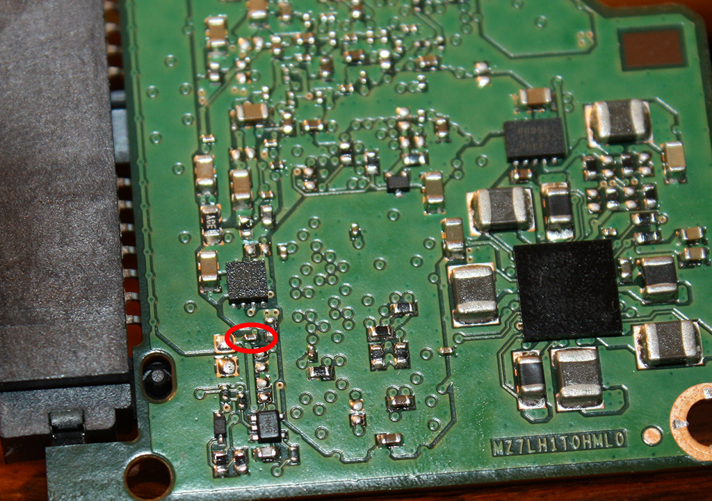

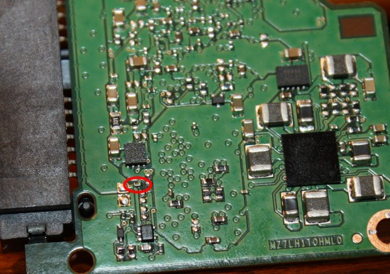

Yeah, 5V and Ground on the SATA power pins seem to be shorted. The other power input lines look fine. Vout on the e-fuse is not shorted, just the three Vin lines.
I tried to take some detailed photos, but it is very difficult to do so due to the small size of the board. Here they are:
https://postimg.cc/gallery/bqFMb2G
The PMIC is the RB990, right? It is very difficult to test since it is close to other components and there's less space than where my multimeter tip can fit. Pin 2 seems to be grounded but I could just be accidentally touching the ground end of the cap (?) right next to it. Pins 6 and 7 seem to connect to ground, but according to the pinout these are meant to be grounded anyway, and pin 2 is meant to be NC, so it doesn't look like there's a problem there.
There seems to be a very small cap (?) that seems to be problematic, see the attached picture. It has continuity but measures 20 ohms resistance. But one end seems to be connected to the +5V straight from the SATA pins, so this could be a consequence of the short, not the cause. The via on the other end of the cap might be leading to the e-fuse Vin on the other side (extremely hard to tell as not all vias line up, but it looks like the other end is the slightly copper colored via on the e-fuse pin 2).
 Post subject: Re: Samsung 860 Evo 1TB not seen by BIOS
PostPosted: September 3rd, 2023, 10:25
Posts: 1312
pmic is s2fpS05A01 - big square chip shown in your first post second image surrounded by inductors. Check at the inductors for shorts. Don't worry about the cap you've highlighted it's connected to +5v VCC.

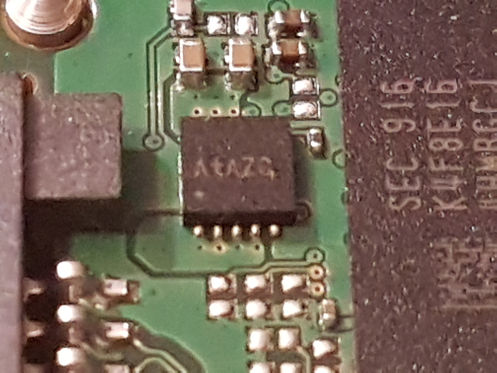

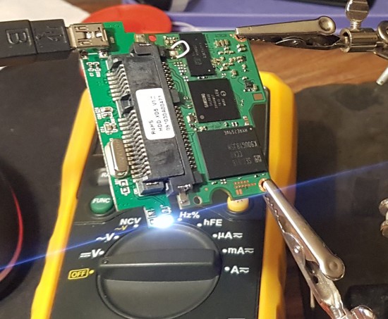

Wish I had that good driving skills. Actually, I don't have any driving skills. And I can barely see the pcb I soldered to, but fortunately there were 3 pins on each side, so I could afford to be less precise.
Had to clean up the leftover solder blob from the middle pad, which was grounded and ended up connected to the Vout pins - if, for no other reason, than because it looked like it tore the pins off the PCB... After double checking for shorts, then soldering both ends of that tiny bridge wire, then double checking for any shorts... and the drive works! Already put it back in its case and imaging it to my network array at ~300MB/s, plus a secondary offline backup that will act as a hot swap until I get a new drive. It's looking good!
This is twice I had to ask for help on this forum and twice I managed to recover my data. Thank you so much for the help, though I wish that next time I visit it will be under less stressful circumstances.
