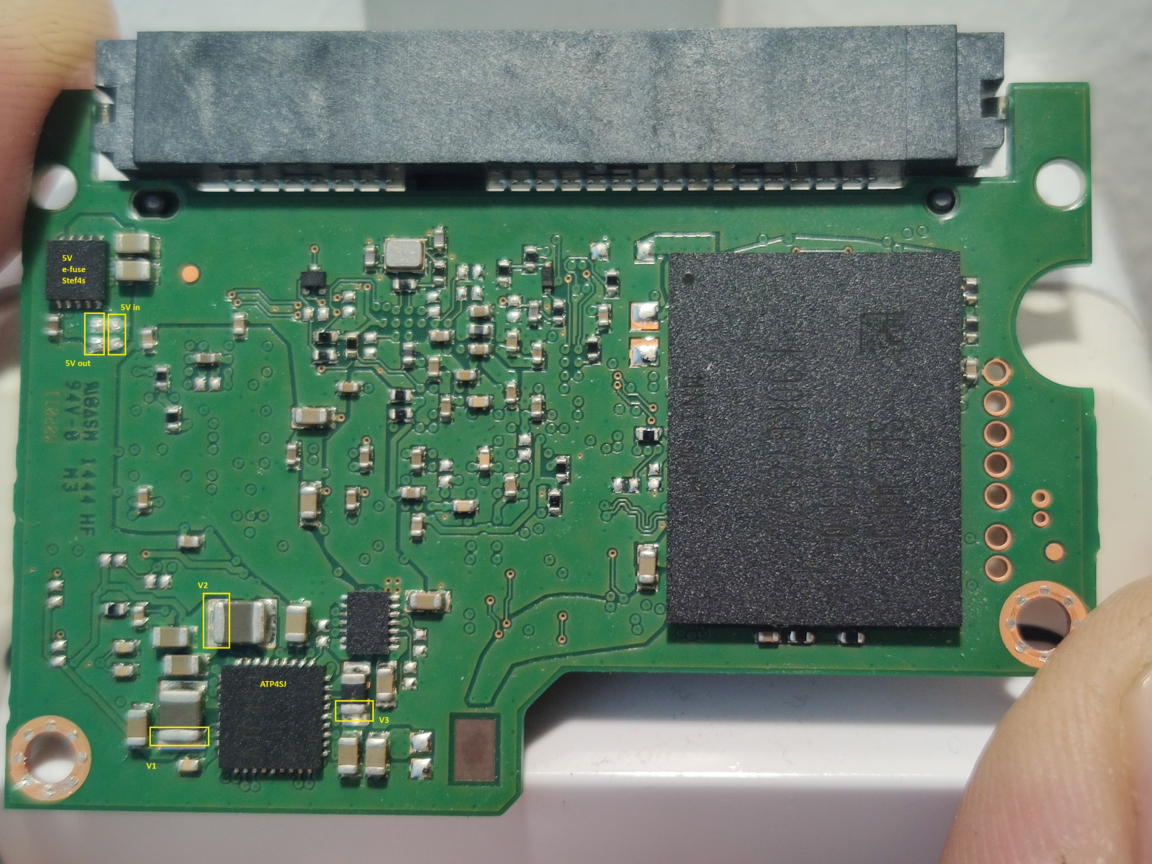

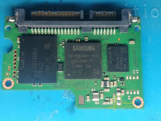

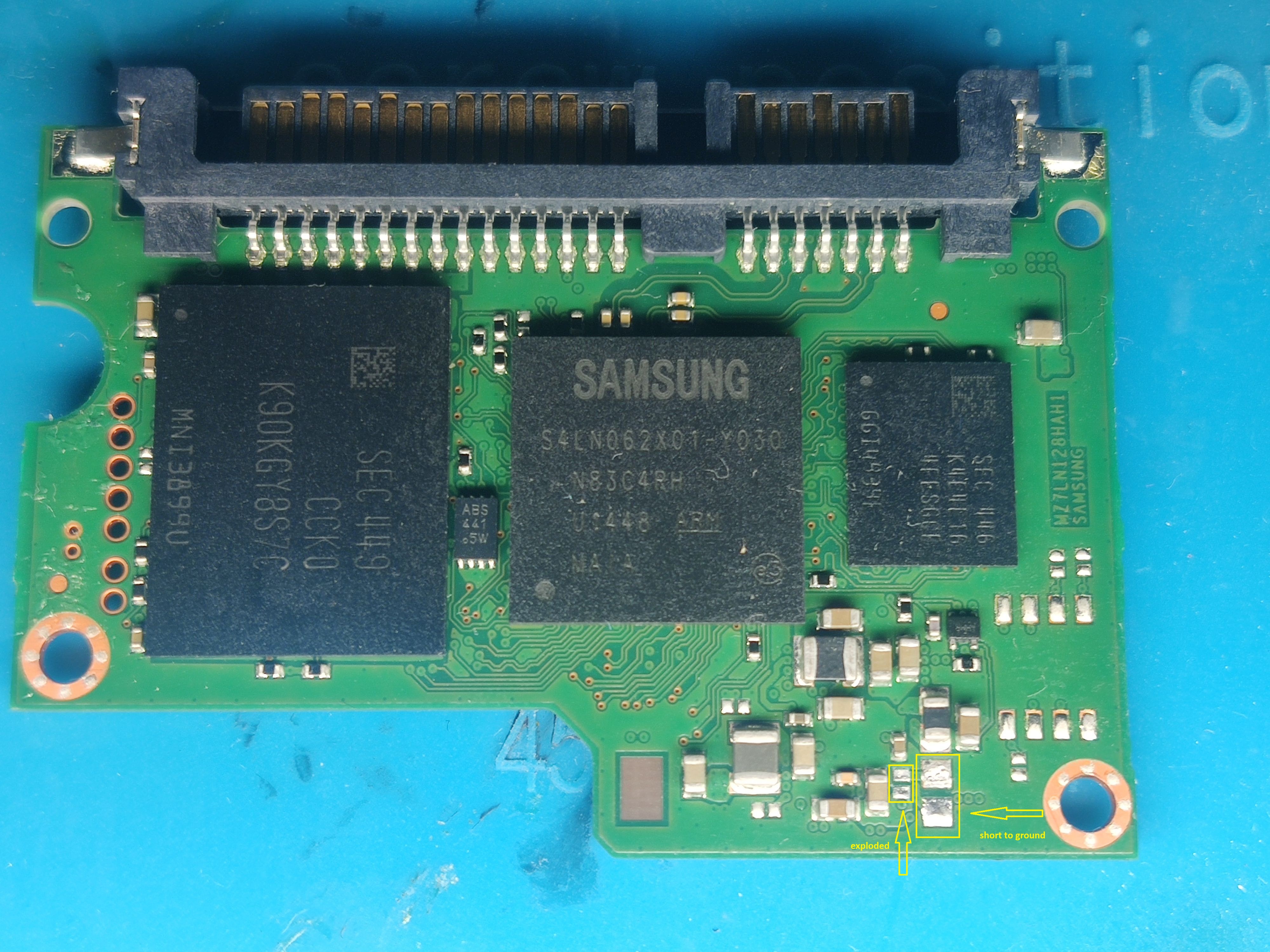

Hello.
I've seen a lot of forum topics about this Samsung EVO 850 250Gb, but unfortunate nothing close to my problem.
The drive worked smoothly until the very end. The laptop stood running overnight, but unfortunately in the morning I found a message that the system disk was missing.

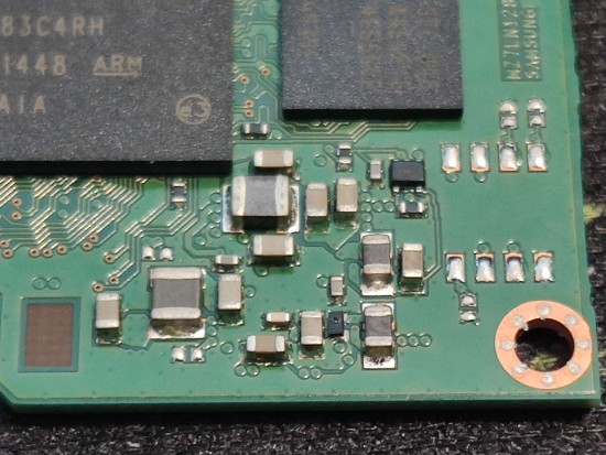

Upon disassembly, the PCB shows physical damage to the component that exploded as shown in the photo. Is there any point and chance to look for the culprit to fix the drive without losing data.

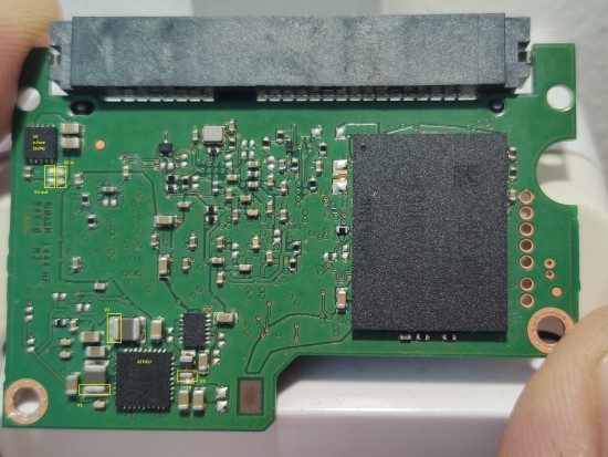

For a quick
Resistance between ground and 5 volts in and out next to Stef4s fuse
V5 out 2.1v 2M ohm
V5 in - 4.85V 2m ohm
In addition, the Stef4s fuse makes a squeaking sound.
V1 - 1,3mV
V2 - 0
V3 - 0,2mV
ATP4SJ component is heating up.
Sata connector +5 and ground
Pin 4 to Pin 7-9
0.25M ohm

 Post subject: Re: Samsung EVO 850 250Gb
PostPosted: September 25th, 2023, 9:07
Posts: 1312
That's an exploded diode. I believe it's on the boost rail so there should be 12v floating about there somewhere.
V2 is obviously shorted which may be pulling your vout down. Remove the diode for a start at recheck the measurements.

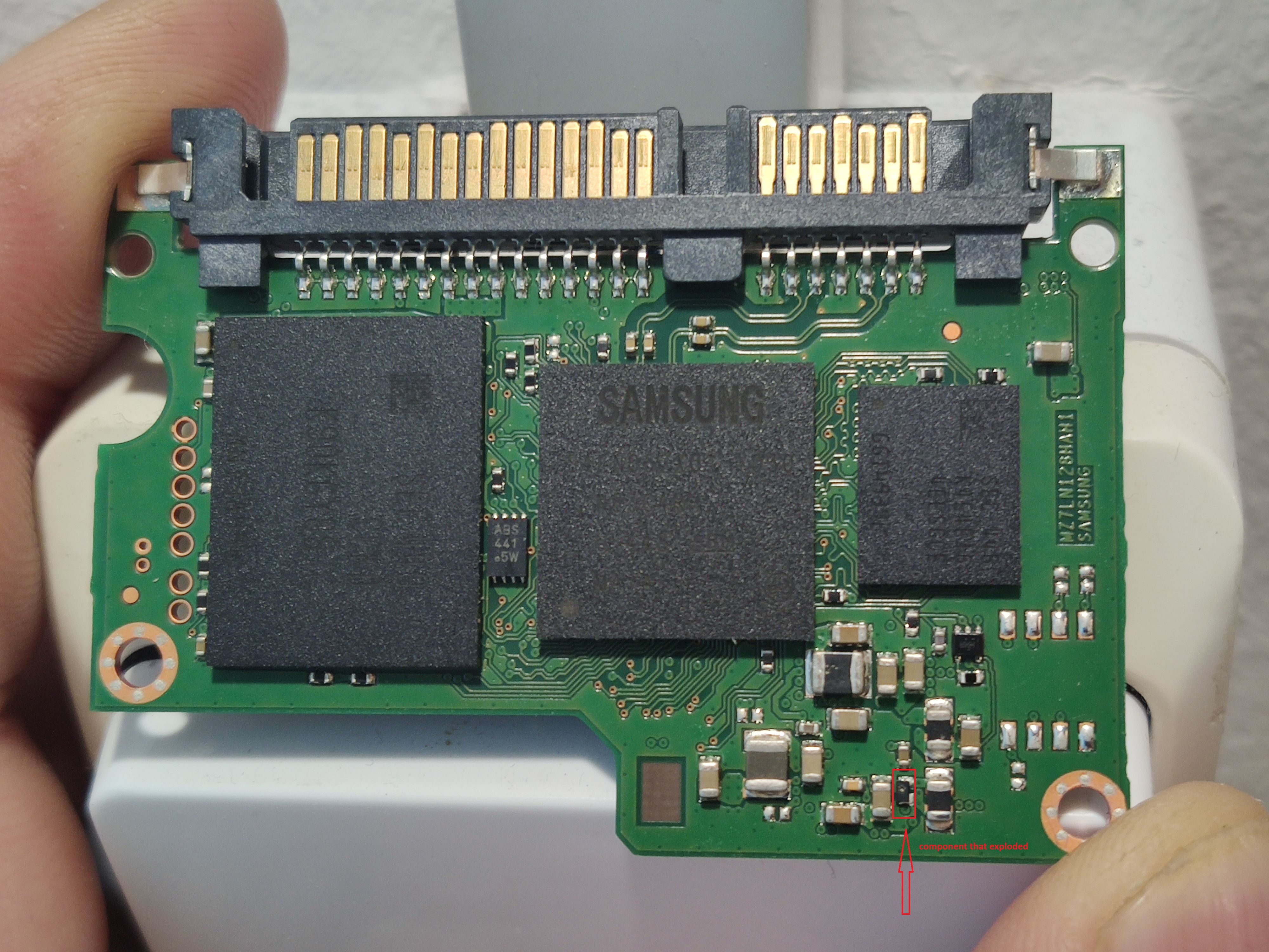

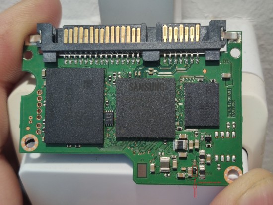

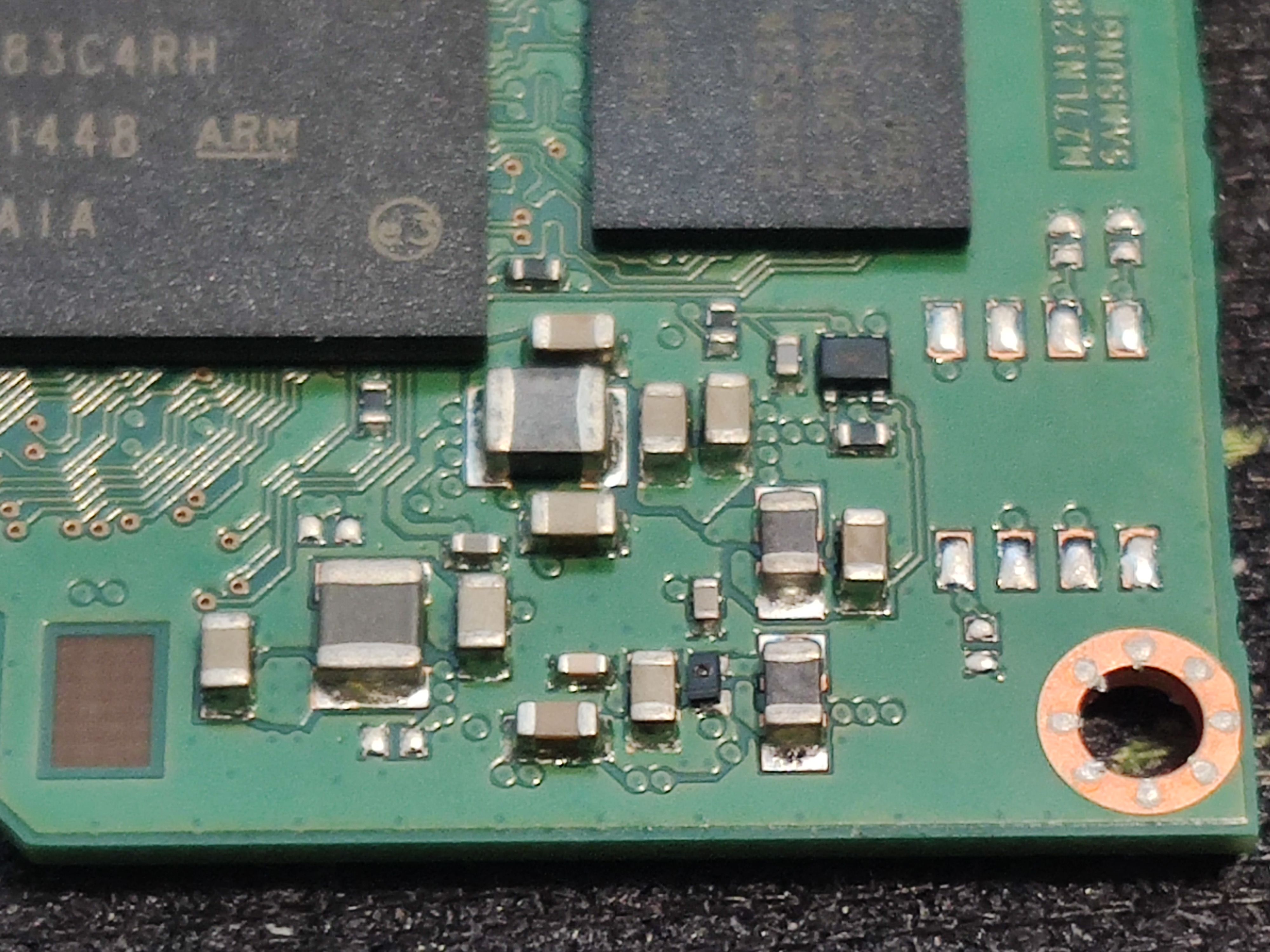

PostPosted: September 26th, 2023, 6:07
Joined: September 25th, 2023, 7:52
Thanks for the answer. After removing the diode, if I think correctly it was about the damaged component , nothing changes.
So after that i still looking for what going heat so much and it is nearby damaged component on this same circuit. After remove him disk would start and i can copy data from him.
Maybe this will hint at something.
Before the crash, the laptop with the disk kept a little higher temp around 70 degrees. I suspected a cooling problem. However, now after the crash I installed a new drive and the laptop temp dropped significantly to about 48 degrees. So I suspect that the disk must have been heating up already before the crash.
File comment: removed components
PostPosted: September 26th, 2023, 6:31
Posts: 1312
There's no ground at that inductor to short, if you have data access after removing it then it's likely the short is after it and you've effectively isolated the rest of the rail. IIRC there are only a couple of smaller caps between it and the nands anyway. As long as you have recovered your data - that's all that matters.
PostPosted: September 26th, 2023, 14:04
This is propably my little bad.
My last answer is to quick and not thoughtful.
When i writen about short to ground i make mistake.
Before removed inductor from pcb all heat very mach. So i try to figure out what element to this. With out thermal cam i put on PCB little bit IPA and watch where is gone first. So it happen on marked inductor so i go to removd it.
If you operate the Vpp circuit without the diode, then the inductor's current has nowhere to go when the magnetic field collapses. This will result in very high voltages at the inductor.
Micron's datasheet states that external Vpp can be enabled or disabled via Feature Address 30h. I'm wondering what would happen if the firmware enabled external Vpp but Vpp was not present. Would this degrade the performance of the SSD, or would it kill the performance completely (because the internal Vpp would be switched off)?
Now this SSD is only for trash for me or practice with soldering :) So if you want or by interessing i can verify or do some test if you can explain for me what you want.
PostPosted: September 26th, 2023, 14:37
Posts: 17226
Short version:
I would measure the resistance between the cathode of the diode (the striped end) and ground. I expect that there will be a short circuit.
Long version:
I expect that the topology of the 12V boost converter would be something like this:
                   inductor   diode
                     ___
             Vin o---UUU-+---->|---+---o  Vpp
      |         MOSFET   |  |      |
PMIC  |   .---.       ||<-  |     ---  capacitor
      |   |PWM| ------||-+  |      |
                             GND
The PWM controller turns on the MOSFET, and the inductor current then flows from Vin to ground via the MOSFET.
The PWM controller turns off the MOSFET, and the decaying inductor current then charges the capacitor via the diode.
The diode is reverse biased by Vpp during the MOSFET on time.
Of course there is feedback from Vpp back to the PWM controller (not drawn). There would need to be a potential divider on the FB pin to reduce the 12V supply to within the PMIC's Vcc range.
Here is a better explanation:
https://learnabout-electronics.org/PSU/psu32.php
