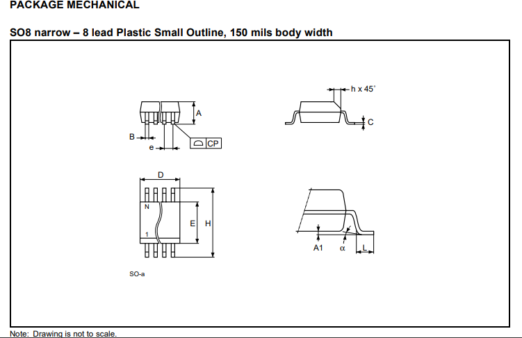

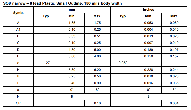

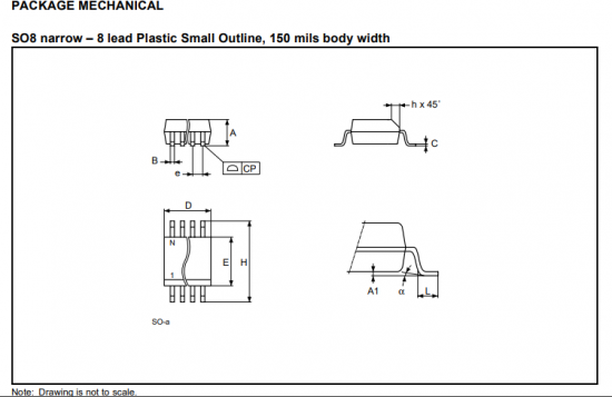

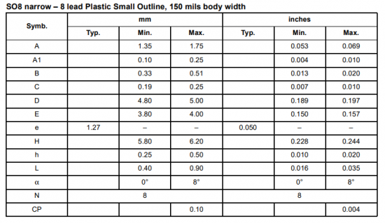

hi
what is size/measurement of WD rom IC,
mm ?
208 ml ?
150 ml?
thanks
 Post subject: Re: WD ROM PHYSICAL SIZE
PostPosted: November 21st, 2023, 7:26
Posts: 3936
just get the rom chip name and look it up on the datasheet. Also, you said "WD Rom" size. there are likely many different sizes for many different HDDs.
such as 25P05VP, 25P10VP, 25F512, 25F1024, 25F1024AN, etc.
