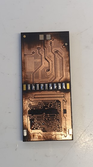

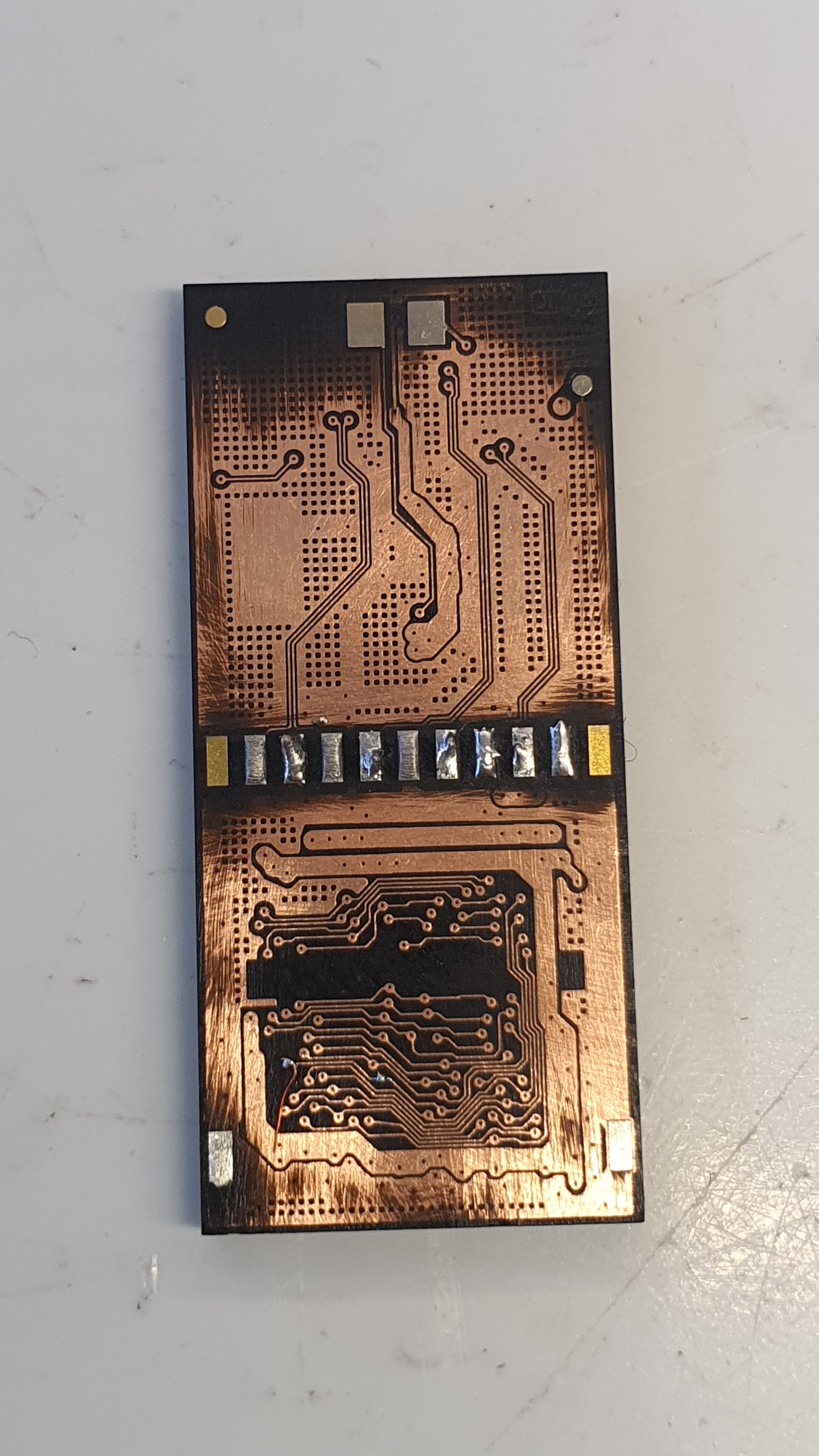

Hello guys,
i have this USB Flash drive that shows up for like 5 second and then going off. I can see the files but cant save them.. so i looked at the PIN-layout and jumped a spot that wasnt connected.. But i have still the same problem.
I also tryed it with a 2.0 socked but still the same...
I wanted to work on it with the PC3K Flash but they dont have the layout for this case...
Does anyone know where i can buy it? Or does someone hase another solution for this case?
Thank you!

I don't know anyone selling layouts - even the AE sellers appear to have dried up. Have you asked Ace about a layout or just checked the database?
Can you prolong your access time by actively cooling the device ?

The controller of this UFD is SM3267, using Samsung nand flash. I have a pinout, but it is not provided for free
http://flash-matrix.com/

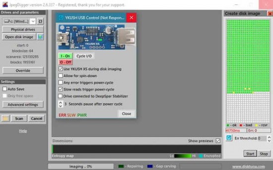

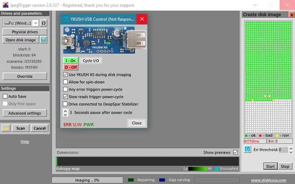

USB Stabilizer + some software with disk image function, DMDE, UFS. Then you need to examine how flash drive behaves:
- Get a feel for good reads and time that takes. Take result of that and add 10-20% and use as your read timeout threshold. Anything slower do power-cycle.
- Test a failed sector, so let it fail, do power-cycle and immediate(*) retry after that (**). In my experience the failed block of sectors can often be read after single retry.
(*) - This is important. If you save retries for a second pass, during 2nd pass you'll probably have same trouble reading that block again.
(**) - Retry entire failed block at once! So if you read block of 64 sectors and read fails, do repower, and set up your imager to retry 64 sectors rather than sector by sector retries. Using DMDE for example a way to accomplish this is by using Device I/O parameters and set BPS (bytes per sector) to 32768 and set I/O buffer to 1 sector.
You can do same using YKUSH but it is clumsier as your imager needs to do all handling of anomalies. Then after re-power or power-cycle the imager needs to become aware of fact device is back and create a new handle to it and continue imaging using the new file-handle. You can probably make DMDE work this was as you can run custom scripts to handle I/O errors (not tried yet). Klennet can be configured to run a batch file, you can make batch file to power-cycle using YKUSH after I/O error (not tried myself but I saw some one do it).
Advantage of Stabilizer is that it is handling all interaction with the drive. As an illustration, here I use YKUSH to do power-cycles, slow read or error triggers power-cycle followed by immediate retry. Yellow blocks are failed reads that were read successfully after power-cycle. IOW 'bad' sectors were not really bad sectors but failed due to controller doing stupid stuff.

Arch Stanton, Thank you very much for this detailt information! I tryed but didn work... guess i need the pinout.

Arch Stanton, yes im sorry... i finaly will buy a layout to work with it on the Flash. Still thank you very much for your support!
