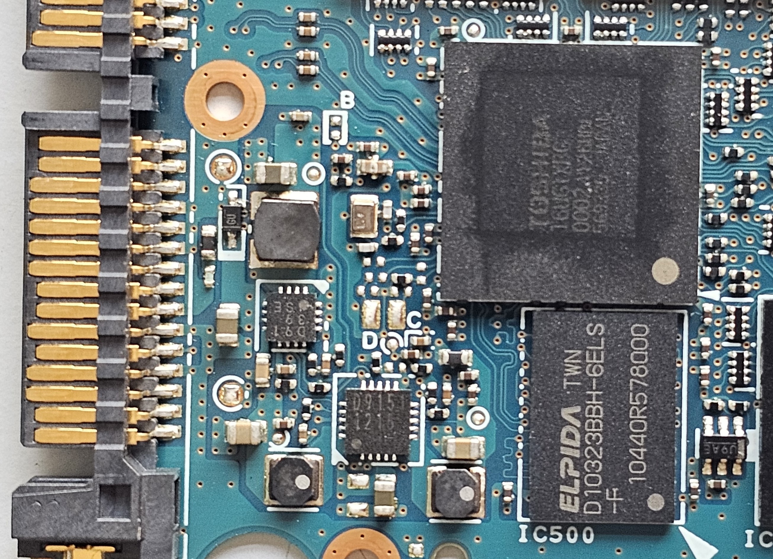

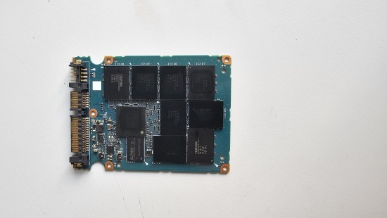

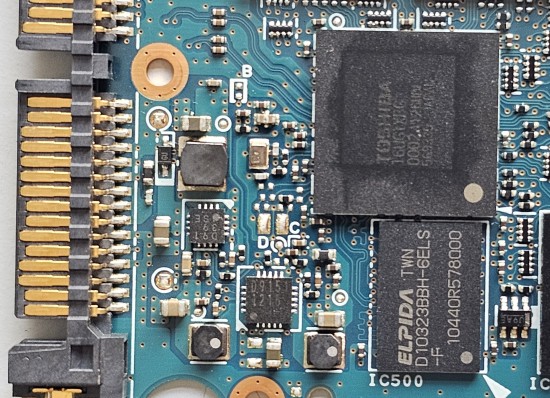

Hi friends! :)
I hope I can get some help.
I have a Toshiba SSD (THNSFC128GBSJ) that doesn't get any power. I plugged it into PC3K; the SSD gets ready, but without power input.
The controller is not supported. I already checked the capacitors to ground and didn't find a short.
Does anyone have any advice for me? I would appreciate it!

It can't get ready if it's taking no power. Check what voltage rails you actually have present and lets see what PC3K universal util actually shows.
 Post subject: Re: Toshiba SSD no power..
PostPosted: August 14th, 2024, 14:36
Posts: 17340
There appears to be an smt fuse at the SATA 5V input. Check if 5V is present at the "GU" diode.
BD9139MUV, Rohm, Synchronous Buck Converter, 3A, 1MHz, 2.7V - 5.5V in, QFN-16 (VQFN016V3030):
https://www.datasheetarchive.com/datasheet?id=b8f31bd1fdf27a891e591b6f34aba9828d1b0d&type=M&term=bd9139
https://download.s21i.faiusr.com/13099392/0/0/ABUIABA9GAAgm-nbzAUonJKv8QQ.pdf?f=X1C+Wistron+Genesis-1+LGS-1+11246-1.pdf&v=1503067291 (page 89)
https://www.hobbielektronika.hu/forum/getfile.php?id=347437 (page 89)
BD9151MUV, Rohm, Dual Step-down Switching Regulator, 2.8V - 5.0V, 1Mhz, 0.4A / 0.8A, QFN-20 (VQFN020V4040):
https://www.datasheetarchive.com/datasheet?id=b04a9b6613026cc26259e768ec487fd37e5513&type=M&term=bd9151
I'm not sure about this ...
R5323N039B, Ricoh, dual LDO regulator, 1.8V / 3.1V, 200mA, marking U9xx, SOT-23-6 (SC-74):
http://datasheet.elcodis.com/pdf2/108/89/1088945/r5323z013b.pdf
