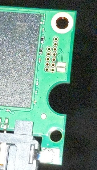

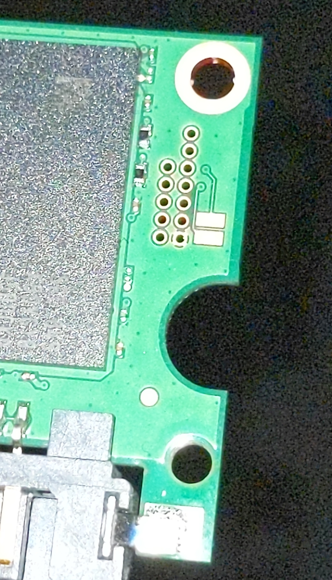

 Post subject: Re: SSD Samsung 870 EVO 1 To
PostPosted: October 1st, 2023, 10:05
Joined: September 27th, 2020, 14:10
Posts: 21
Location: There

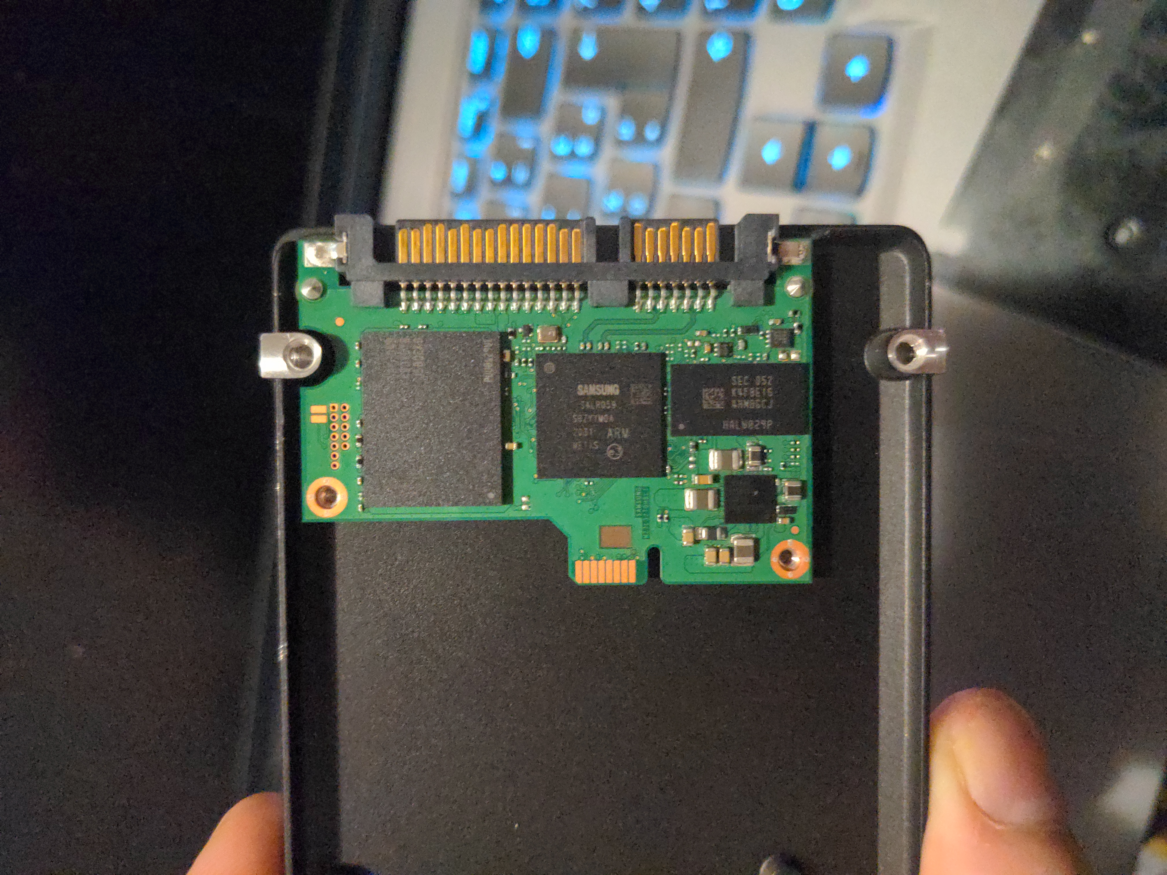

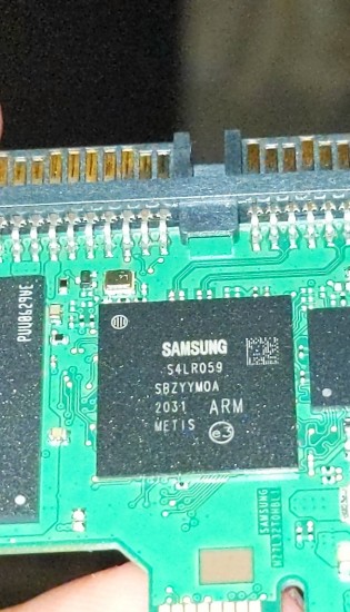

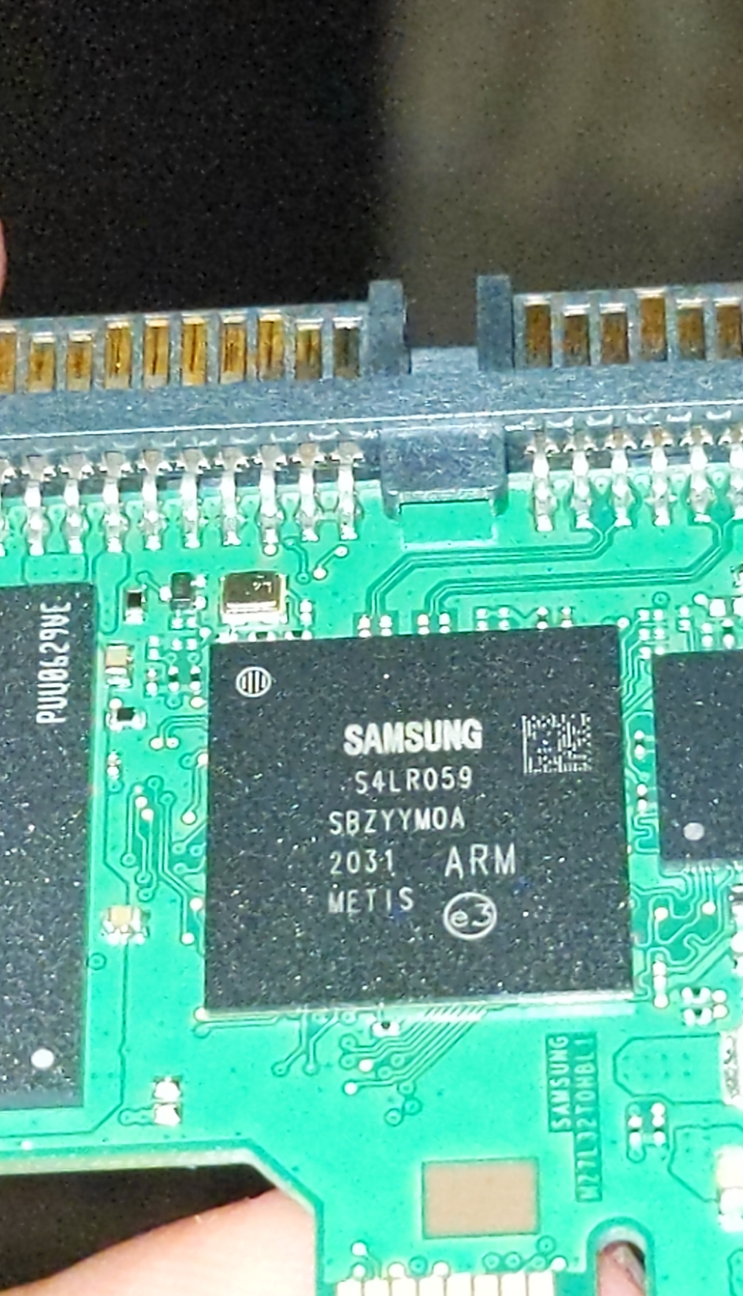

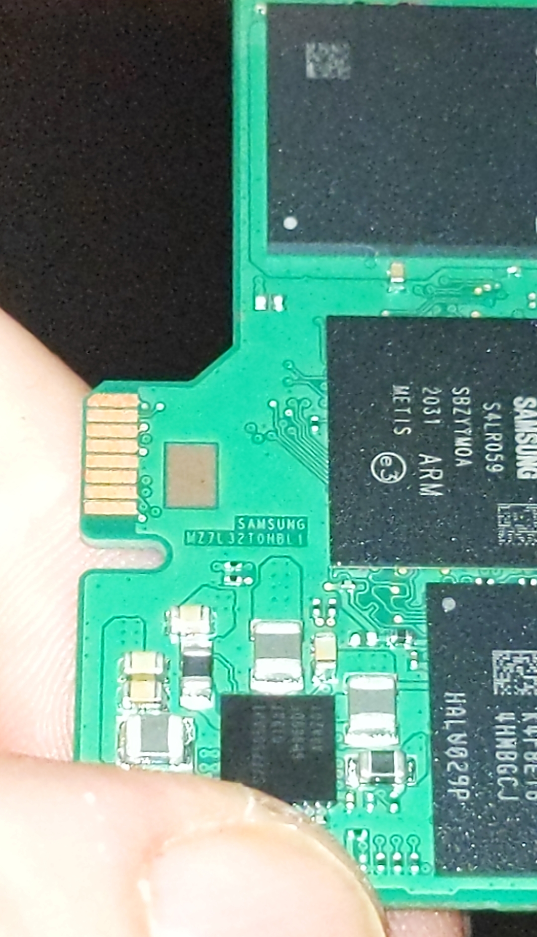

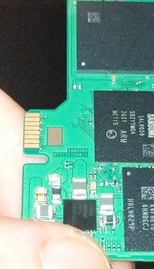

do you know if there is a way to have a SWD or JTAG pins on PCB? I didn't find a datasheet :(
PostPosted: October 1st, 2023, 19:04
Posts: 17228
I think people use something like JTAGulator.
PostPosted: October 2nd, 2023, 2:25
Posts: 4816
It's gonna be a long trip, be prepared.
PostPosted: October 2nd, 2023, 3:52
Posts: 1312
tcccorp, This might give you a little insight - http://www2.futureware.at/~philipp/ssd/ ... Manual.pdf

Thanks a lot for your answer. So I think if I m able to change controler, it ll work?
PostPosted: October 5th, 2023, 15:18
Posts: 4816
Nope, controller is most likely just fine.
PostPosted: October 5th, 2023, 15:20
Posts: 1312
Unlikely - the controller itself is probably fine, the firmware is stored on the nand chips .

hello
so it does mean, even I m be able to find jtag or swd, i should "dump" flash but it ll be in raw and I'll not be able to recover something because at least it ll be xored and data could be everywhere.... I'm right ?
PostPosted: October 7th, 2023, 16:20
Posts: 4816
you cannot dump NAND through jtag, at least not as easily as you probably think. It would require programming skills in multiple platforms, or knowledge about boundary scan parameters, and on top of that it would be very slow. Then you would face the problems everybody faces who tries chip-off on these...
