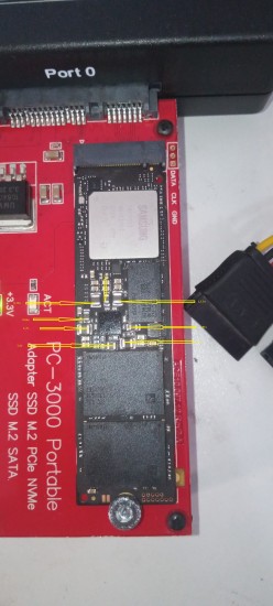

Greetings, everyone.
I received an SSD from a client last week, a Samsung model MZ-VL21T0A. When I connected the SSD to the PC3K portable device, none of the status indicators such as PHY and ACT lit up, and the power consumption was measured at 0.13A. After consulting with an acquaintance in the data recovery industry, they suggested that the processor might not be communicating with the memory modules.
I conducted several measurements around the PMIC inductors. I will be sharing an image containing all the measured voltages. I noticed that some voltages were unusually low, specifically 0.86V and 0.74V. I suspect these voltages could be used by the processor.
Additionally, I have been attempting to locate the datasheet for the memory modules, specifically with the part number "kdugy8." Unfortunately, I have been unsuccessful in finding any relevant information. My goal is to confirm whether the memories indeed operate on the low voltages I observed earlier.

Voltages look fine to me. Is it a constant 0.13A draw immediately on power up or is that what it settles at after some fluctuation. What's the resistance on the power rails like? Have you measured the voltage at the nand caps?

You should measure the voltages on the other side of the inductor, ie the side that connects to the filter capacitor. That said, the difference will be minor.
There are two additional ICs, an 8-pin and a 14-pin. I expect that these will be load switches. You should measure the same voltages at the inputs and outputs. The 14-pin IC is probably a dual switch.

0.1A - this is how much the adapter itself consumes, check the connection and the adapter.

I assessed the voltage levels at the NAND caps, and it appears that the NAND flash operates with voltages of 1.2v, 1.8v, and 2.49v. Interestingly, I speculate the NAND flash internally generates voltages of 0.6v and 11.99v. I speculate that the 11.99v might be utilized for block erasure purposes, although the specific function of the 0.6v remains unclear to me at this point.

I don't understand why you're it's using so little current with those reading. Check the the IC's fzabkar suggested in case the controller isn't being enabled otherwise I can only think it's brain dead.

Both load switches are functioning properly, and I can measure voltage at the output of both ICs. The load switch marked rb966 is responsible for supplying power, as far as I can discern, to the RAM memory with two voltages, namely 1.12V and 1.81V. The load switch with the marking 13xh is responsible for supplying power, as far as I can discern, to the processor at 1.12V.
I am contemplating resoldering the memories first and subsequently addressing the processor.

If all the voltages are present it's increasingly looking like firmware. I'd move to the thermal camera next and check the thermal pattern. You should get a blip on the pmic then sdram and then controller. Some drives cycle this others stop with just the controller showing heat.
You can try a reball but I wouldn't expect any change.
