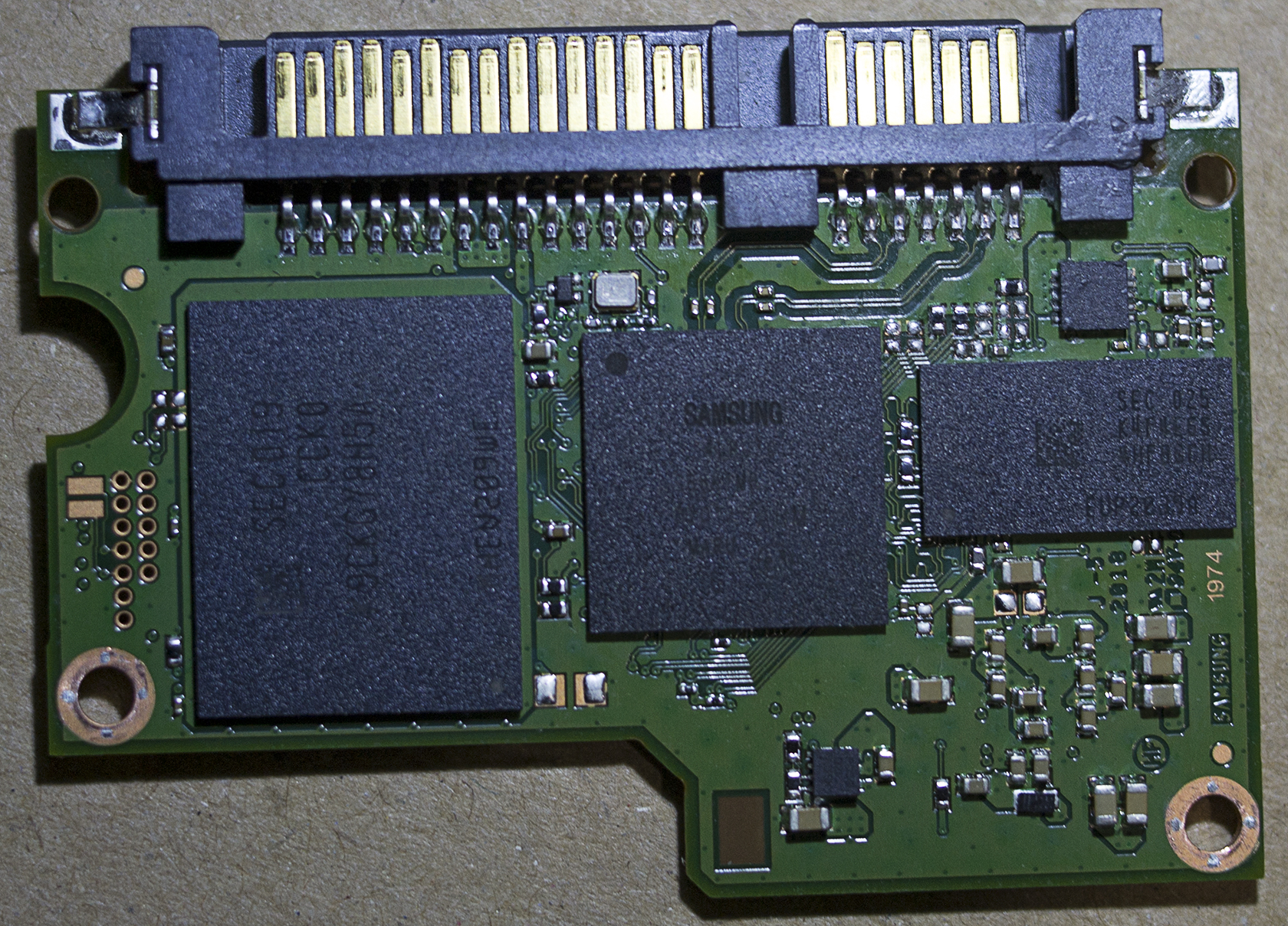

hi, my Samsung SSD Evo 860 often not detected in bios. But some times bios sees ssd with true capacity. It's happened after sleep. The system was frozen and i turn off the powert. Any Windows can not boot with this SSD even if OS on the other disk. Also even if i try to boot from Windows rescue disk. Any Linux wrote message like this: ata1.00: failed to set xfermode (err_mask=0x40) But system system has booted. Although lsblk doesn't detect SSD.
What i can do?

Thanks, I was looking for my local DR place. On their website they claim that they can restore data only if disk without encryption. But Evo 860 includes an AES 256-bit hardware-based encryption. So i think maybe i can find another solution. First i would like to understand Is this a hardware problem or for example firmware crash. So i try to check for a short. But not found any damage. Chips are cold. So It looks like there is no power coming in. I try check the fuse but it's very small. Now i waiting for some tools

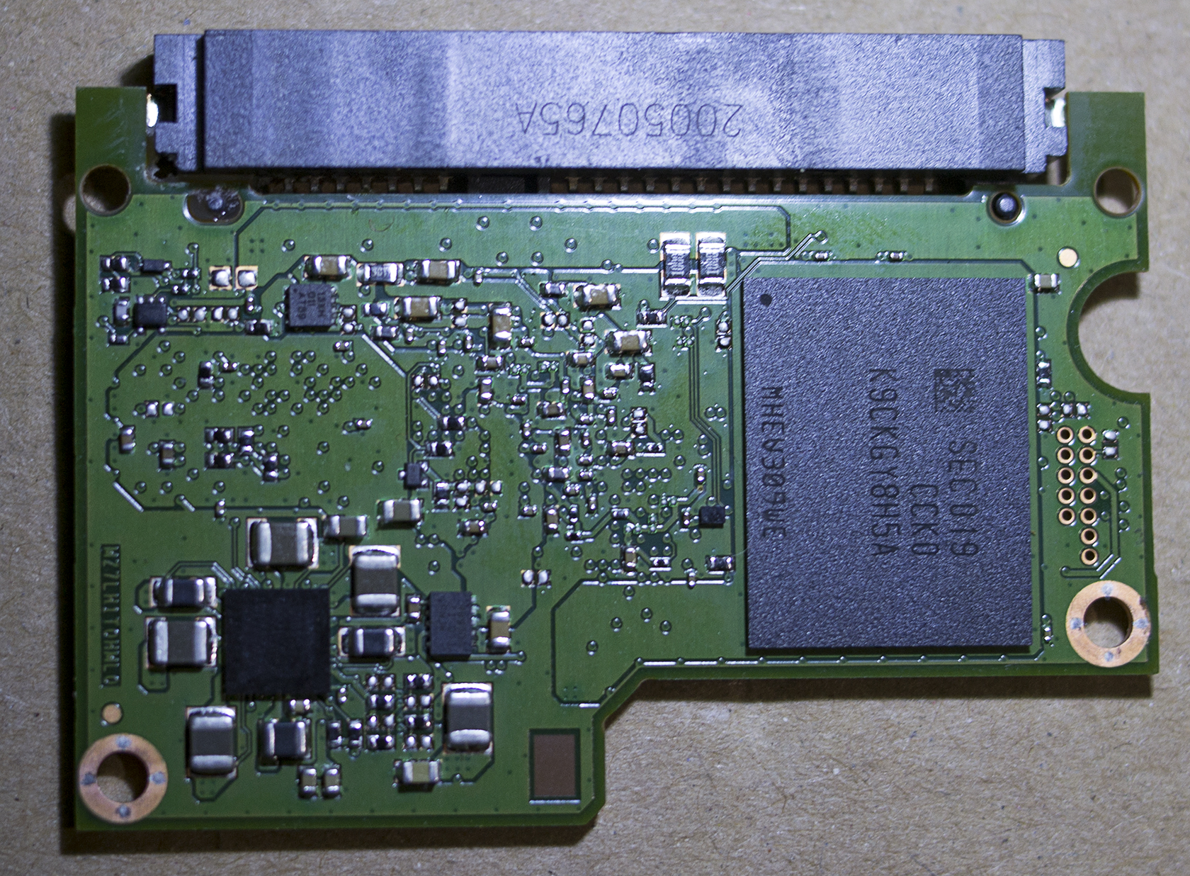

HaQue wrote:
Do you have a Multi-meter?
Of course. Here are the photos. I found in this forum about correct values of Evo 860. I forgot to say that any Windows not boot with error on blue screen : pnp watchdog error. I would be grateful for any information on way to solve this problem

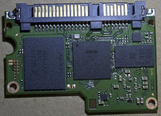

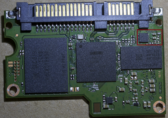

Check this area my friend.

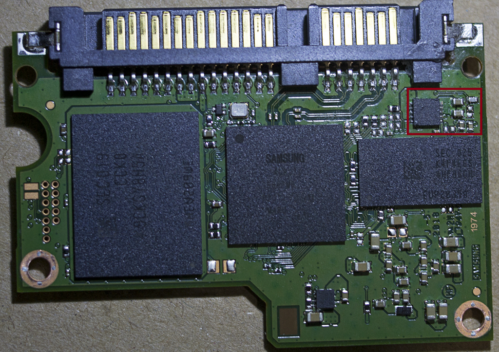

So far I haven't found any problems there. There's a little bit of fixative because i try to connect the fuse. This is a fixative for pretreatment. I didn't do very well because the fuse is too small.
 Post subject: Re: Is possible to recover data from Samsung SSD Evo 860?
PostPosted: November 27th, 2023, 12:18
Posts: 1317
You need 5v on both sides of the efuse. If you have that then measure the outputs of the pmic at the inductors the other side of the pcb
