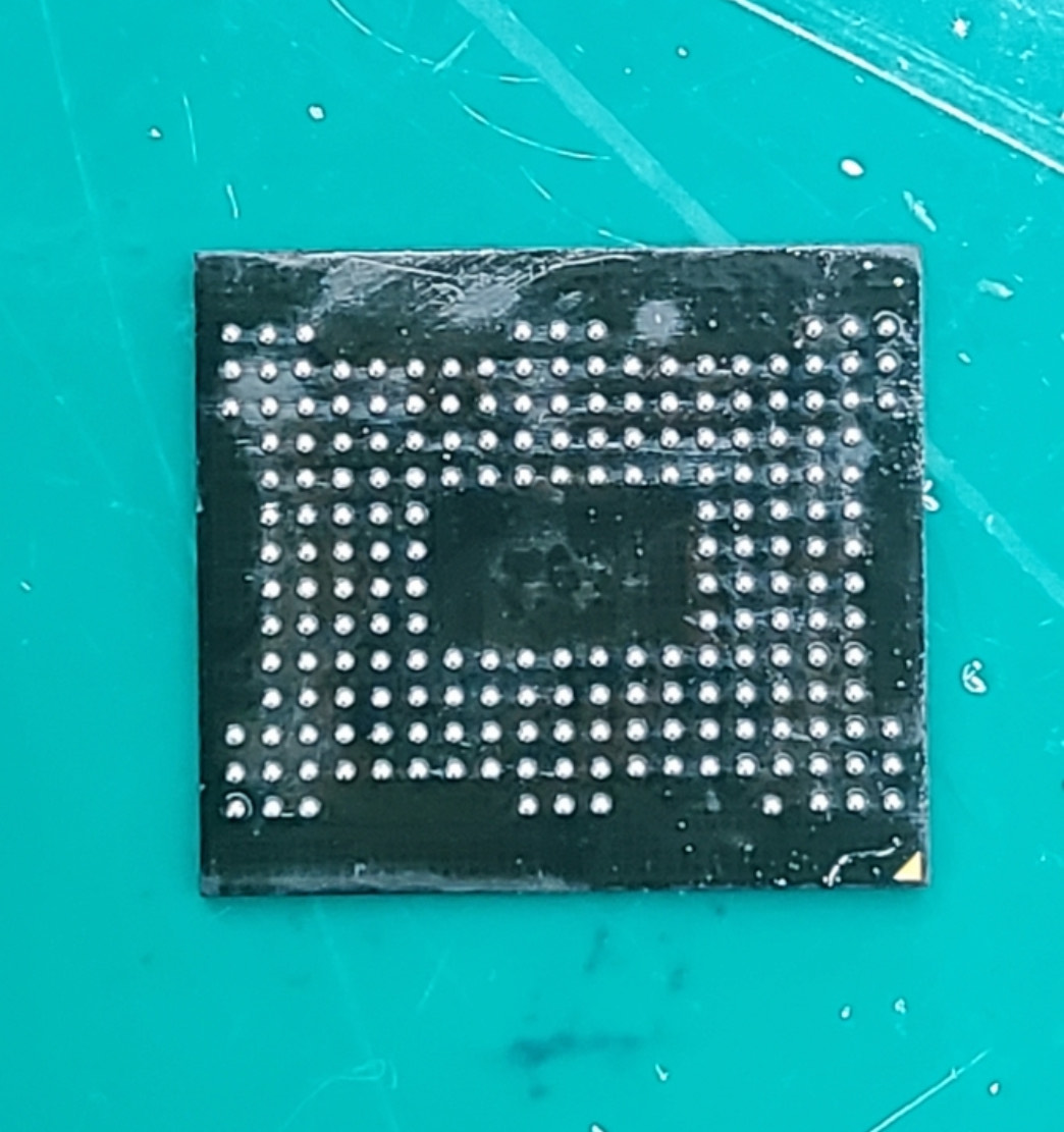

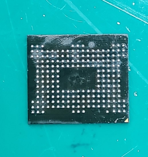

I got a Samsung "KAV00500FM-AFFY" chip.
I find out it is called FBGA.
Is there any reader can make dump? BGA152 reader can read this?
 Post subject: Re: FBGA reader?
PostPosted: April 12th, 2024, 5:56
Joined: September 23rd, 2019, 2:55
Posts: 112
From what device is this memory? These chips were used in old samung phones like m8800 pixon, adapter not exist, probably no one have pinout . I thing recovery is possible but a lot of R&D.

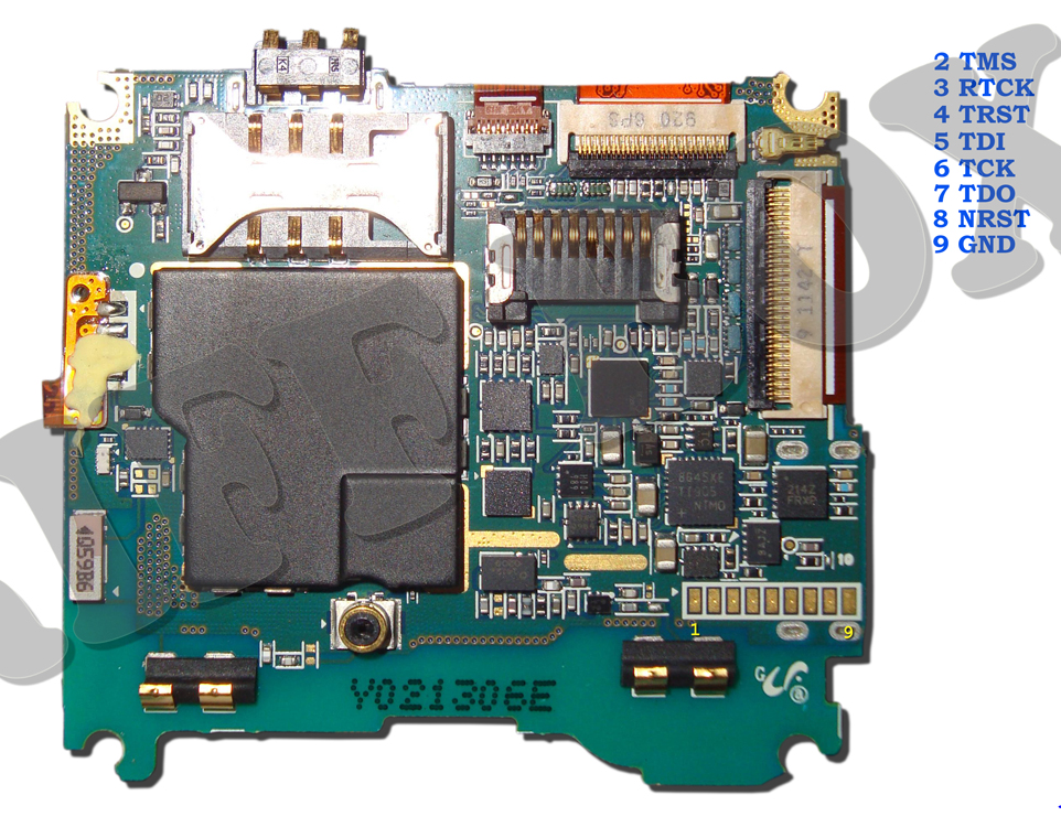

In the old days, to read the dump from a tagged device, was used RiFF Box via JTAG, so chip must be in working motherboard and read via JTAG
other tool: Easy Z3x JTAG, Medusa JTAG etc.

Gregory, Hello!
I am the guy who asked about BGA152 reader and you were kindly advice me about RiFF Box via JTAG, Z3X and Medusa. Actually, I bought the boxes but I cannot find out pinout of Samsung SGH-A867. I asked GSMserver about pinout but they told me SGH-A867 pinout does not provide anymore. They told me somebody must have it because it was provided from all boxes before. Therefore, I am asking you if you got pinout or not.
I am really sorry to bother you.
Appreciated.
PostPosted: May 28th, 2024, 3:02
Posts: 112
Recoverrover wrote:
Gregory, Hello!
Appreciated.

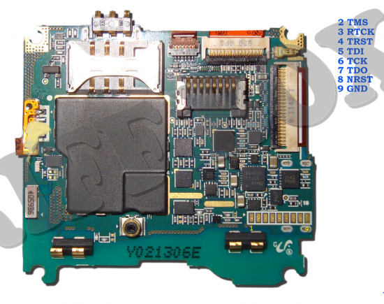

I checked and it is in the riff box. Here you go:
