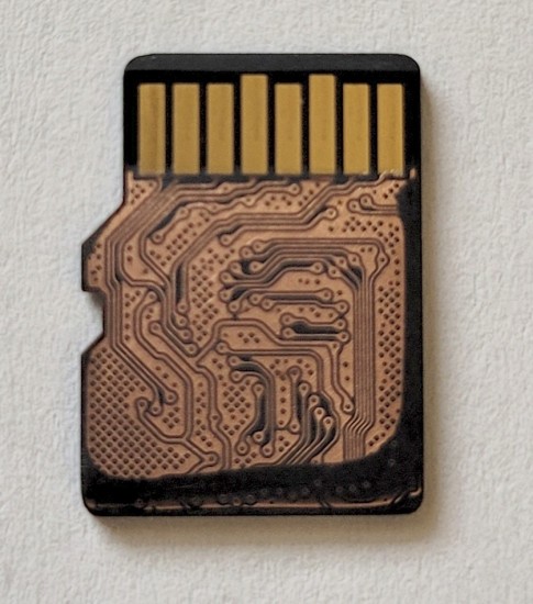

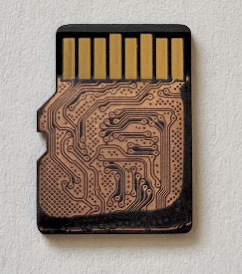

i am looking for the pinout of a Intenso 64Gb microSD card that is not in the PC-3000 Flash database.
I have a small data recovery business in Germany / Bavaria with PC-3000 UDMA (Data Extractor / SSD) and PC-3000 Flash.
Can anyone support me in this case?
Kind Regards
Markus

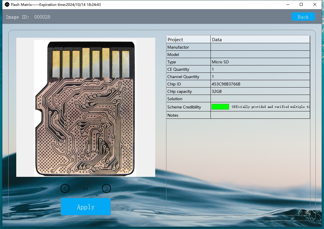

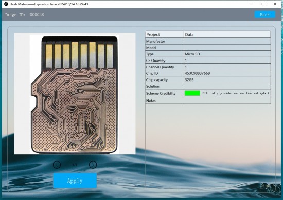

Due to the incorrect method used in polishing the minolith, many wires have been disconnected. Given the current situation, you need to locate experts in your area who can provide on-site assistance
http://flash-matrix.com/

I have a question: Is the black stuff at the bottom and right side on card on your photo the top-coating which has not been removed yet, or has both top-coating and the metal been removed there already?
 Post subject: Re: Intenso 64Gb microSD Pinout
PostPosted: November 30th, 2023, 7:40
Joined: May 13th, 2019, 7:50
Posts: 1226
Location: Nederland
I assumed it was "top-coating which has not been removed yet". Then I stared at it for 17 hours to find broken traces and reached the conclusion you were mistaking not removed yet coating for removed copper perhaps?
PostPosted: November 30th, 2023, 8:11
Posts: 1324
There are a couple of deep scratches which may have cut a track or 2 and perhaps some wear around the contact bed, I wouldn't like to say if they were actually broken as I've seen and done much worse :oops:
