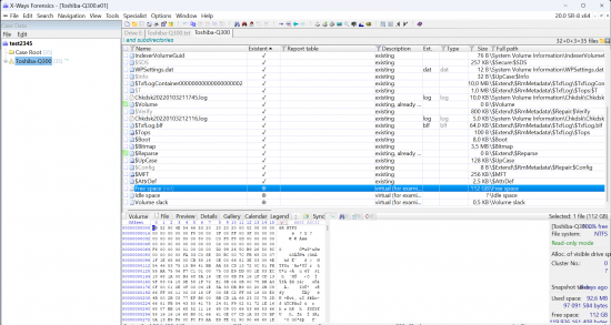

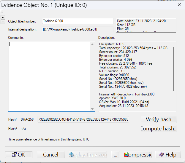

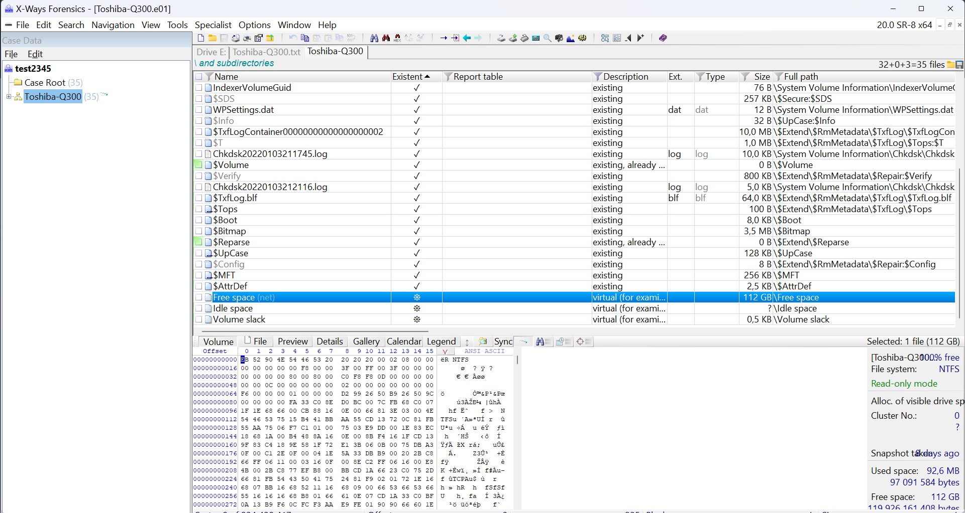

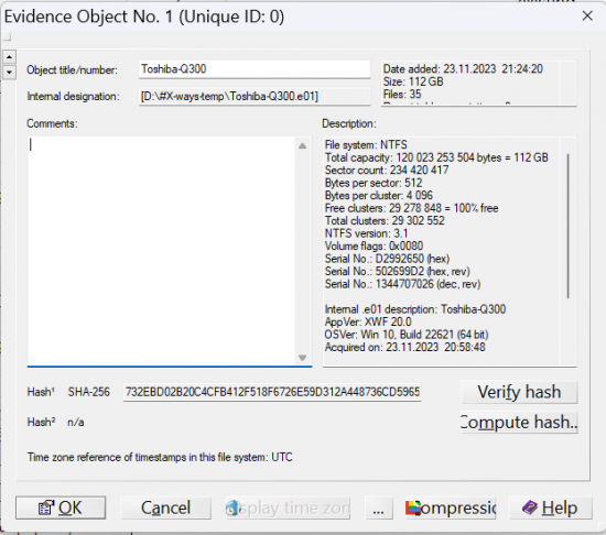

Hi im tryin to create disk image from Toshiba Q300 120GB
im read only 4.2gb of data
23.11.2023, 20:58:48
X-Ways Forensics 20.0 SR-8 x64
Create Disk Image
Computer: DESKTOP-QJ107FS.fv.local
8 processor cores
Windows 10, Build 22621 (64 bit)
Time zone: +01:00 Środkowoeuropejski czas stand.
User:
Source: Drive E:
Sectors 0-234420416
File system: NTFS
Total capacity: 120 023 253 504 bytes = 112 GB
Sector count: 234 420 417
Bytes per sector: 512
Bytes per cluster: 4 096
Free clusters: 29 278 848 = 100% free
Total clusters: 29 302 552
NTFS version: 3.1
Volume flags: 0x0080
Serial No.: D2992650 (hex)
Serial No.: 502699D2 (hex, rev)
Serial No.: 1344707026 (dec, rev)
Destination: D:\#X-ways-temp\Toshiba-Q300.e01
Hash of source data: 732EBD02B20C4CFB412F518F6726E59D312A448736CD596574293C8E1732FBF4 (SHA-256)
23.11.2023, 21:18:31
Imaging completed: 4,2 GB
Image consisting of 1 segment(s).
Duration: 19:42 min. 5,7 GB/min.
Compression: fast, adaptive
Compression ratio: 96%
what happend witch this drive ?
https://www.google.com/search?q=%2819+minutes+%2B+42+seconds%29+x++5.7+GB%2Fminute+in+GB
((19 minutes) + (42 seconds)) x 5.7 (GB / minute) = 112.29 gigabytes
Is the resulting image file compressed?
"Compression ratio: 96%"
4% x 112.29 GB = 4.5 GB
 Post subject: Re: Toshiba Q300 -
PostPosted: December 1st, 2023, 14:58
Joined: May 13th, 2019, 7:50
Posts: 1209
Location: Nederland
Free clusters: 29 278 848 = 100% free. NTFS so free space will be trimmed.
