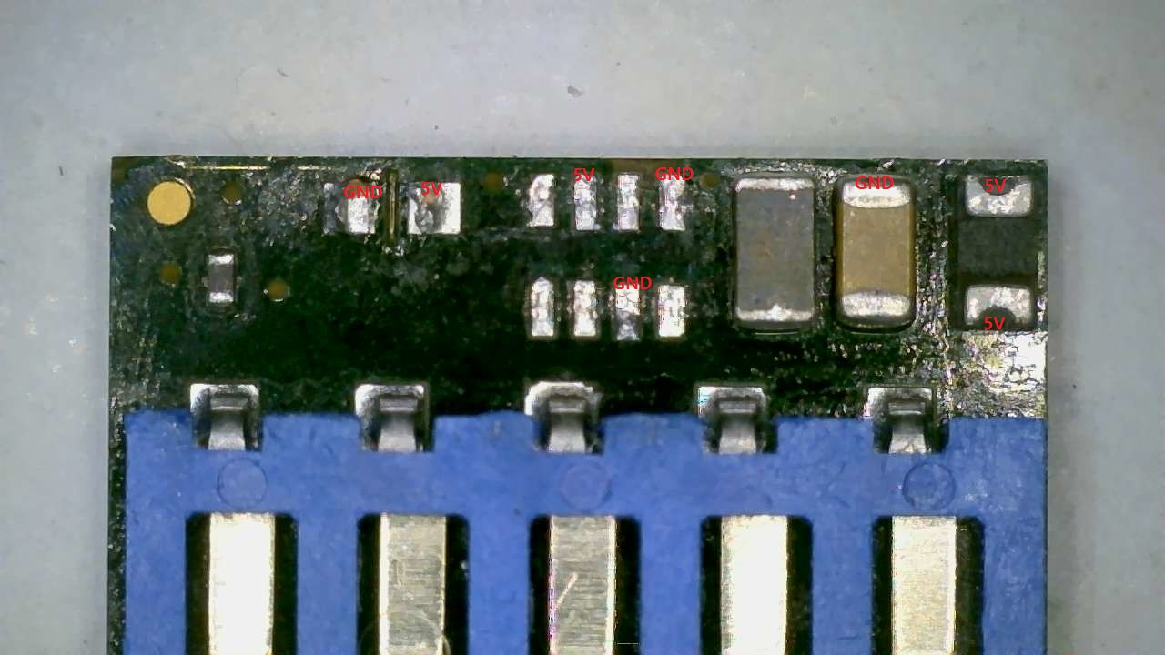

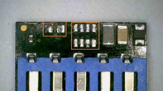

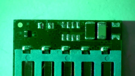

hello.
it's Sandisk Ultra Flair 256G

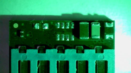

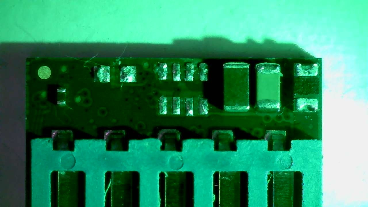

lost two parts when the USB flash drive broke.

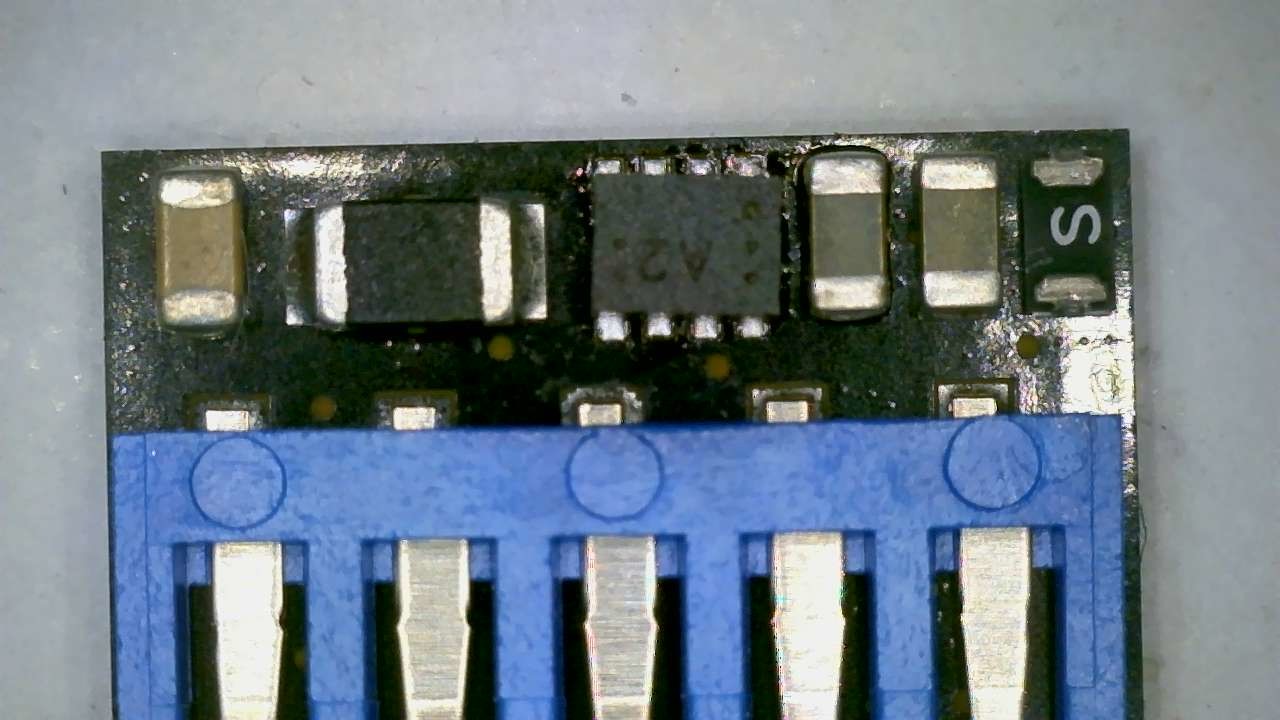

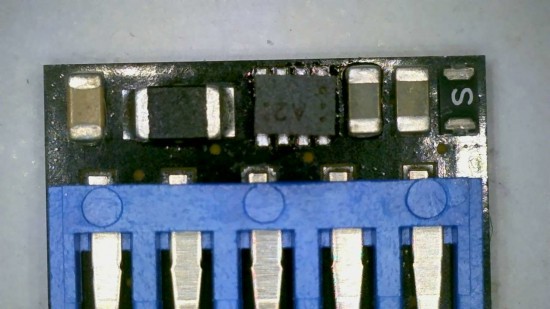

I tried bought the same model to replace it, but it was different.

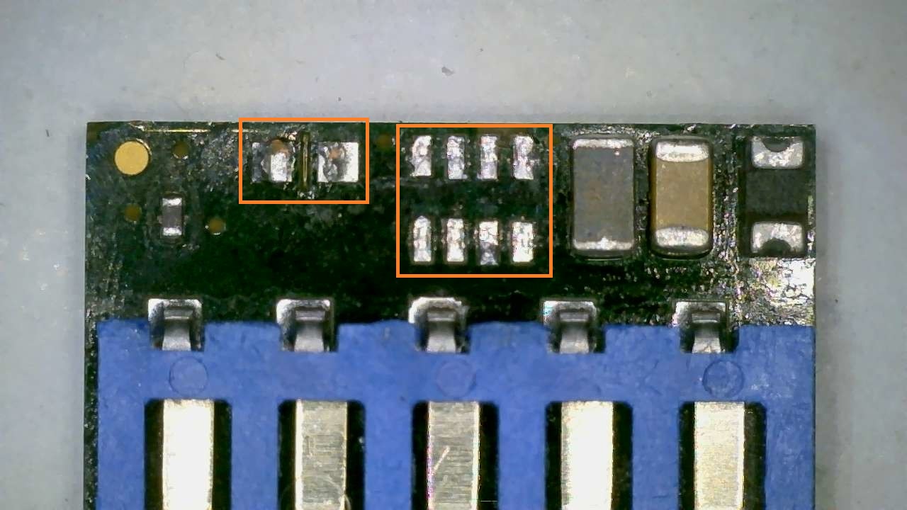

Can anyone tell me about those parts?

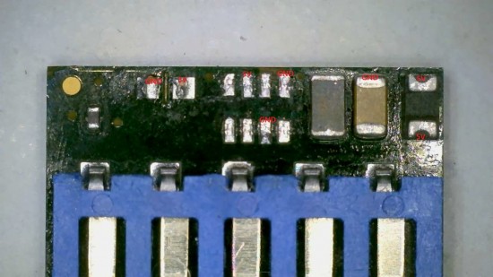

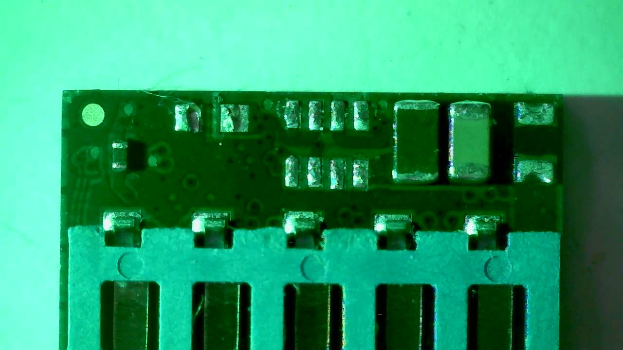

i marked the results of the continuous test.
Thanks for helping me!

It seems to me that the two are the same, it's just that the sizes differ. What are the resistances of each of the 5 passive components? What are the voltages at each passive component on the new drive?

i checked new one's 5V, GND.
it is 180 degree ratated.
so, i moved it with rotated without left parts.
it works!
thanks a lot.

To me, your result is useless and frustrating. We still don't know what the IC is or does. It should take only a few minutes to trace the circuit around those 6 components and to measure the voltages on all the pins. That would tell us everything we need to know. It's quite possible that the IC is an e-fuse or load switch, in which case it could be bypassed with a link instead of sacrificing a donor. The part on the left is probably a capacitor (according to the voltages), although its colour is more like an inductor.

I have seen many variations on logic boards for both hard disks and SATA SSD products suggesting batches are made using whatever parts are available cheapest
