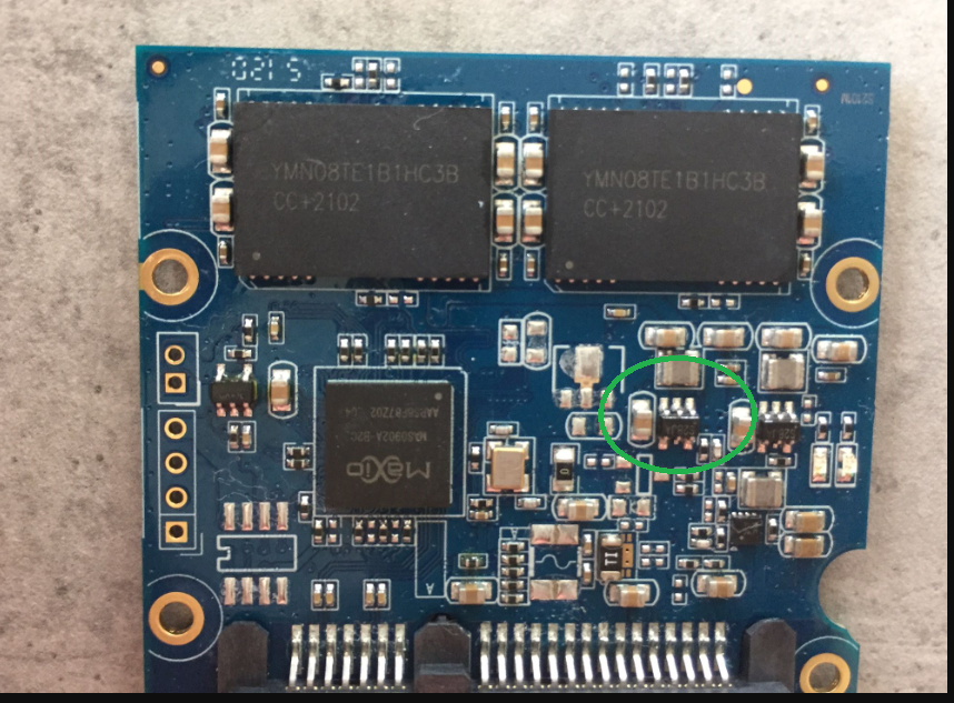

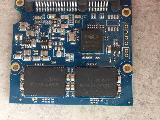

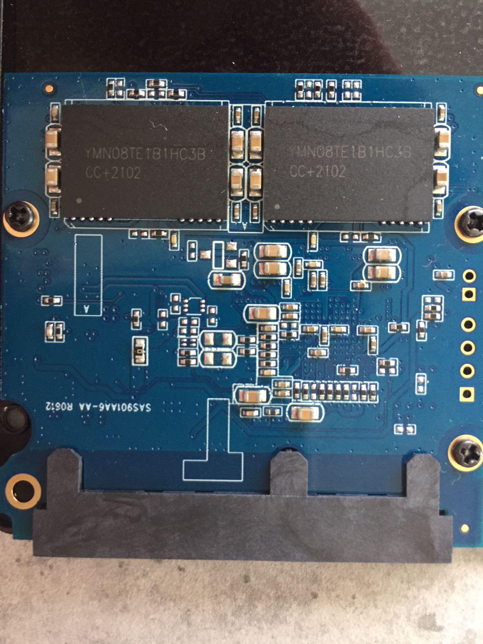

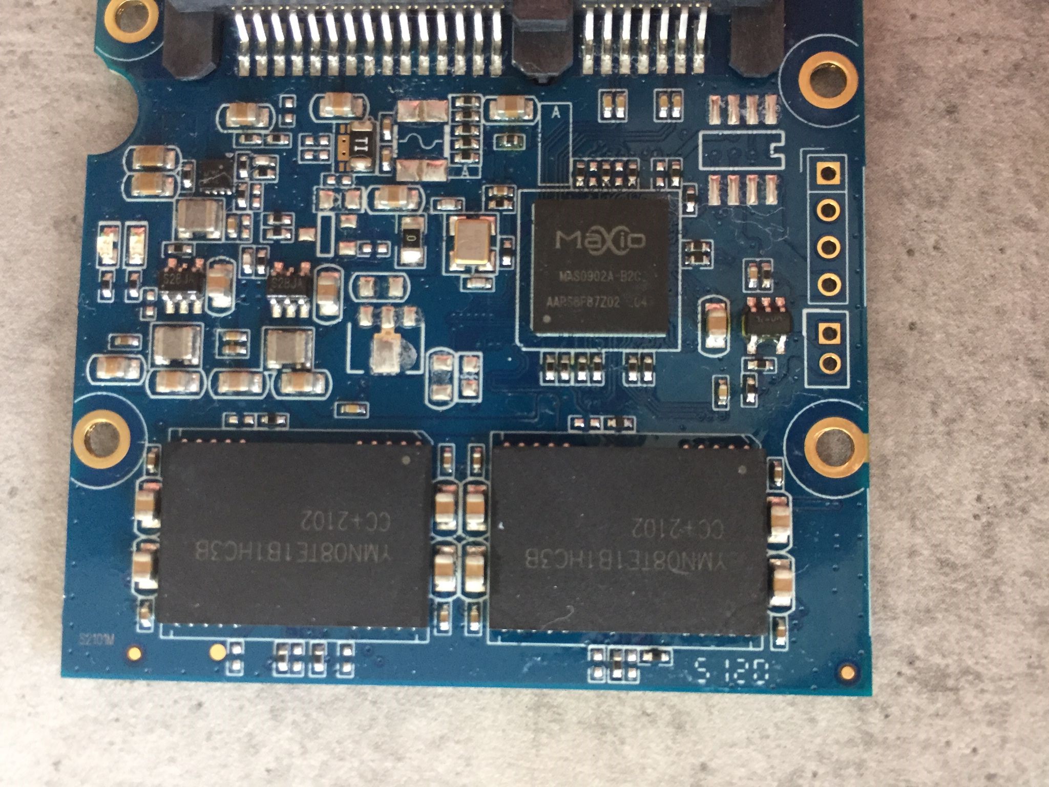

Hi everyone,

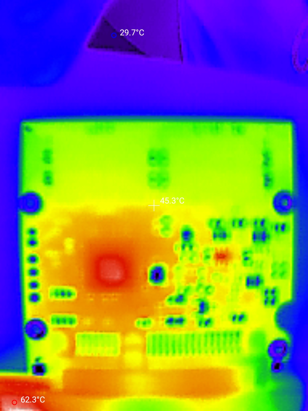

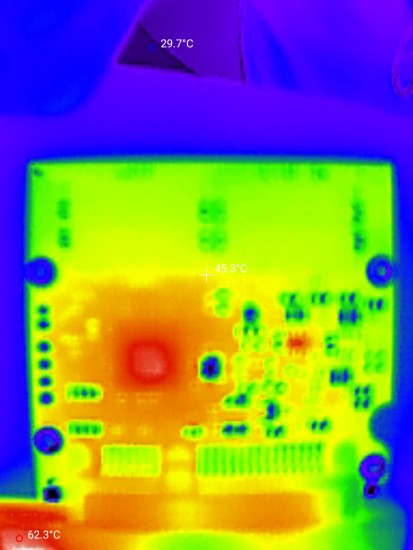

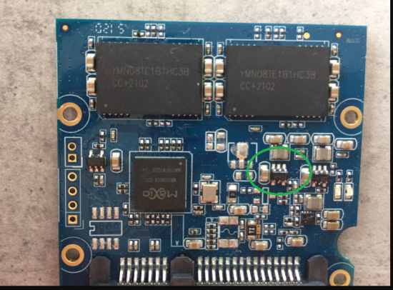

I got a Patriot P210 512GB SSD which is not detected anymore, I checked with thermal usb camera and the MAXIO MAS0902 Controller is getting hot.
Does anyone have an idea where I can start troubleshooting, what I should do?
Best Wishes

Check the power rails for shorts by measuring the resistance of the inductors to ground.
How hot is hot, short hot or activity hot. If the device is electrically sound try safe mode.

Sounds about right, If you're getting that far the drive appears to be electrically sound so you'll need the new version (7.3.x) of pc3000 for controller support for the mas0902.

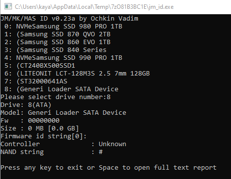

When I do the safe mode, I get a Generic Loader SATA Device, but it's useless without proper tools I guess.

Posts: 17256
The 4-pin header is a UART port:
https://www.rflashdata.com/wp-content/uploads/2022/09/Maxio-MAS1102-600x908.webp
See if you can get any diagnostic messages from the port.

As for now i have this screenshot attached, maybe that gives another idea

kaya1923 wrote:
I sent the solid state disk to two companies, both said that they could not do anything.
Put your multimeter in contiunity mode with beep function
Put black and red probes together and see if you can hear the beep sound.
If you can you can go ahead
Put your black probe on ground some where on circuit board

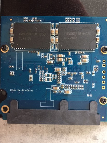

Put your red probe on a s ide of a capacitor and if it beeps, put it on the other side, if beep, you found the shorted cap.
have you also checked that small ic in green circel, in thermal camera picture, it shows that also gets hot.
File comment: The ic in the thermal camera picture, gets hot too.
File comment: You can also measure on both side of the cap like this
Hey brother, I did that when I created this Thread, but I will redo it with Ground and left/right pads, but IIRC it was what I did first and afterwards I did like in your picture.
That small IC, I may need to reorder one and then just change it, maybe the disk will work?
Thank you very much
