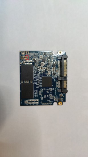

Hi everyone, this is the first post I've written, so I apologize in advance if I'm not clear. I use MRT and I'm trying to have access to this SSD. It mounts an SM2258H chip, when I try to recognize it I get no results. Who could tell me how to go to SAFE MODE? I tried some pins, but I'm afraid of doing damage and ruining the SSD. I attach the photo of the card.
Thanks in advance.
PS: I saw on the PC3000 tutorial that even if it is not listed this type of SSD can be read by choosing one of the star family.
Immagine WhatsApp 2024-02-10 ore 11.33.10_d3cc5c1a.jpg [ 307.56 KiB | Viewed 5660 times ]

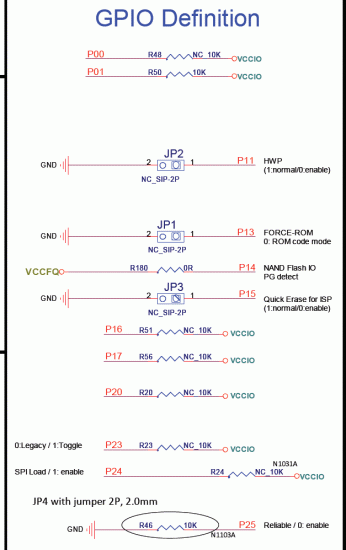

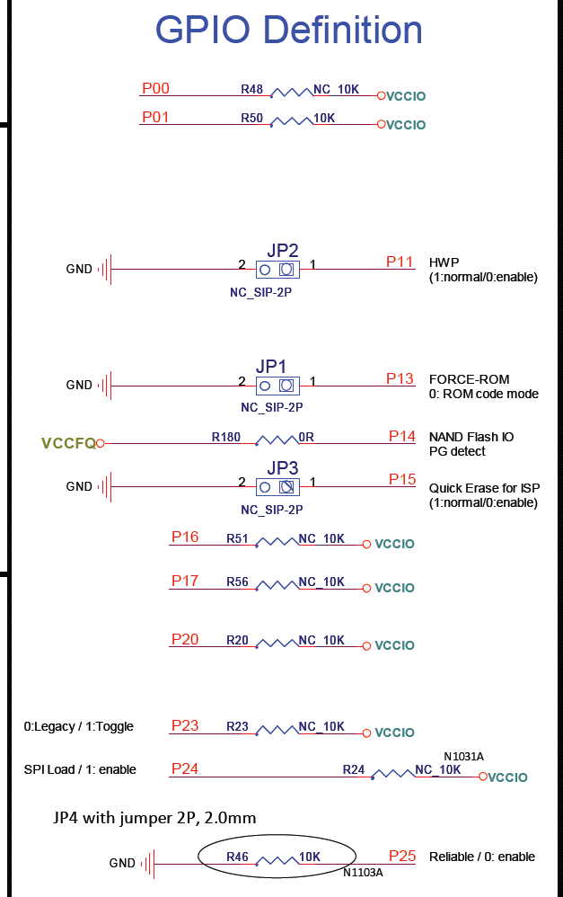

I think ROM mode is selected by P13 in the top group of 8.
Silicon Motion SSD Reference Circuits:
https://www.hddoracle.com/viewtopic.php?p=22726#p22726
https://www.hddoracle.com/download/file.php?id=9649

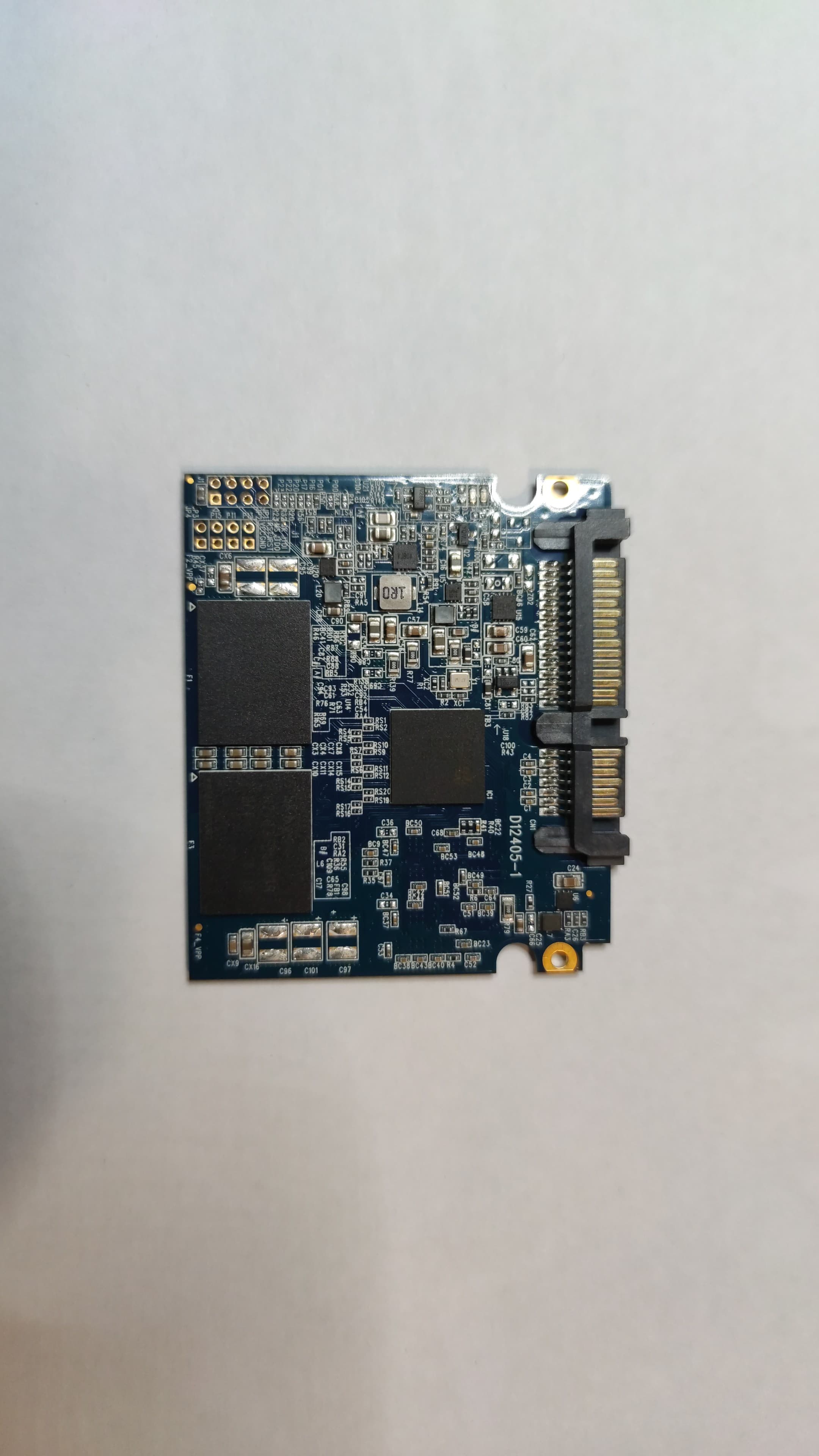

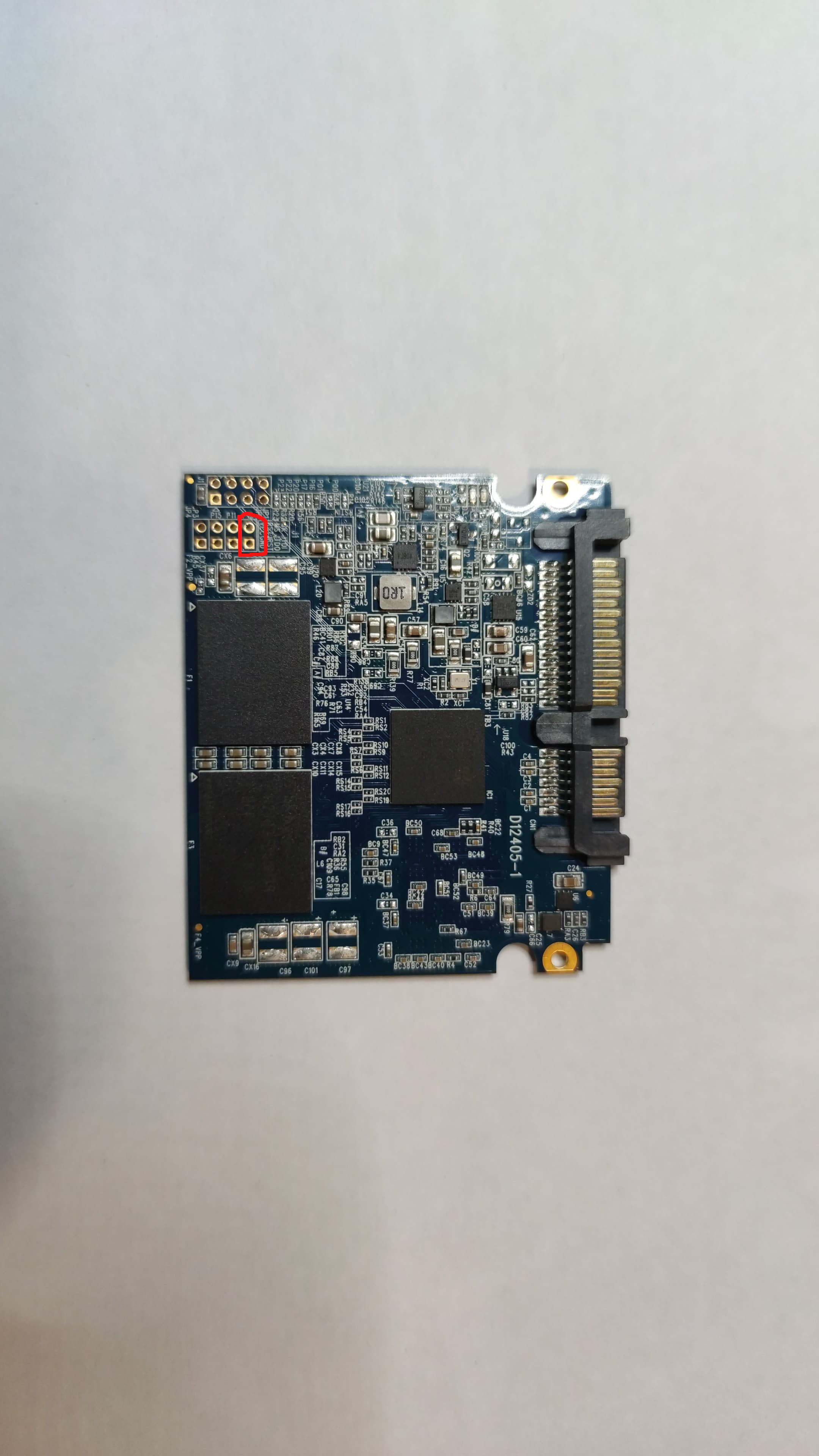

Recovering one right now, with a SM2258XT, but 512GB.
The safe mode pins are the ones marked.
Immagine WhatsApp 2024-02-10 ore 11.33.10_d3cc5c1a.jpg [ 487.9 KiB | Viewed 5615 times ]

Sorry for my mistake. I was confused by the silkscreening.
